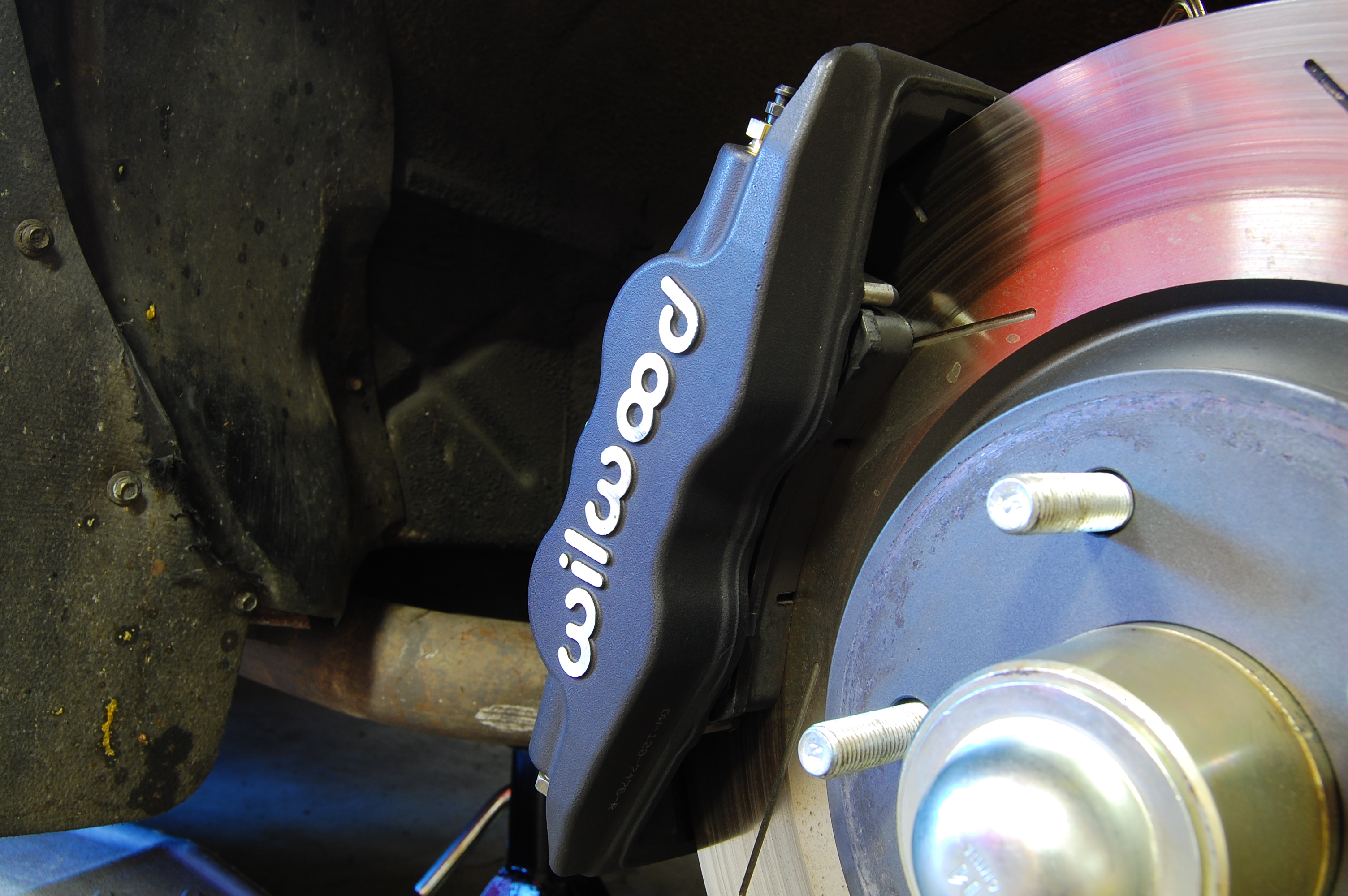

      Wilwood prints part numbers on the calipers. Find the part numbers and post them up. For location, you can see where the number is printed on my FSL's. See bottom inside face of caliper.
      Right click - view image for larger version.
