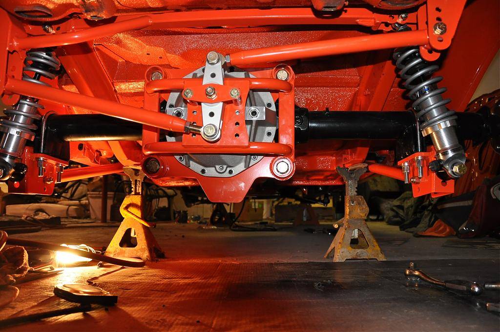

      We have a Torque Arm rear suspension with a adjustable Watt's link, here is a kit that a Customer powercoated Hugger Orange to match his car:

      I'm pretty sure you can get or make some clamp-on mounts for the axle side if you put the pivot on the frame as in the fays2 design posted above. You wouldn't have to recoat the axle in that case.
      Is this your rearend? If so, it looks like your coilovers are going to be tough to work around.

      Yes that's it. The car is a Pro Street car not Pro Touring. This site has given me some great advice and ideas during my build. The suspension was originally build with a diag link for the ladder bars. But I recently started looking for a more stable option. I started to install a wishbone when I became curious about a watts link. The one I have found bolts to the front of the pinion mount. So it won't have any issues with the coils like the Fays2 or the BMR setup would have. I may end up sticking with the wishbone setup. But I'm not in a rush just yet.
