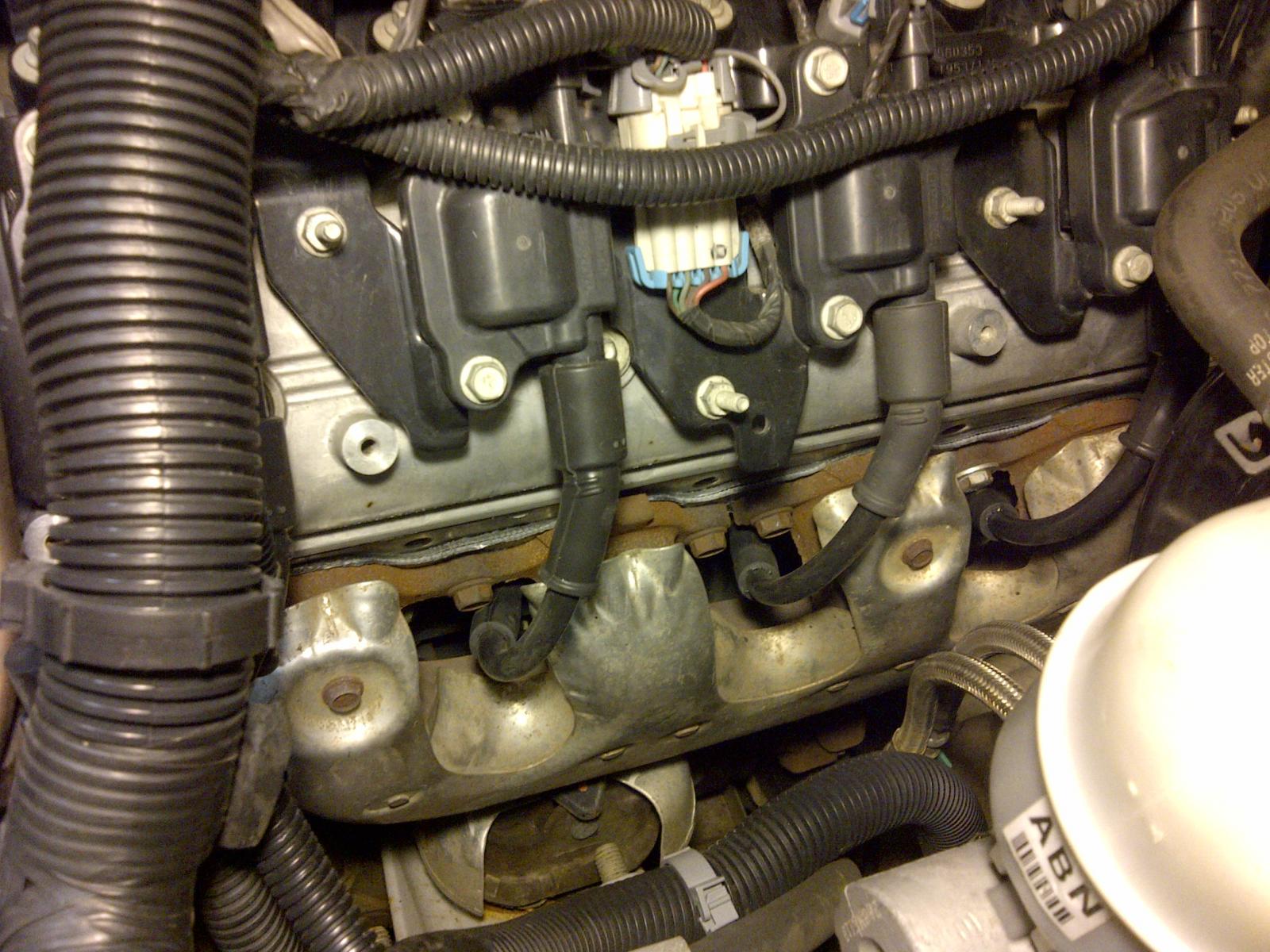

      I didn't relocate my coils, but on my TBSS I built a set of wires using some leftover Taylor 10.4 cable and Taylor boot/terminals. They turned out awesome and cost me about $30 for the boots/terminals and 2 hours of my time. MSD sells bulk wire so you can measure up how much you need, order the wire, and get the Taylor boots/terms for under $100.
Size:  266.3 KBName:  IMG-20120916-00459.jpg

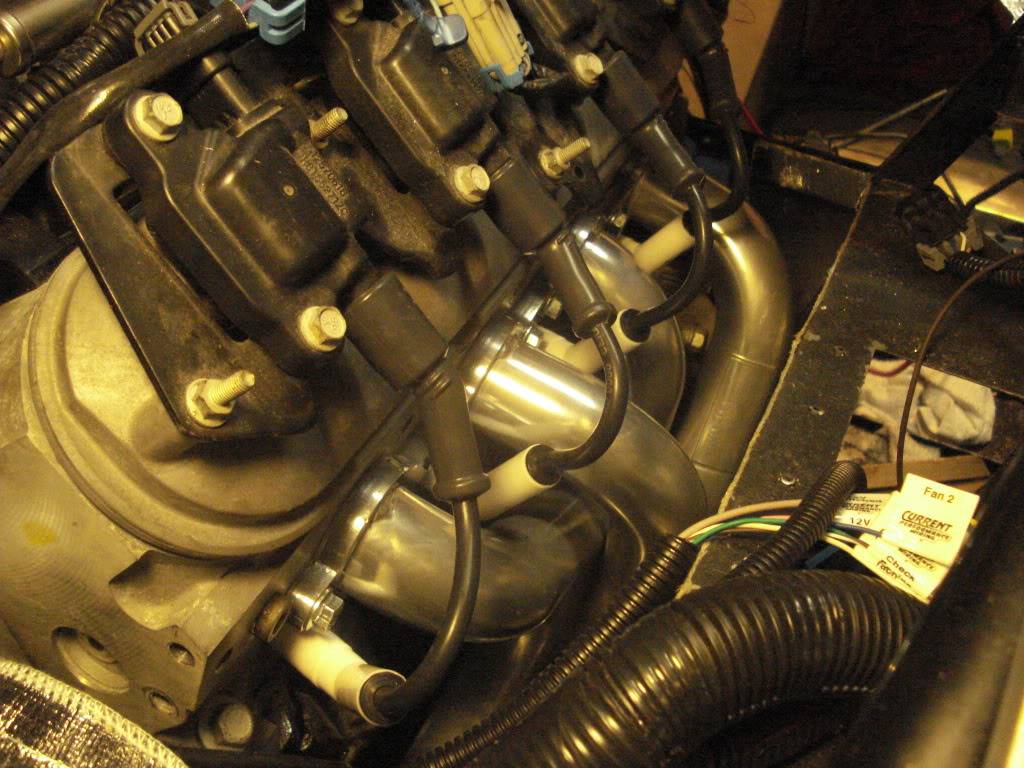

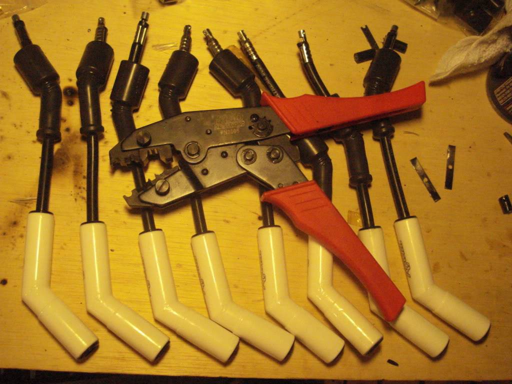

      Florida
      2,391
      I made a set for an LS 2 using a universal kit from Accel with ceramic plug boots because the regular wires and custom fit kits wouldn't work with the Kooks headers on a Factory Five GTM. The plug wires come long enough to reach a frame rail. The ceramic boots prevent burning wires on headers.
