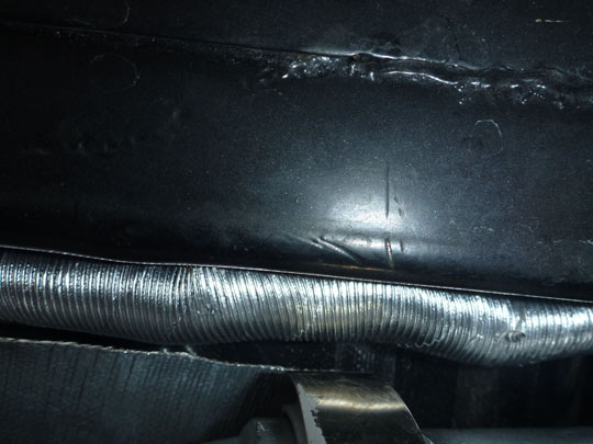

      I've got a hesitation upon throttle...light or heavy...that seems to only be apparent when the engine compartment get nice and warmed up. Meaning that when the engine warms up but it cool outside it's much less apparent.I notice it most when it's warm outside and I idle for a long stop light. I ran my hard fuel lines on the inside of frame rail and up front the header collector is about 1.5 " away . I put some thermacool heat reflectant over the lines but doesn't seem to make much difference. The $64K question is whether I'm still heating up and thus causing bubbling or just still have a tuning issue. Fueling tables have been tweaked to keep this motor running pretty rich already( seems to run best there but may be just covering something up in my opinion)...12.5-13.5 AFR at cruise and accel...and trying to sort this out. My infrared gun shows fuel rail temp when occurring about 150-165 ish. Temps taken at fitting in engine bay down by header show 185ish. Is that temp at 58lbs pressure still enough to boil fuel? I've researched lots and not found a straight answer as to when gasoline boils. I know the different compounds that make up gasoline do it at different temps....but...sooooo..again...how hot is too hot in the lines to give symptoms? Basically, I am trying to decide whether to reroute line up front outside frame rail or just keep tuning.
      I'm all ears.
      Thanks
Size:  69.2 KBName:  line1.jpg

      Clamp a temporary heat shield in place between the header and the fuel line. Allow an air gap on both sides but keep it a bit closer to the header if needed.

      Ok, I rigged up some to heat shields and we'll see if it makes any difference. I'll post up when I try it out...I hate it when I follow a post just to get to the end with no result.

      The heat shields reduced fuel rail temps but still have a stumble to tune out. Moving on...thanks guys

      Looking at the pics I want to say I would move the lines quite a but further away. I would probably want 4-6" clearance just to be safe. Overkill? Maybe, but it will make it a non issue. I would run the line higher on the firewall and then to the out side of the frame rail with a debris guard.

      Denvervet, I have had the same problem here in Denver. You should move the line out as far away from the engine, header as possible. I ran mine up over the outer fender. then down and to the front of the engine. Ethanol gas boils at around 100F so not very hot. Are you having problems with the vaporworx tank? Mine is in paint all summer so I was not able to run the new tank much yet.
