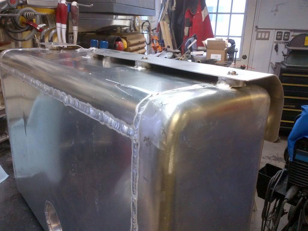

      I built my own using 10 ga 6061 Al with formed end tanks...it's plenty light and with the baffles, I can stand on it! I did, however, install a rock shield.
      It'll be coated with bedliner prior to installation.
      Ontario, Canada
      2,314
      Where did you find the tank ends?
