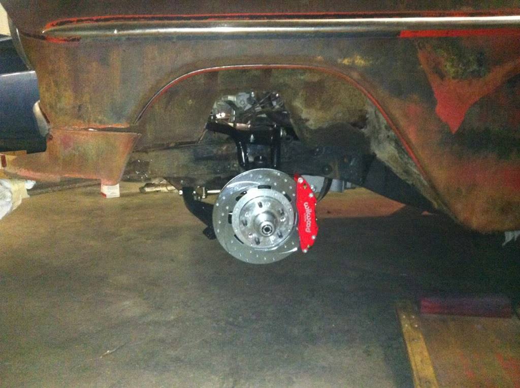

      They are Wilwood 6 pistons on front and back. Dynapro kit 12.15" front and back w the 6 piston upgrade.
      Rear is a 9" narrowed to 57-1/4" (outside to outside)

      We run an 18x7 (225/50/18) with 4.5 backspace on a negative offset brake kit. That seems to be the widest you can go when you are tucking rim into the fender at ride height. You will need more backspacing since your brake kit most likely pushes the track width out a bit. If you are going to be at close to stock height when you drive the car and only air it down when you are parked then you should be able to fit the 245 tire on an 8" rim
