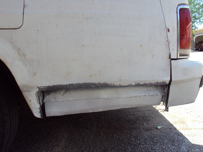

      Couple of the only real rust on it and its repair.

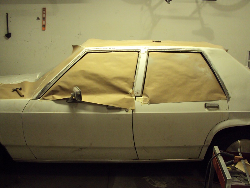

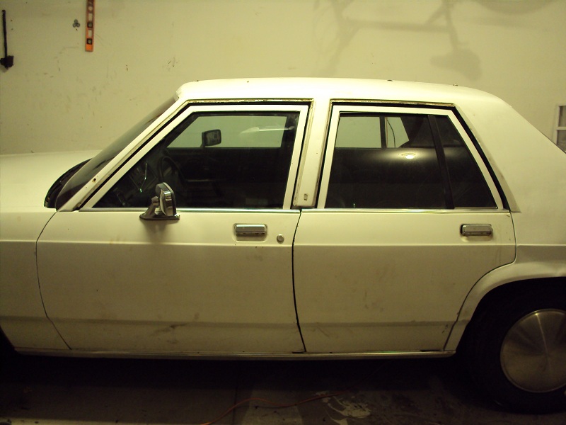

      And a progression of the door chrome shave

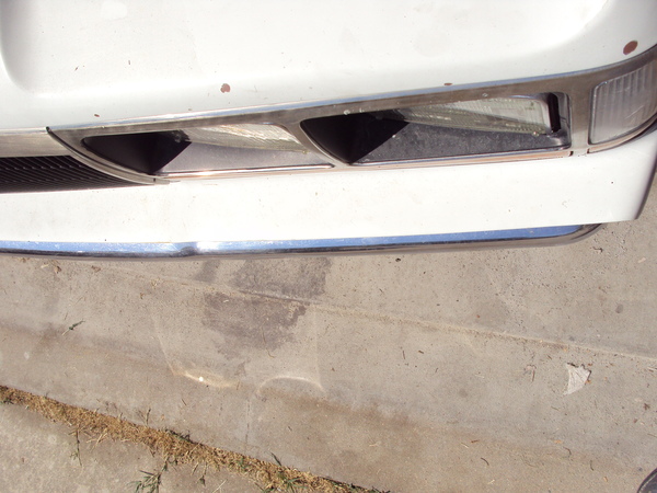

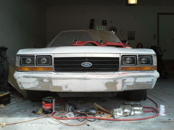

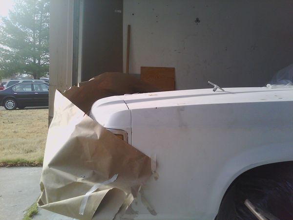

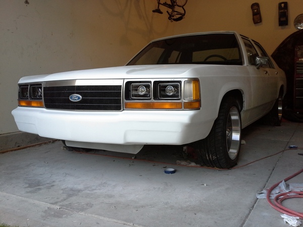

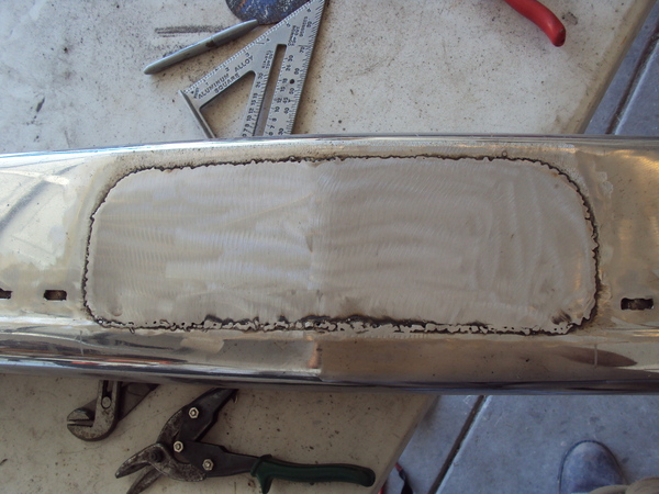

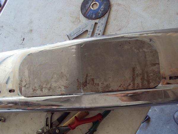

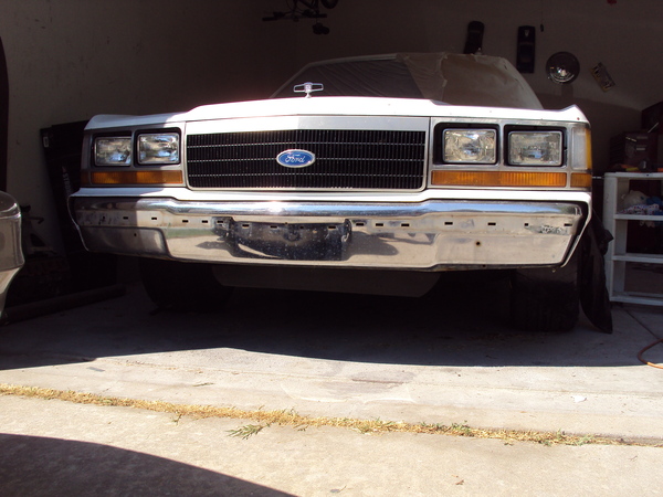

      Been awhile since I have been on here and updated this thread so here goes. The 408 didn’t work out this year, so…. I have been putting a couple hours here and there in on the car, but between, school, family and life, it’s been awhile since I accomplished anything. I did finish tucking the front bumper, and while at it shaving the antenna, and hood ornament. I cut the impact absorbers and moved the bumper in about 3”. Then I filled the trim holes and filled were the tag goes. After that I molded the plastic cover into it with fiberglass. I intend this winter pull fiberglass molds, and build the assembly out of fiberglass and save +-50lbs off of each end of the car. Now on to the rear bumper.
Size:  129.3 KBName:  1.jpg
Size:  131.7 KBName:  2.jpg
Size:  115.7 KBName:  3.jpg
Size:  155.4 KBName:  4.jpg
Size:  157.4 KBName:  5.jpg
Size:  139.0 KBName:  6.jpg
Size:  201.1 KBName:  7.jpg
Size:  84.6 KBName:  9.jpg
Size:  25.9 KBName:  10.jpg
Size:  42.7 KBName:  11.jpg
Size:  87.8 KBName:  12.jpg
Size:  62.7 KBNo more antennaName:  13.jpg
Size:  27.3 KB Hood ornament gone

      That really makes the car look a lot cooler. Splitter next?
      Stephen
      Wichita, Kansas
      29
      After I lower it, I planned on putting a functional splitter on it. I think it will look tough as nails, with a simple splitter on it.
      Combustion of all types are a mechanical symphony, but it is the primeordial roar of an v8 the stirs a mans savage soul.
      san diego
      5,101
      Wichita, Kansas
      29
      Thanks man. I have read up on your falcon, and it’s an impressive build, and one of my favorites. I was settled on painting it satin black. But after seeing it in white primer, the contrast against the black grill and headlights, has me seriously reconsidering. I am actually kinda shocked how cool it looks white.
