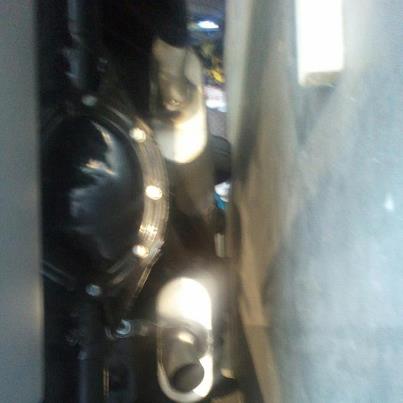

      Thinking of purchasing a 69 camaro from a guy in Cali who had it built by a shop that is out of business and he knows very little about it. He sent this photo of the diff and says it is a Limited Slip with 3.23 gears. It LOOKS like it has less than 10 bolts.. I know the photo is blurry but I was hoping one of you guys would recognize what this is.

      need more info/better picture. cound be a 8.2/8.5 . a 8.5 has two little ears on the bottom of the housing where a 8.2 doesnt. have him send you a clear picture and we can get it figured out.

      Crap I think I can see the diagonal lines on the original pic and no tabs. Must be the 8.2.....

      Could be 7.5" ???? Roger
