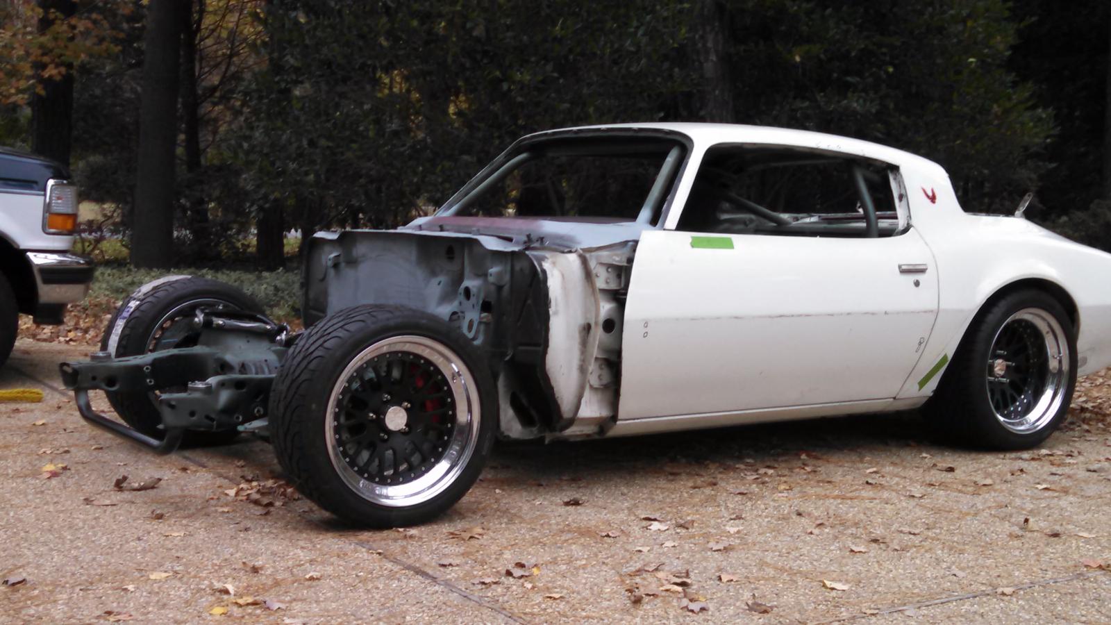

      Here is a few weeks before transporting to its tomb, I mean storage.

      I don't have any readily available, but next time I'm at the storage locker I will try and get some shots for you. I don't have steering linkage or tie-rods etc. mounted, but it may still give you a good idea, ill try and get some different angles. I'll go through my photos and see if I have anything somewhat close in the meantime.
    8. #48
      Jan 2012
      Virginia
      237
      Maybe these will help some??? (ignore the tiny Vette LS1 in the subframe on the second pic )

      Well... mine I believe were 5.75" backspacing, I know you said yours were 6.5", but I swear mine look much tighter to the spindle than yours. That being said, I can't tell if that's an illusion since obviously my springs have no weight on them... or we have different spindles... or maybe one of our rim manufacturers hosed up the backspacing (I never actually checked mine now that I think about it). Maybe someone else has some thoughts or see something I'm not. The biggest backspace I've heard of is 5.75" on the front, but you may be fine with the 6.5" as it very dependent on your combination, especially when a stack-up of aftermarket parts are thrown at it. I think the best thing you could do for yourself is to mock all your suspension up, set the car down, and then then turn the wheel lock to lock and see if there are any interferences. Also keep in mind that as the suspension articulates there is a vertical component that when the spring is compressed, wheel locked, you may drive the tire edge into the radius/curved section of the wheel well. When I get all mine back together I can let you know how it went on my end, but I think that may be quite some time away LOL.
      EDIT: In that first pic, is that wheel sitting on the ground or bolted to the studs. I guess I assumed it was bolted up... if not then maybe that's why I'm seeing what I'm seeing.

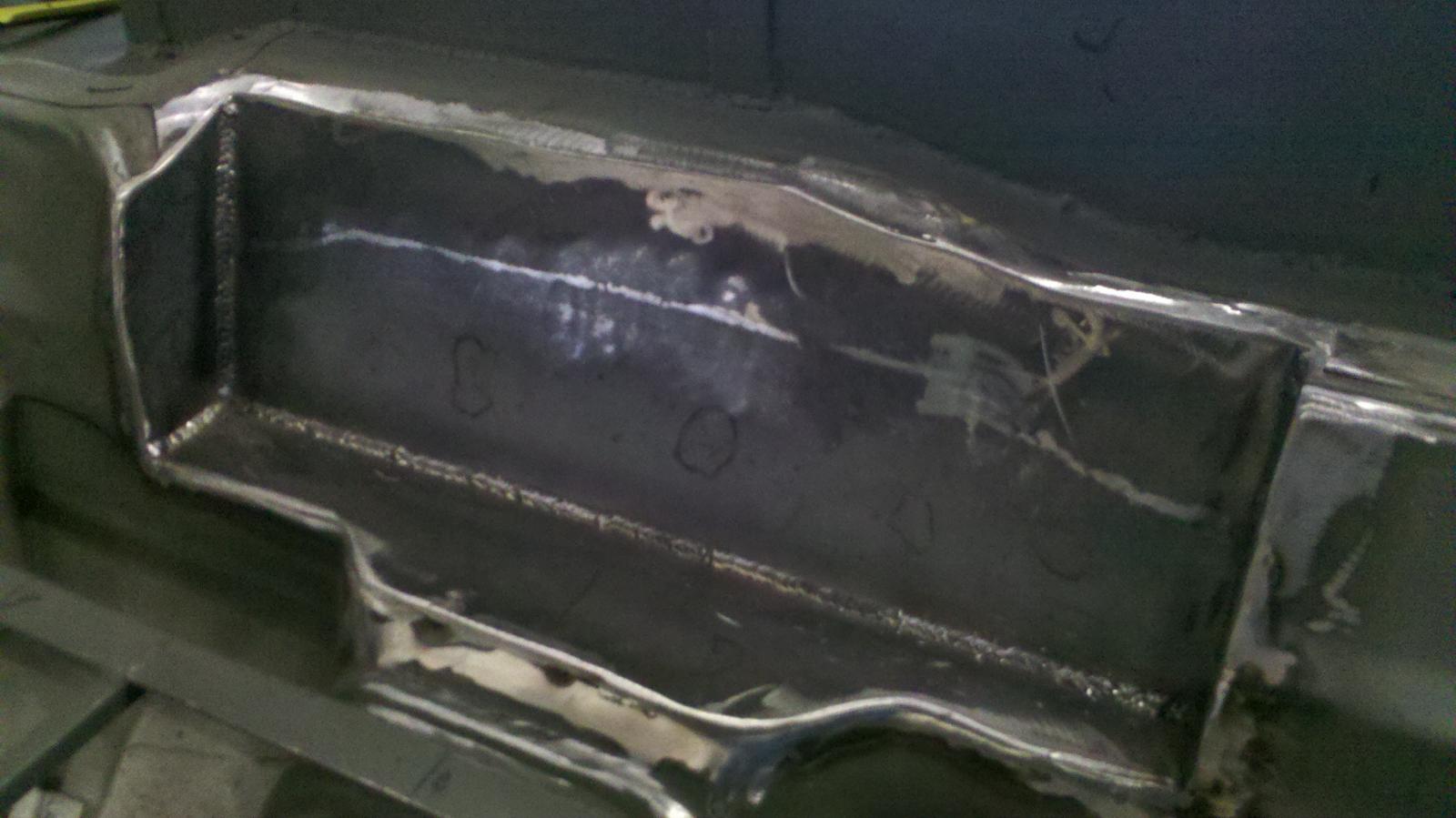

      Had some free time, decided to upload some of the previous progress. Here is the rear seat delete for panels, two trays (not shown) and the recess for the nitrous bottles.

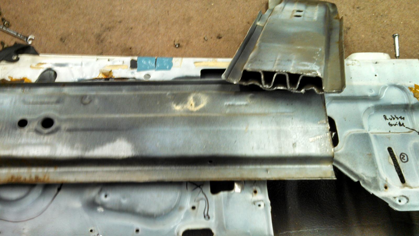

      Drilling, cutting, removing, and re-welding holes for factory door bars (safety replaced by cage door bars.
