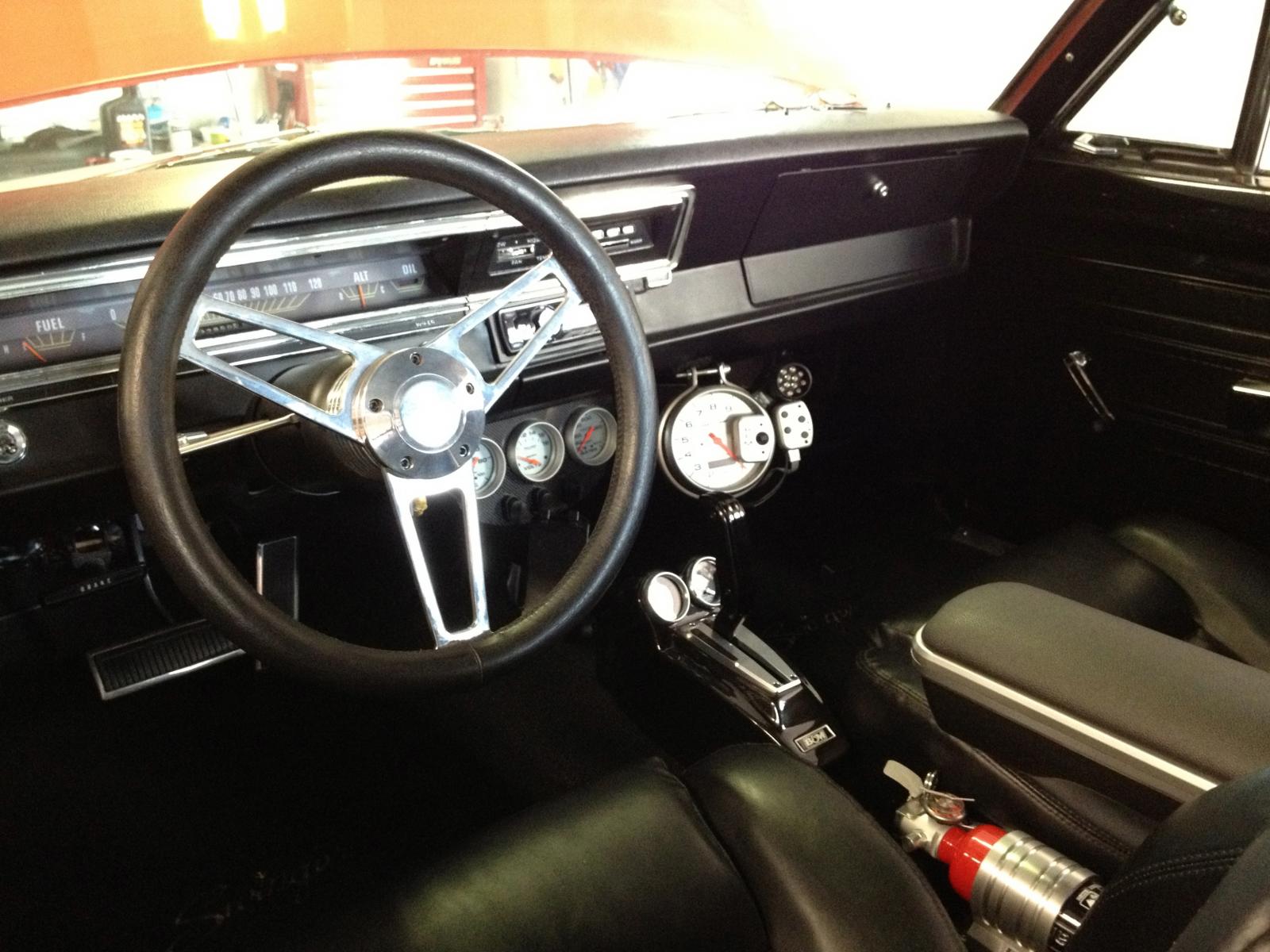

Size:  228.4 KBThanks guys
      As far as mods go there are quite a few.
      Numbers matching motor and trans
      Hotchkis TVS
      Here is my engine build.
      Balanced and blueprinted 340 .030 over
      stock steel crank
      eagle SIR Rods
      Spreedpro forged aluminum 10.0 to 1 pistons
      Crane Mechanical Special Cam 560 lift 248/258 duration
      Crane gold roller rockers
      Melling hi flow oil pump
      Edelbrock air gap intake (port matched)
      Edelbrock aluminum heads with 3 angle valve job
      msd box and coil
      Demon 650 carb
      Lokar linkage, Hurst lineloc, updated new master cylinder (manual brakes and steering)
      Mopar frame connectors
      March Pulleys
      Custom built aluminum radiator
      TTi headers and full exhaust with H pipe and their exhaust tips
      The car has a 4.10 sure grip with 275/35/18 TR1 tires rear 245/35/18 fronts (soon to be a 3.54)
      US cart tool drive shaft loop and adjustable pinion snubber
      Bilstein shocks
      ididit tilt column and B&M carbon fiber shifter
      Scat bucket seats with Morris seat belts
      Hidden NOS system (have not hooked it up to try yet)
      New tank with fuel pump in tank with regulator
      Way to much to remember.
      Here are few more pictures
