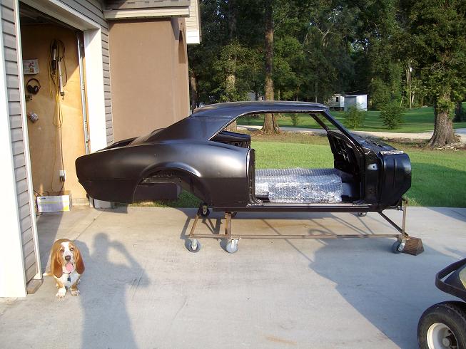

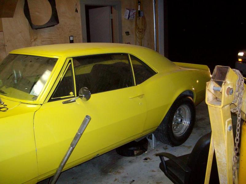

      The quick and dirty timeline.

      Dip and Ecoat.

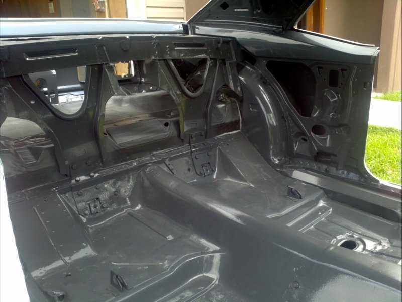

      Raptor liner and seam seal.
Size:  173.5 KBName:  2011-03-12_12-46-57_675.jpg

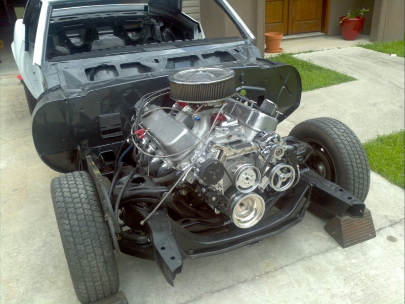

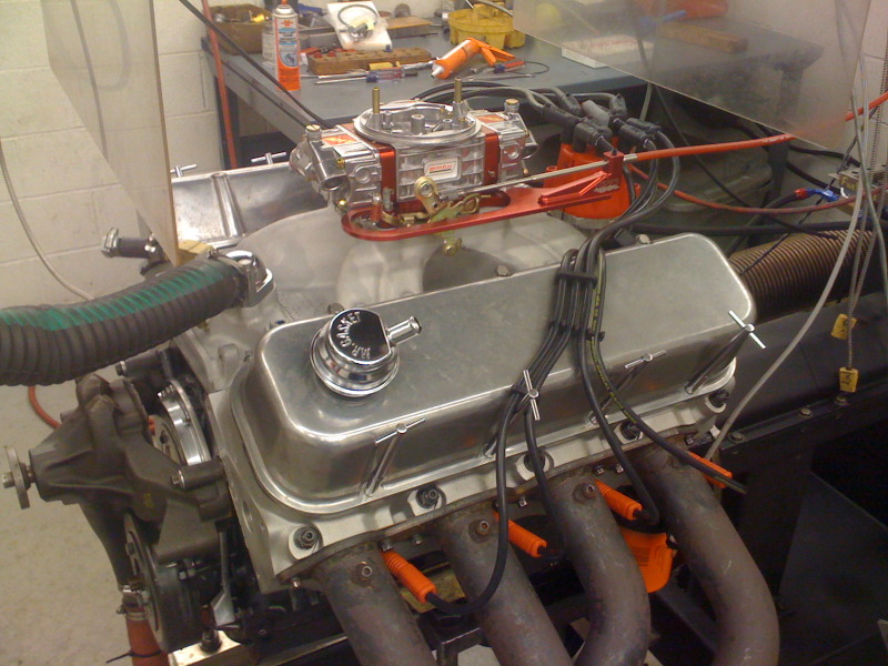

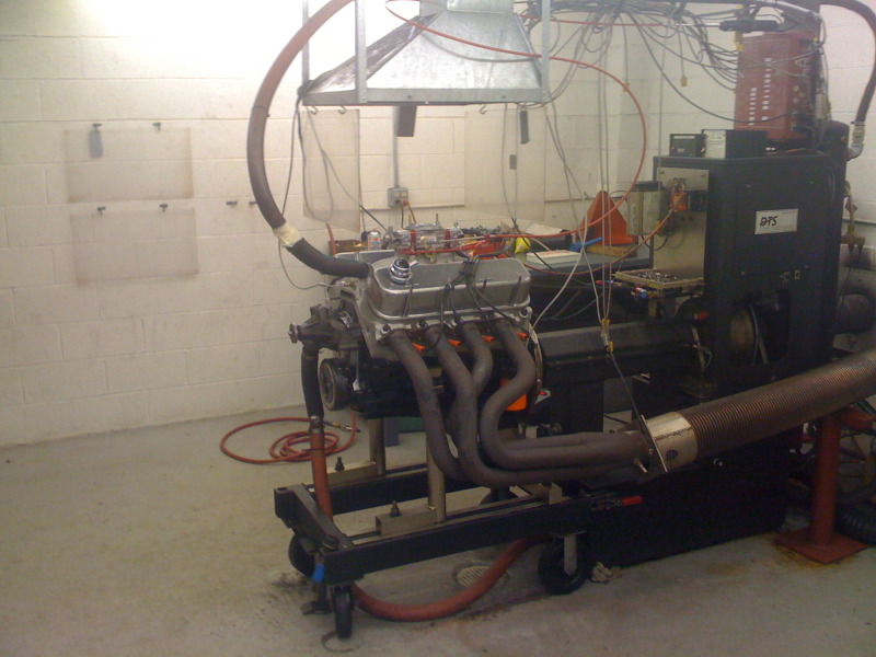

      Engine Rebuild
Size:  162.3 KBName:  IMG_0016.jpg

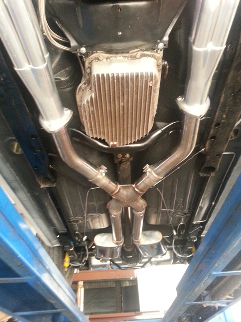

      Progress!
Size:  130.6 KBName:  exhaust.jpg

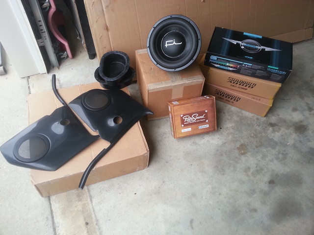

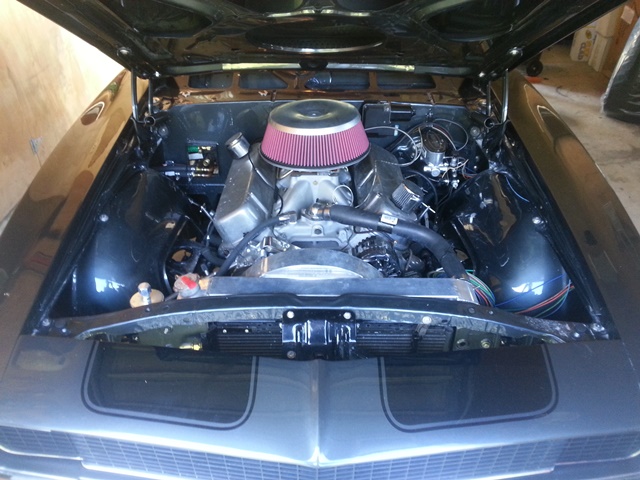

      The interior is installed. Console and gauges are back to original (except the ammeter). I decided to add some stereo equipment also. Picked up a Retrosound model 2, Image Dynamic components, Sundown amps, Fi Q 12" subwoofer, and Screamin' Performance kick panels.

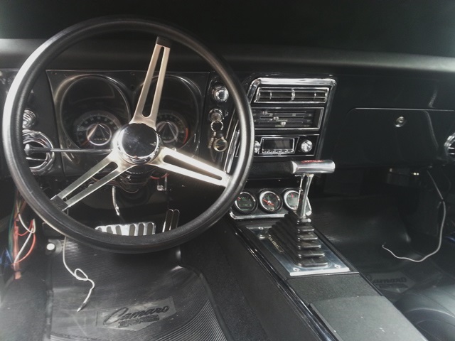

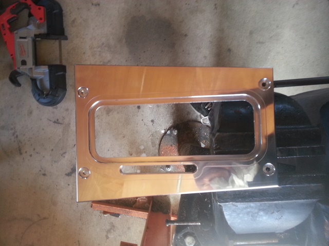

      B&M megashifter installed into a stock console and I managed to make it look sort-of stock!!

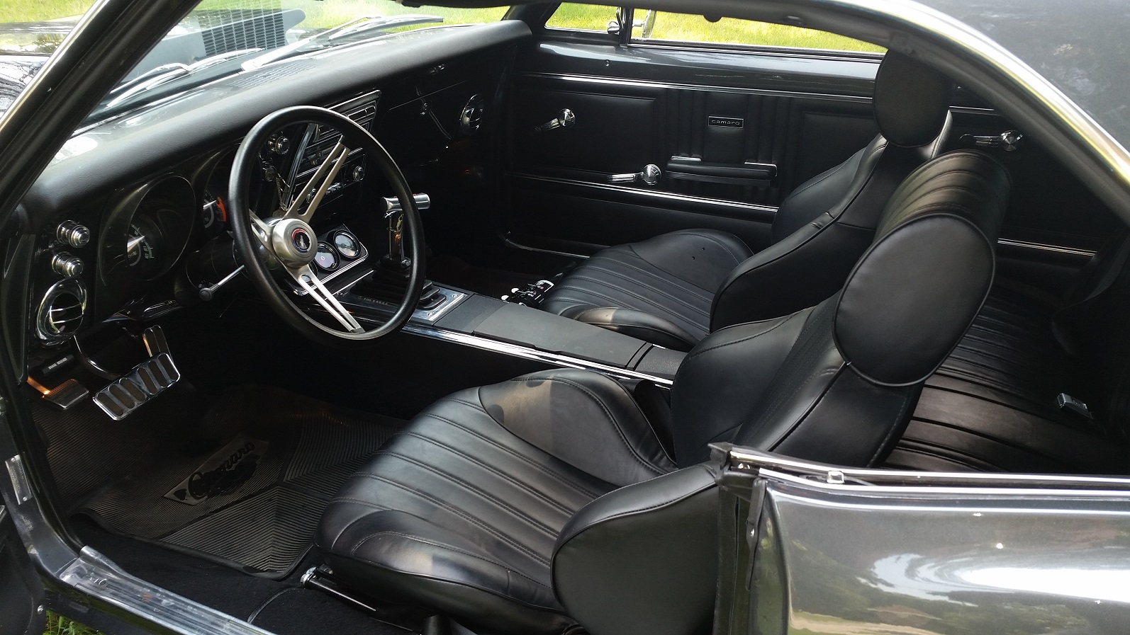

      Really like the new look. I am also working on a 67 camaro and was wondering what seats you used they look comfortable.
      Jan 2010
      Louisiana
      81
      Thanks for the compliments!
      Quote Originally Posted by Rich G View Post
      Procar Rally 1000 seats and a matching rear seat cover.

      How do you like those seats? Do they look like they're going to hold up well? Are they comfortable to sit in? They look great, as does the rest of the car!
      Dan
      A.K.A: That bald guy
      Find me on Facebook or my personal website.
      - 67 Camaro: Current Project Car
      Jan 2010
      Louisiana
      81
      Quote Originally Posted by 67SSDan View Post
      Dan
      I find they are a significant improvement over the stock seats. Biggest improvement, they recline. Second, the large bolsters keep you "tucked" in the seat. They feel more sporty and attached to the car, versus sitting on a mini-bench seat. The trade off is it can be uncomfortable to sit sideways in the seat when your working on the car. They do look well constructed with quality vinyl covers. I'm confident they'll last a long time.
      One shortfalls I see,
      The slider rails are functional, but underwhelming. They are not precision cut pieces and don't slide very easy. I suspect they will wear in and slide easier over time.

      I'm interested in what model Megashifter you used and how much modification it took to fit in the stock console? I'm looking for a floor shifter to use as the stock one is not going to work, and plus i wasn't fond of the look anyway.
      Quote Originally Posted by juggernaut View Post
Size:  133.7 KBName:  shifterplate.jpg
Size:  94.0 KBName:  interior.jpg
      Feb 2012
      SW, Michigan
      875
      I like the color choice.. Looks good!!
      Jan 2010
      Louisiana
      81
      Quote Originally Posted by Nativefx View Post
      Sorry, haven't checked in for a while
      I used the 80690 Megashifter.
      I had to sink it into the transmission tunnel 1" because the body (ratcheting mechanism) of the shifter is too tall to fit under the console. I also had to trim off the "ears" on the shifer body, where the stock B&M chrome plate mounted.
      The aluminum plate was done on a cnc mill. I used the B&M plate as a template for the boot hole.
      Let me know if you need more info.
