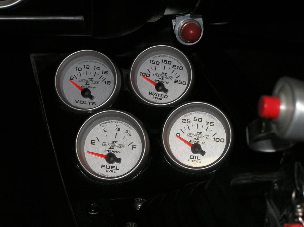

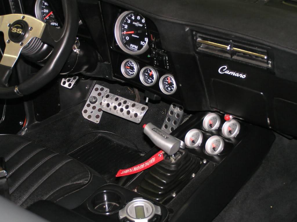

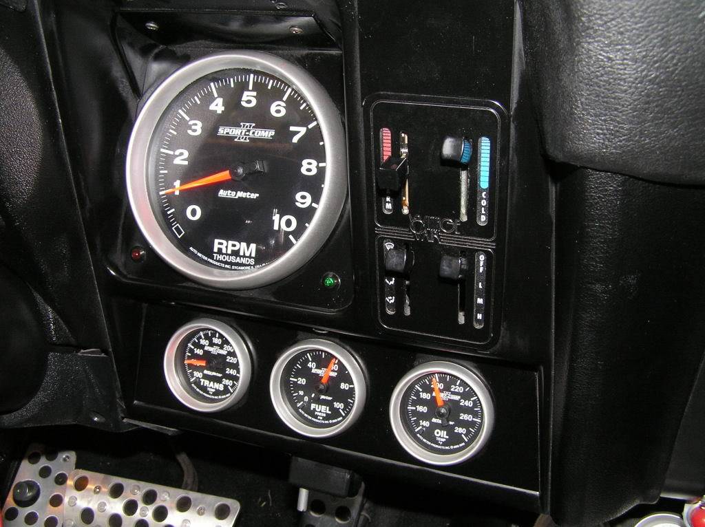

      Unfortunately I have nine gauges that I meticulously research and bought from Autometer. They were the closest to original appearance. And they all matched and had the functions that I was looking for. I spent over a thousand on these gauges and really like them.
