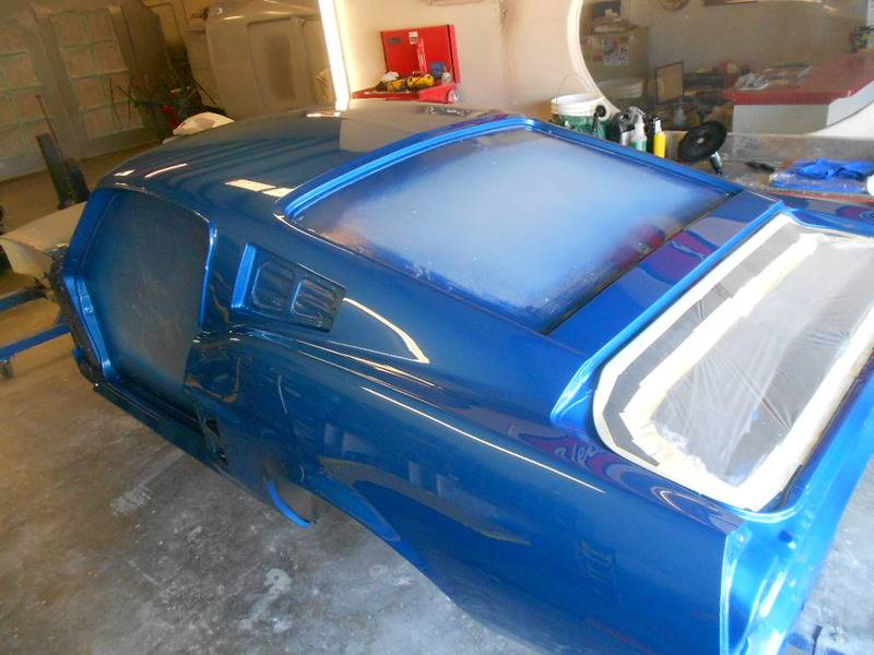

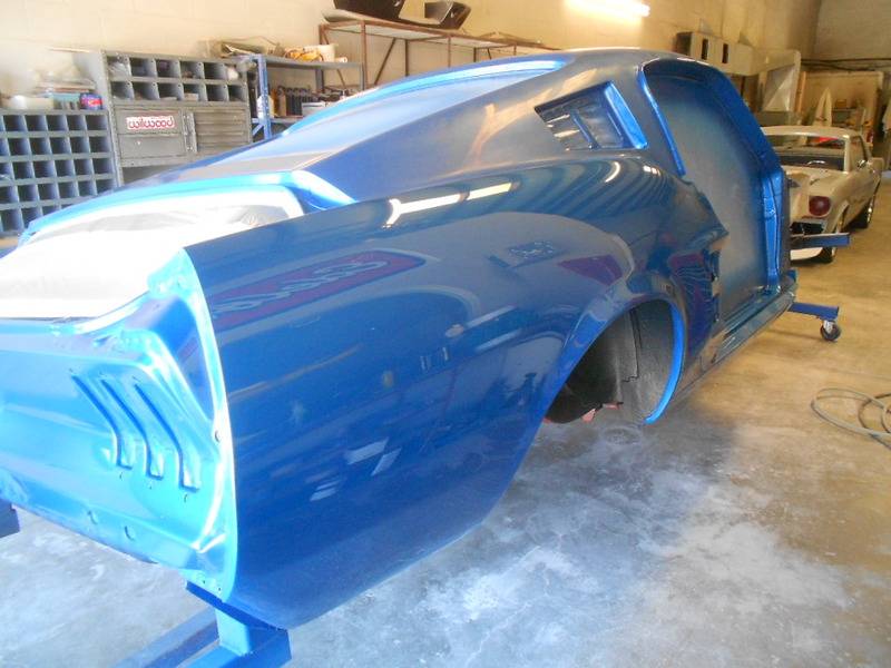

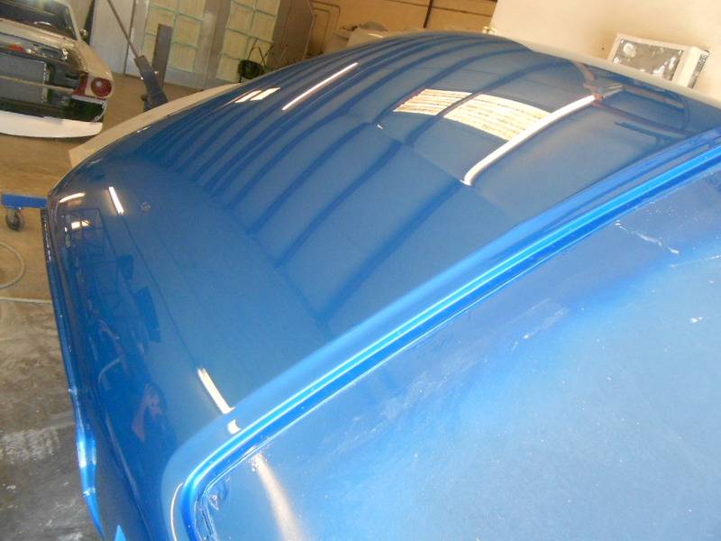

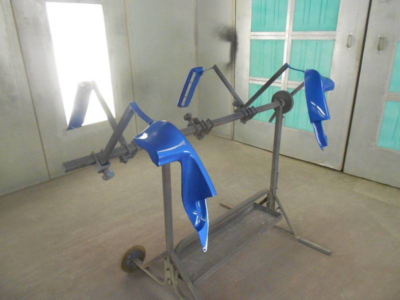

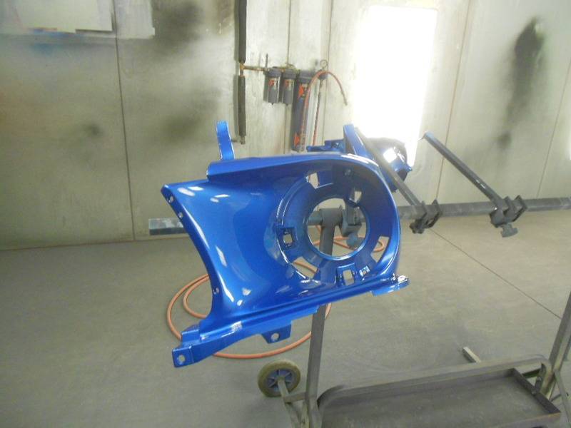

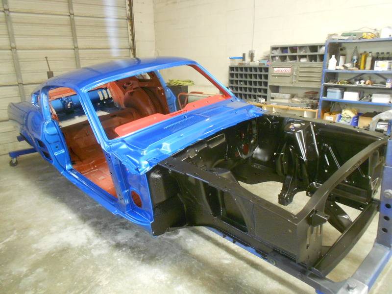

      Last week I finished spraying 3 coats of Pro-Spray Acapulco blue and 3 coats of SPI Universal clear. Brian wet sanded with 1000, 1500, 2000, 2500 and today started buffing

    3. #103
      5,560
      The paint looks slick Rusty. Nice job.

      That is some glassy paint! We like the idea of doing the underbody a bright color, too. You dont see many people doing that, and its bound to make the suspension pop.

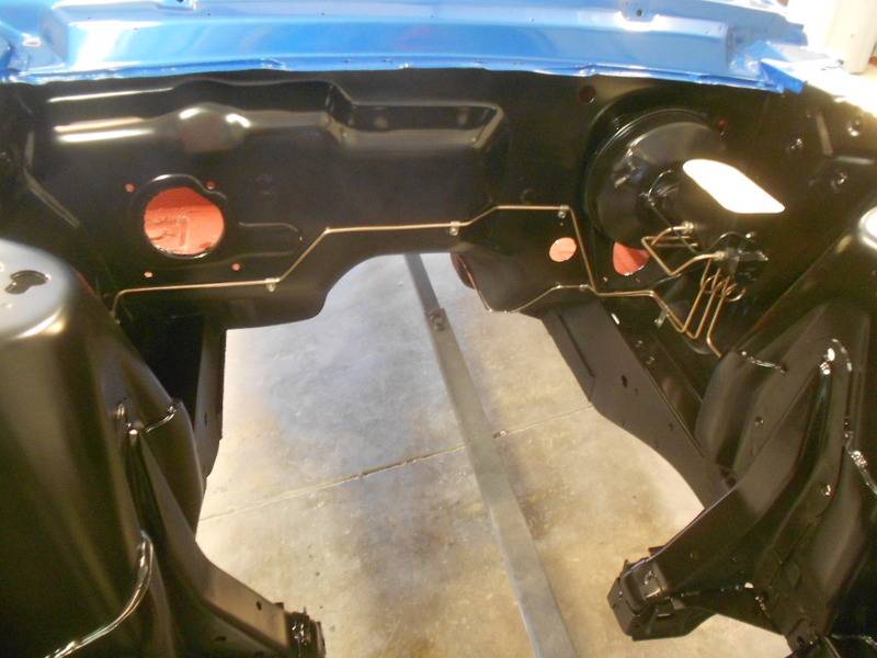

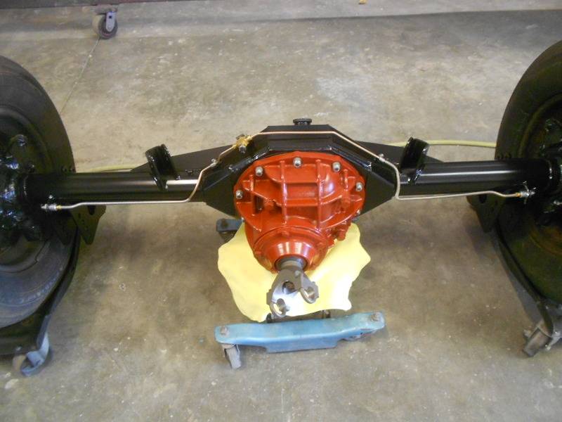

      Owner installed the brake and gas lines he made.

      640
      He did a very nice job with the lines! I hope the lines on my Volvo come out that nice.

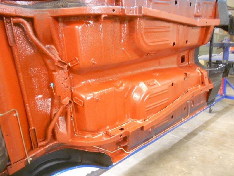

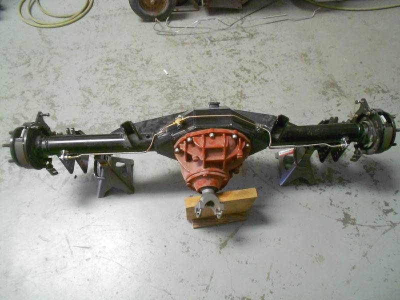

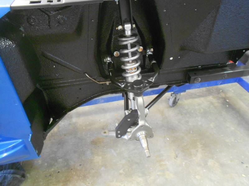

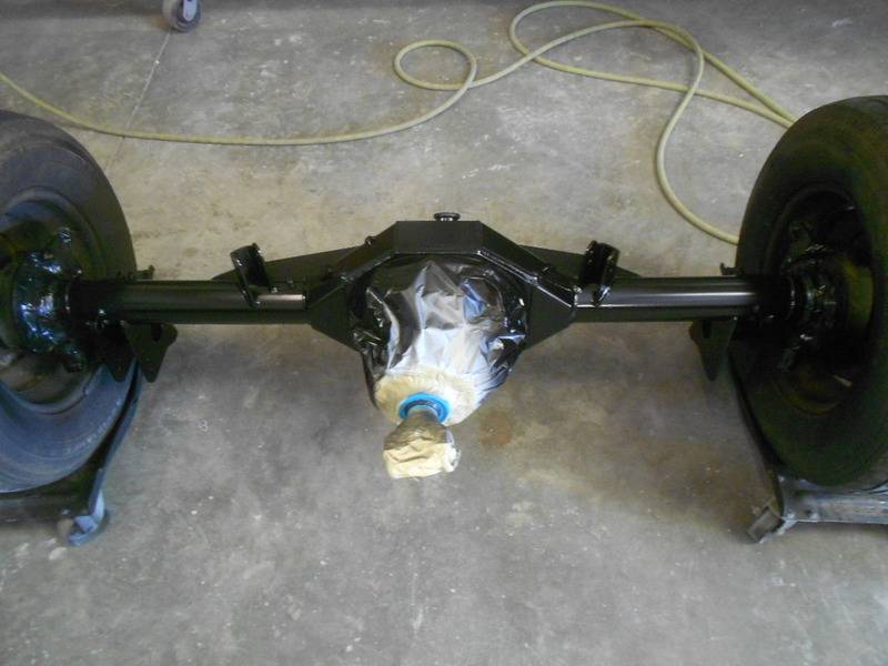

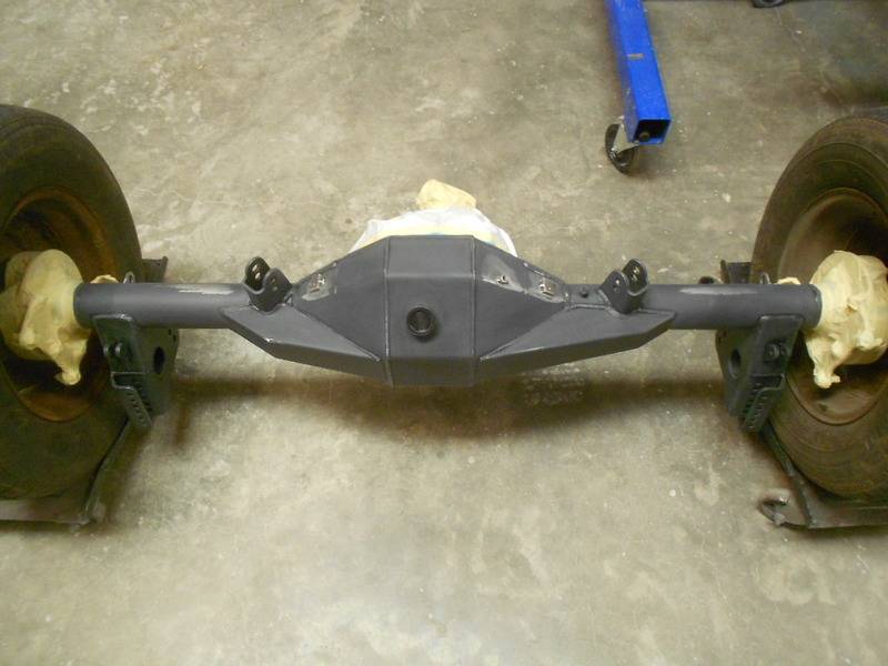

      Brian welded brake line brackets on the housing and the owner made the brake lines
      Housing sanded and epoxy primed

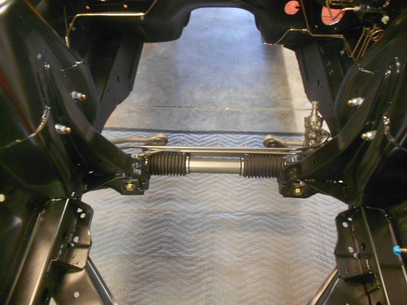

      TCP front suspension
      Rusty Gillis
      Former SS/FA & SS/GA NHRA National Record Holder

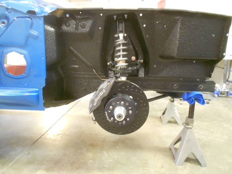

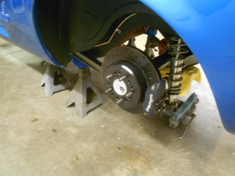

      Brake line installed on the rear end
      The owner wanted the TCP rack painted a cast color
      Wilwood brakes installed
      Rusty Gillis

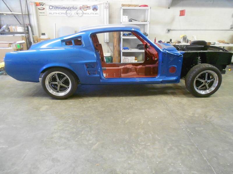

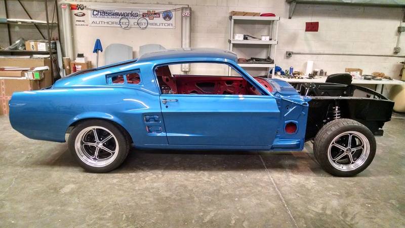

      Rear suspension installed
      On the ground

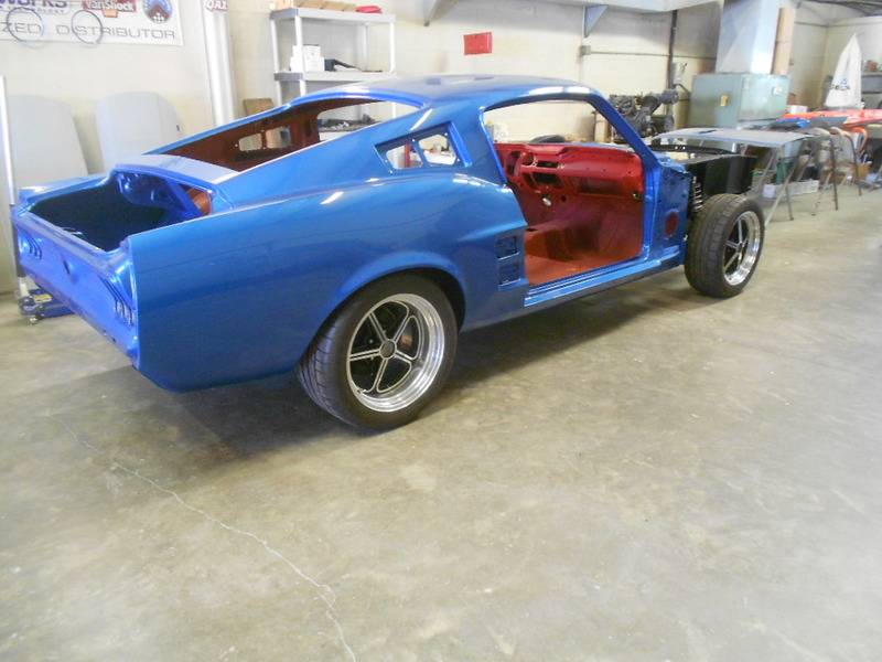

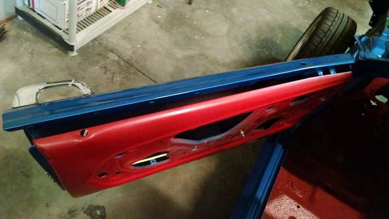

      Brian has the doors lined up.

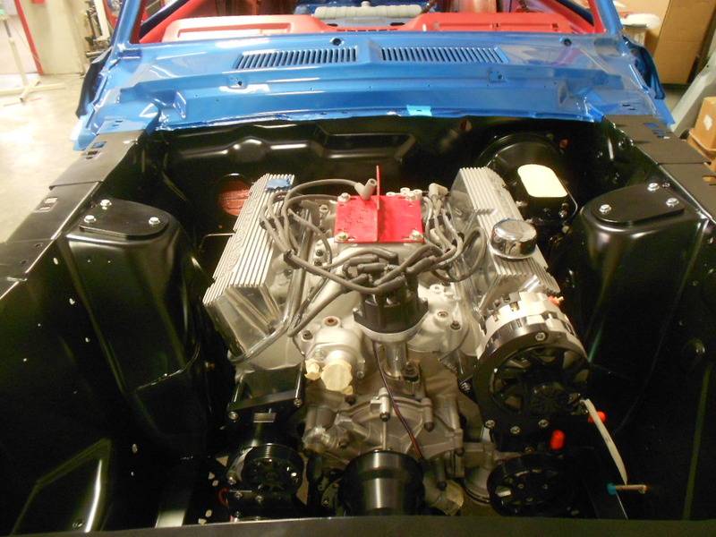

      I painted a few parts and we installed the engine and aod trans today.

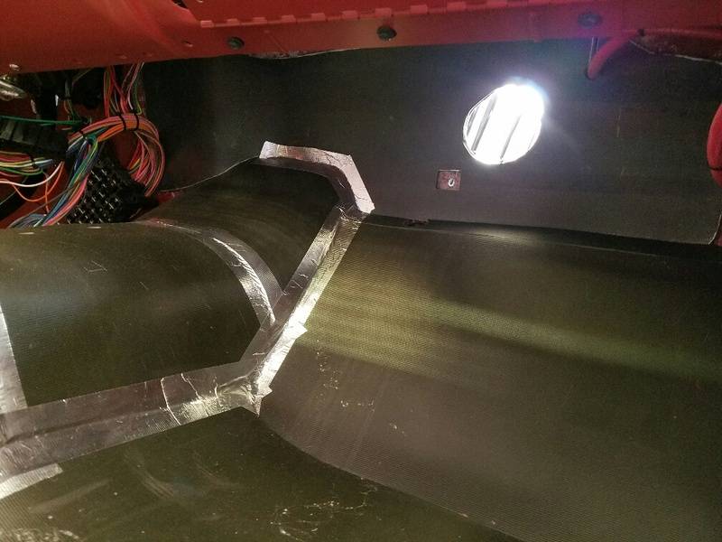

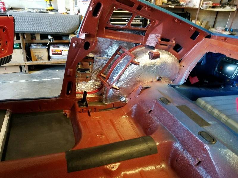

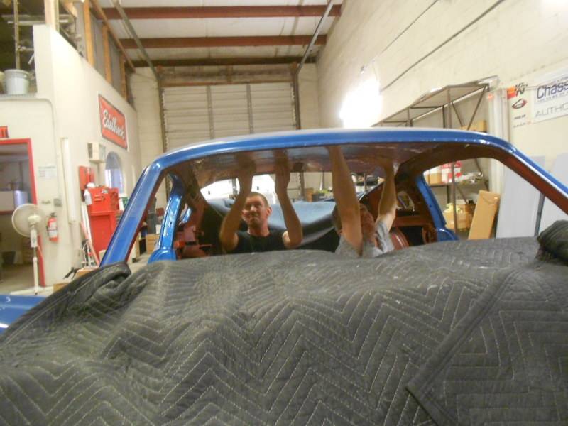

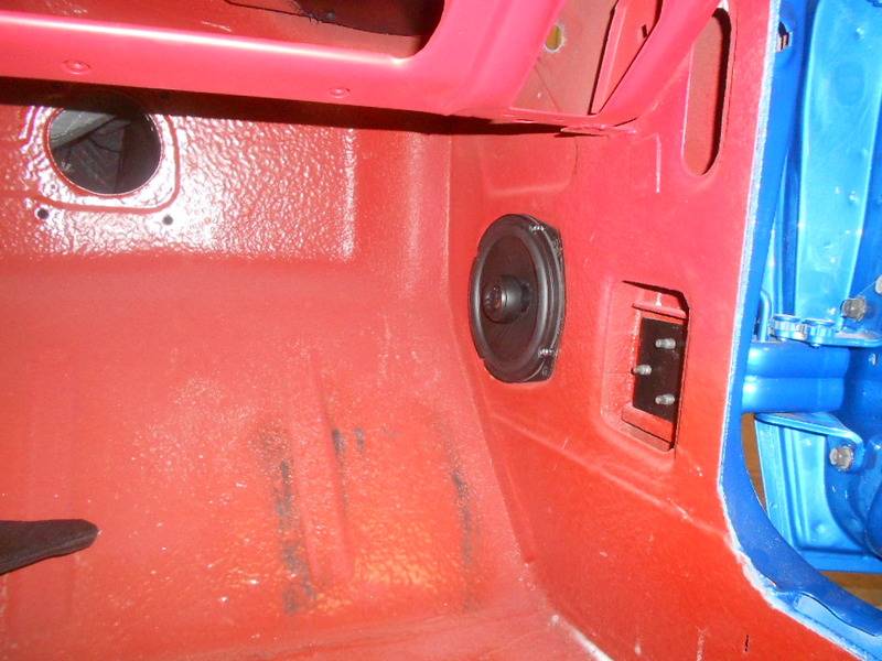

      The owner is off work for a few weeks and wants to do some of the assembly on his car. He and Brian installing the headliner insulation.
      They also installed the side speakers

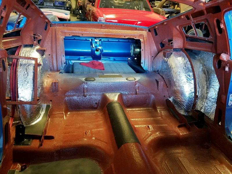

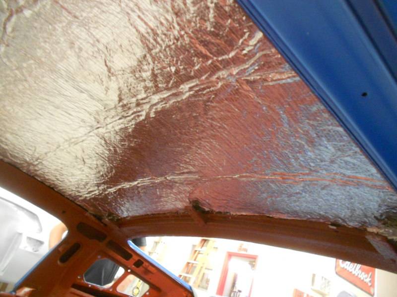

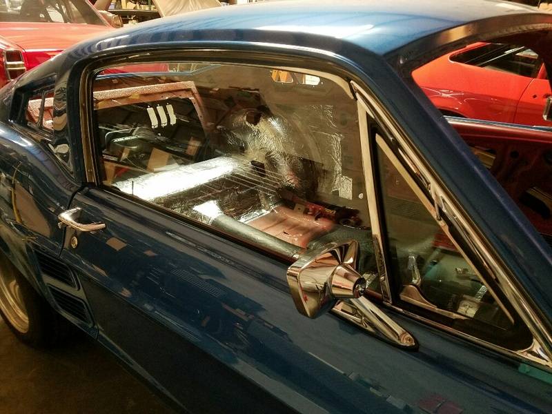

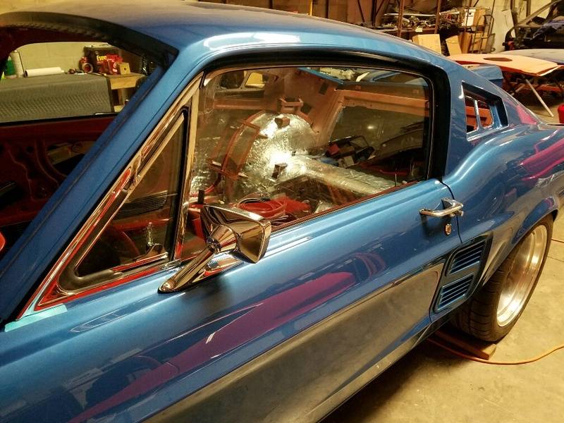

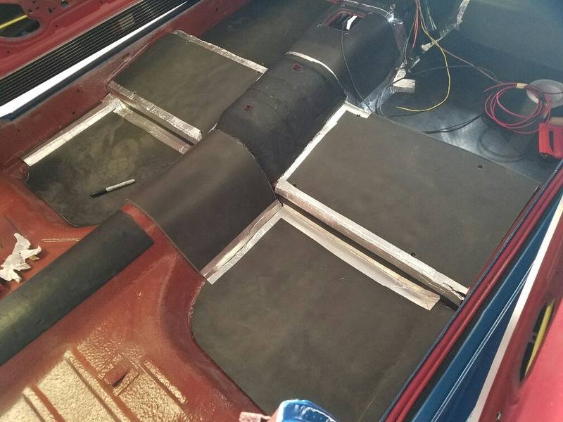

      I'm behind on the updates. Brian and the owner installed the insulation.
      Brian lined up the door glass and vent windows
