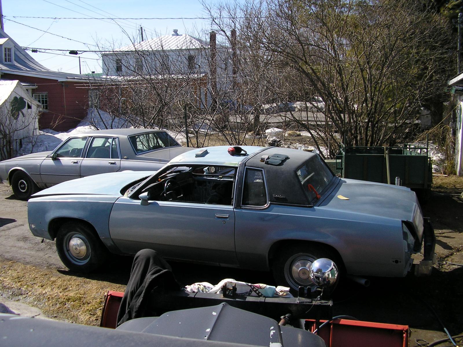

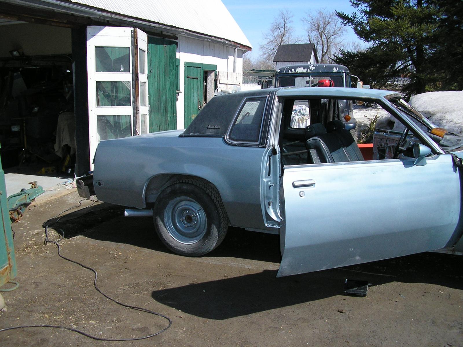

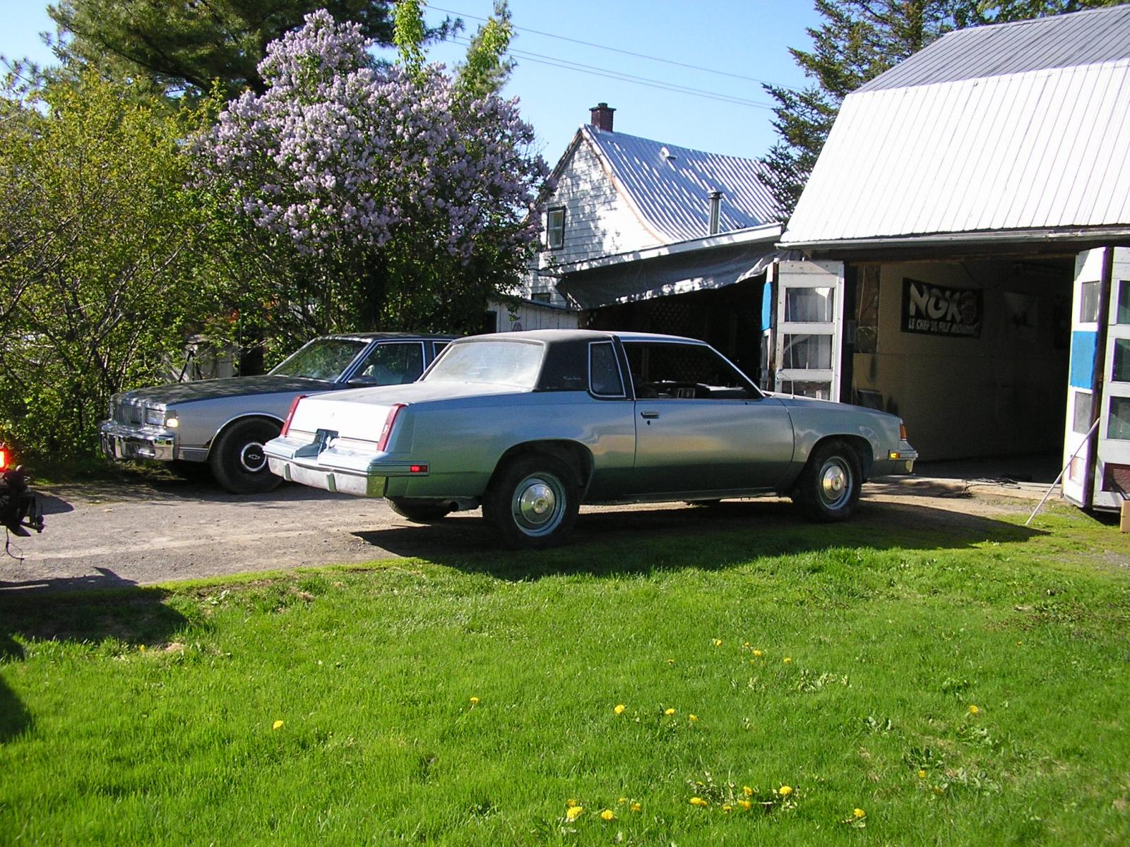

      this is my 1987 cutlass spreme 305 . i am from quebec canada and i am building this car for the lapping car sine in quebec . my friend drive hondas so this ting will give them son stresse on the track Name:  olds 1.jpg

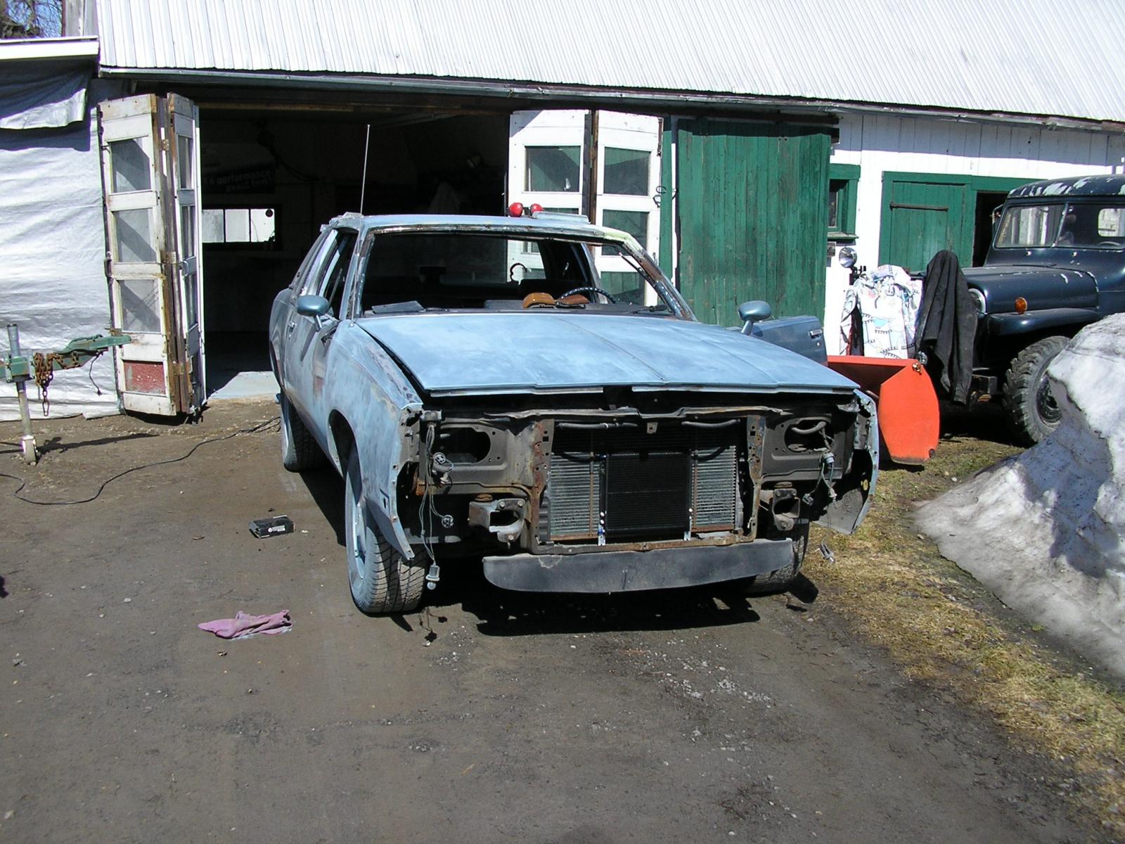

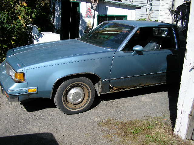

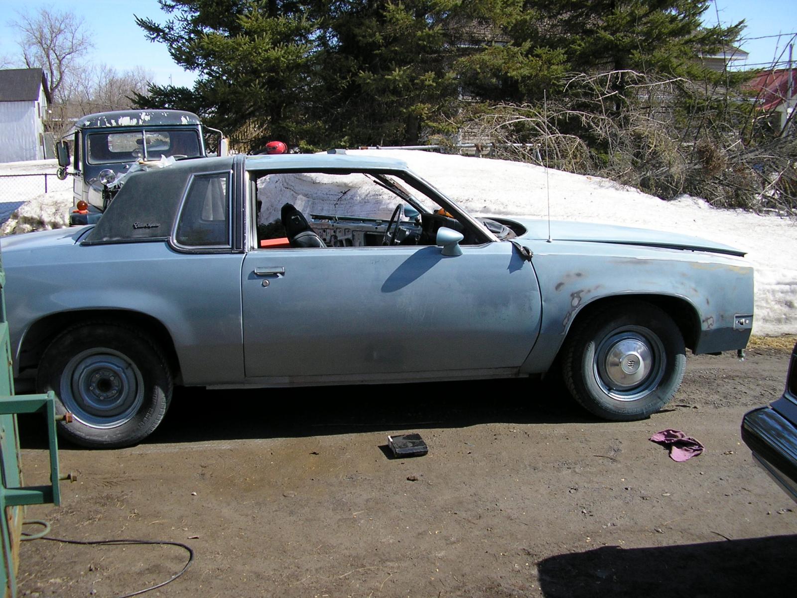

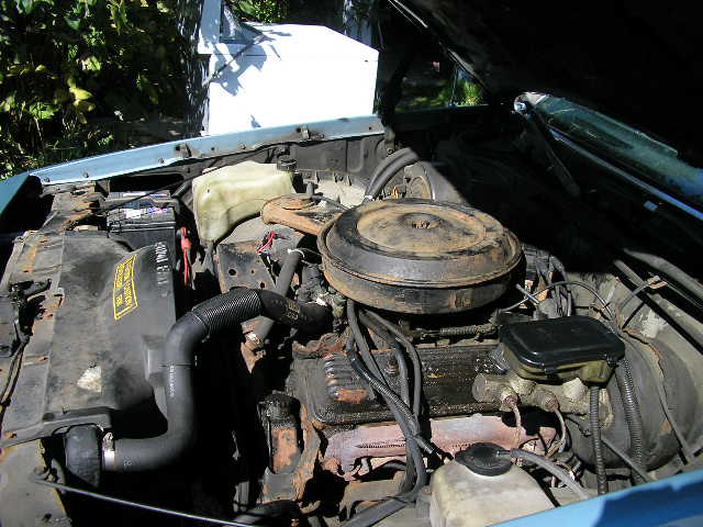

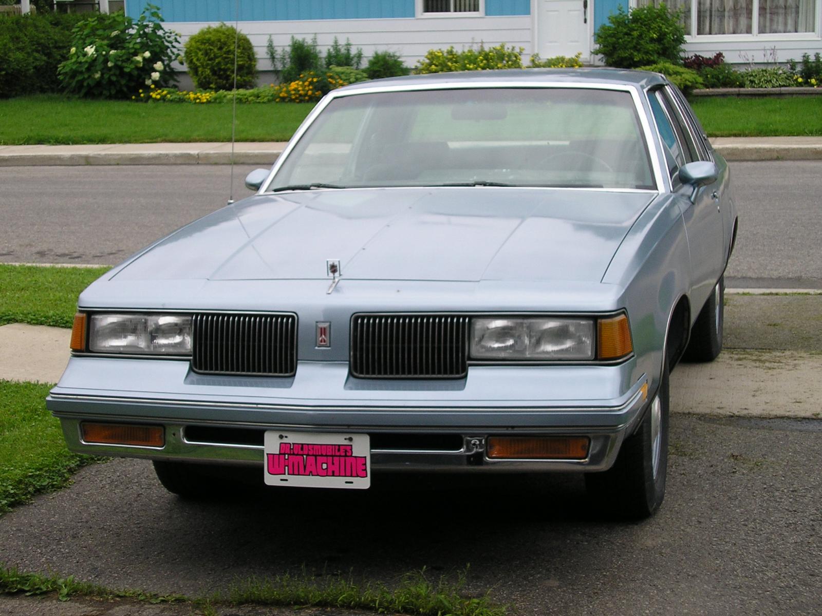

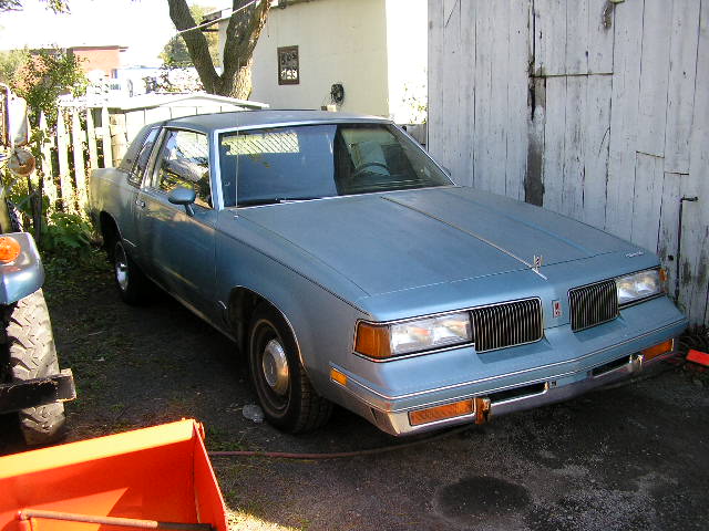

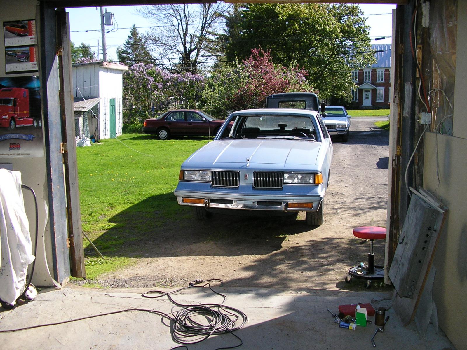

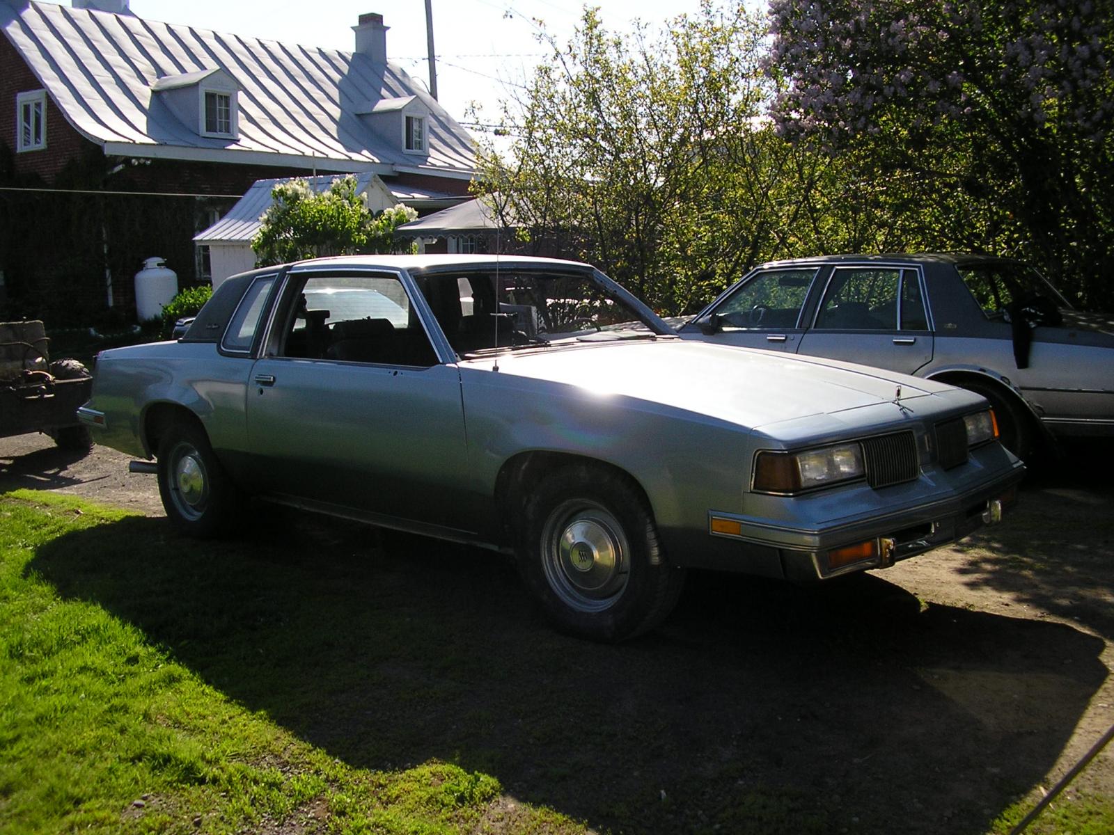

      this is the car wen a bought it in 2006 Name:  005.JPG

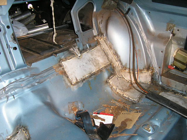

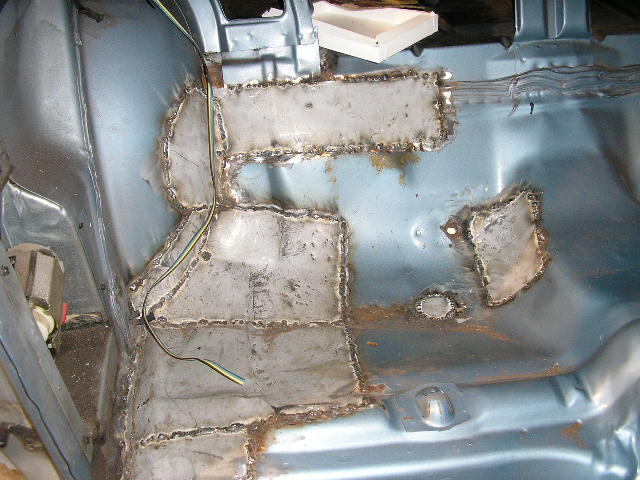

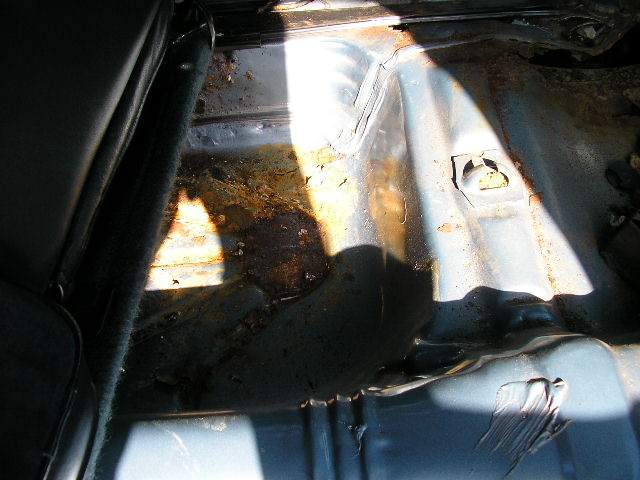

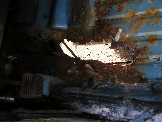

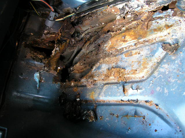

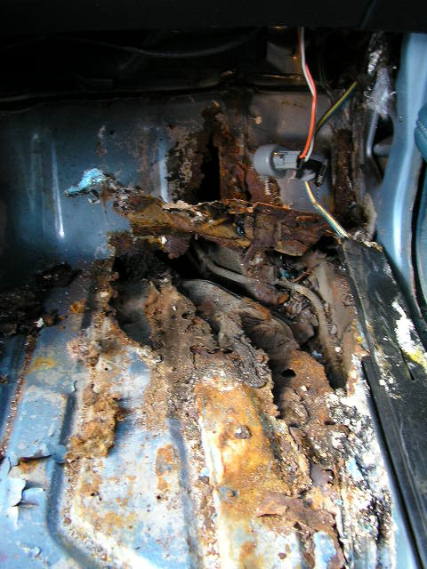

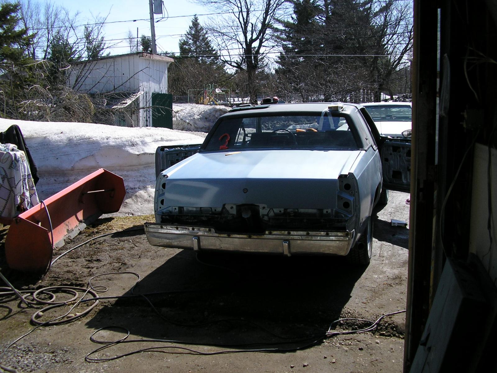

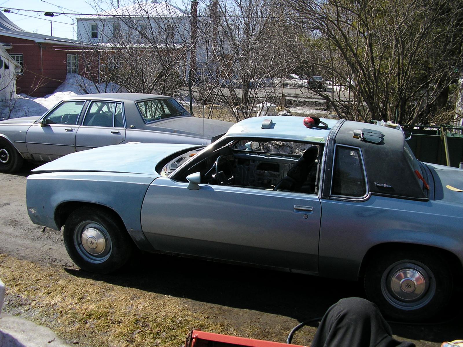

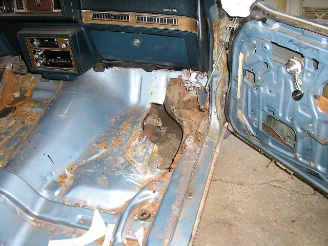

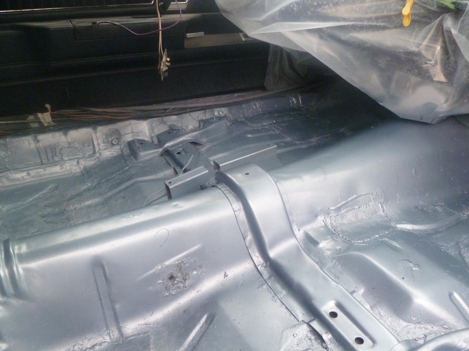

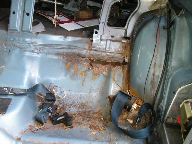

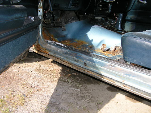

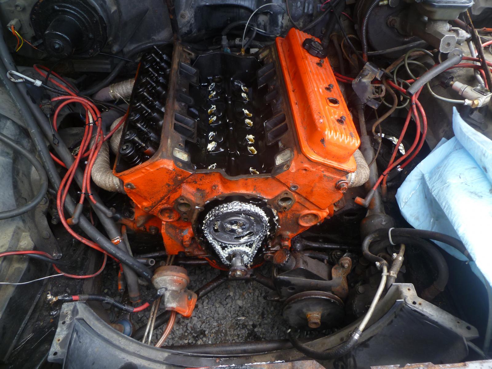

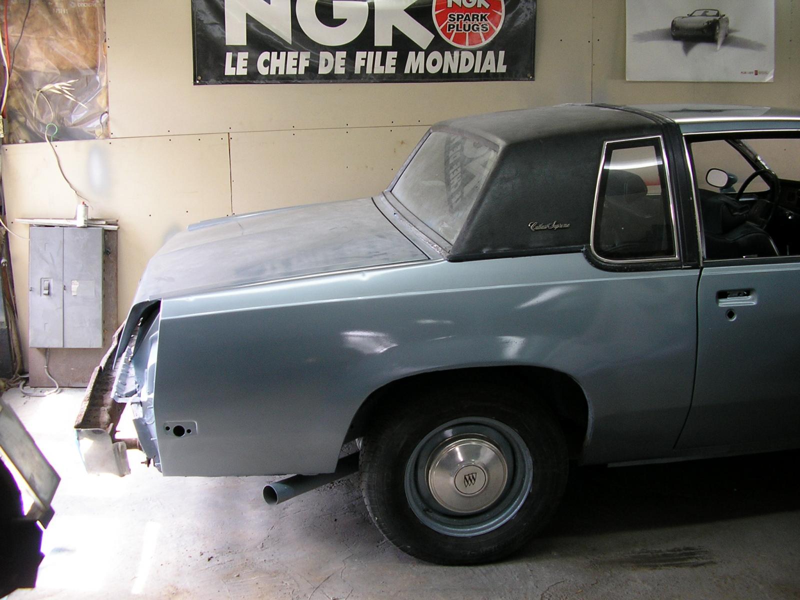

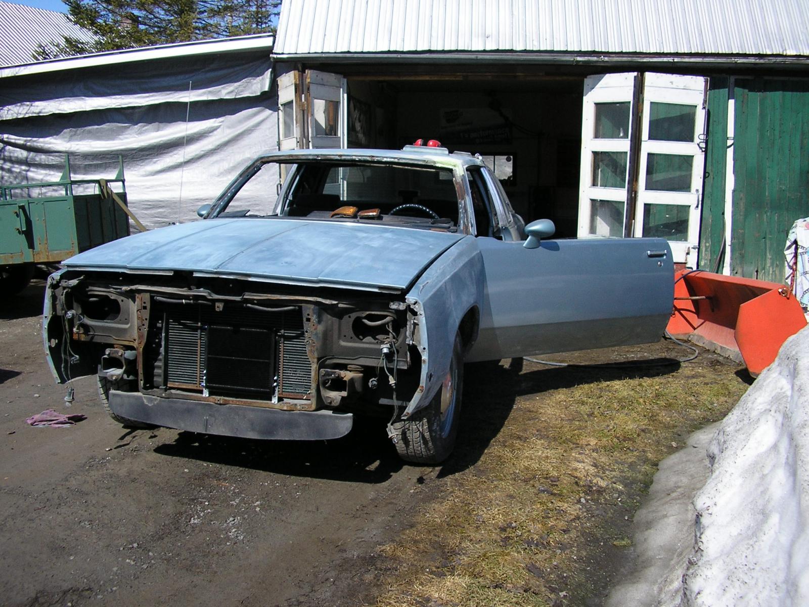

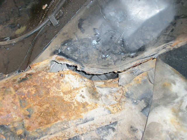

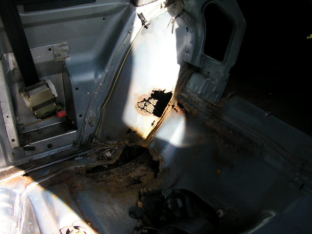

Size:  64.0 KBi pay 350$ flor was bad the frame need work and the engine mistfire . the next year i work on the car .Name:  003.JPG

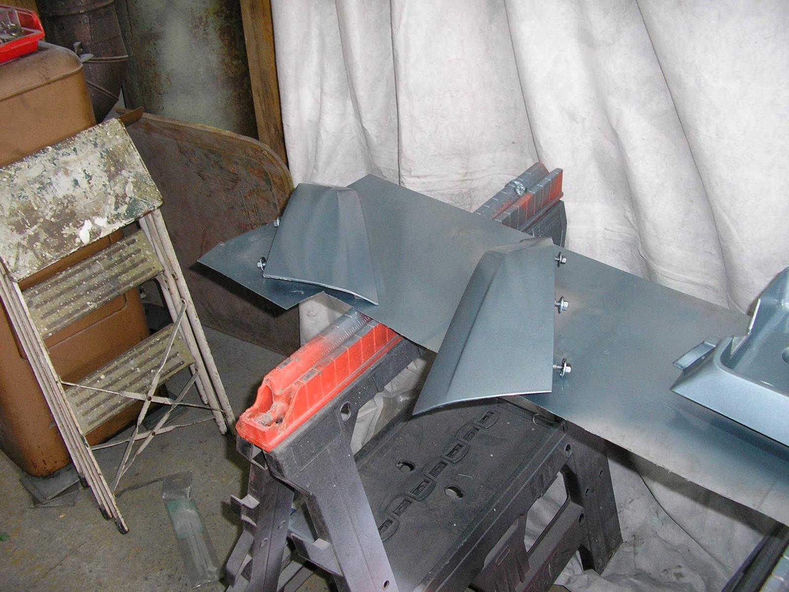

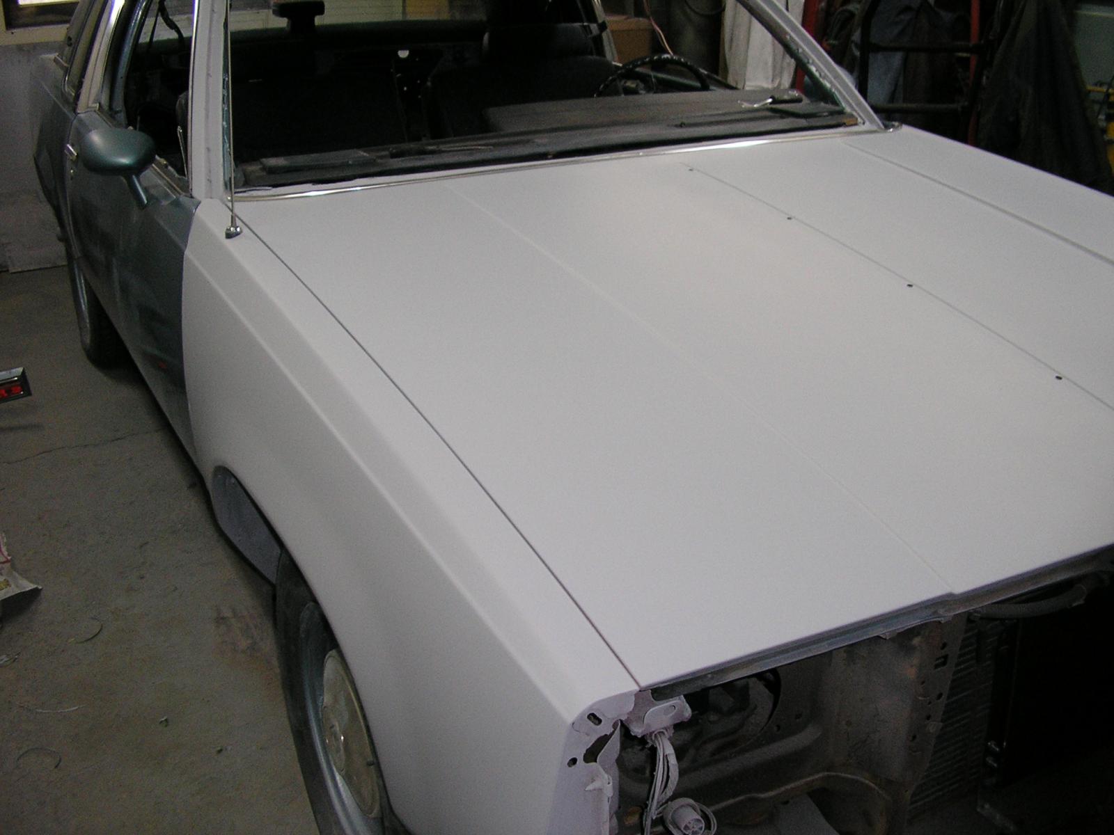

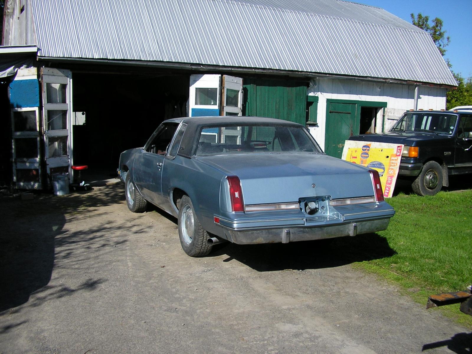

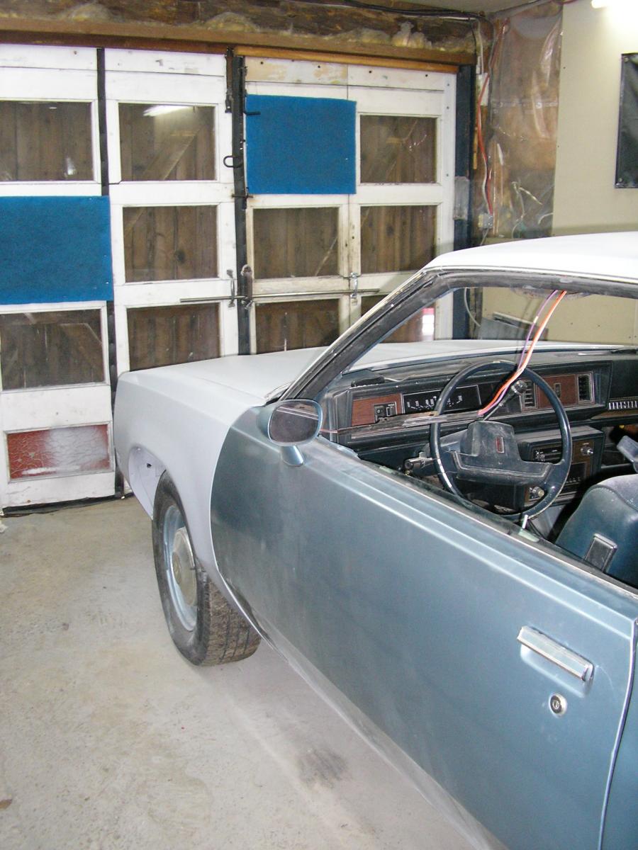

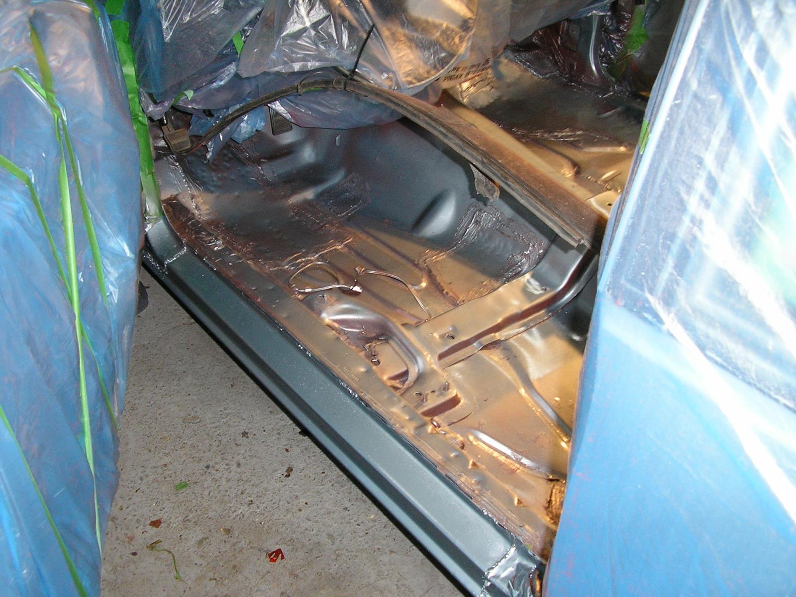

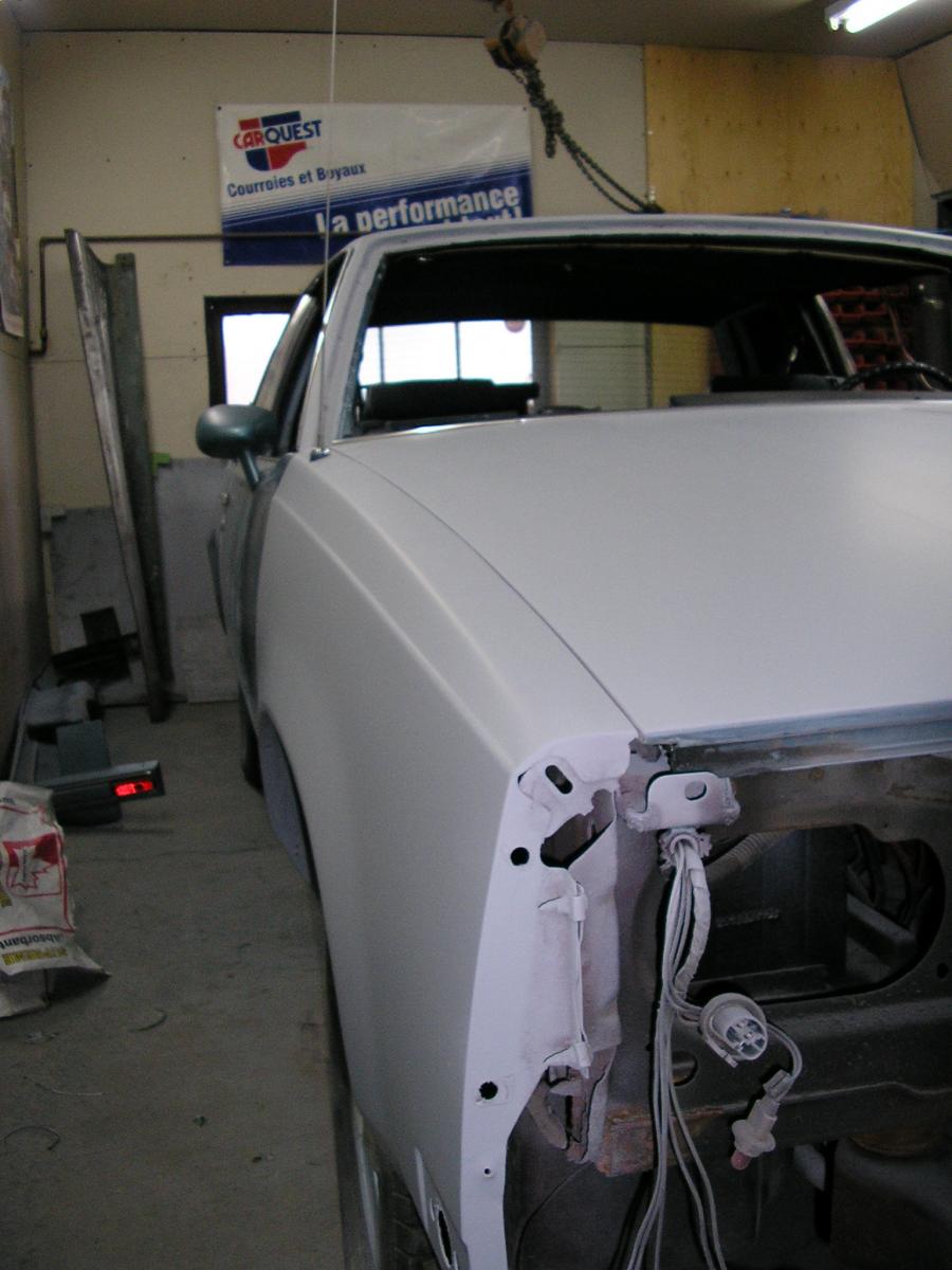

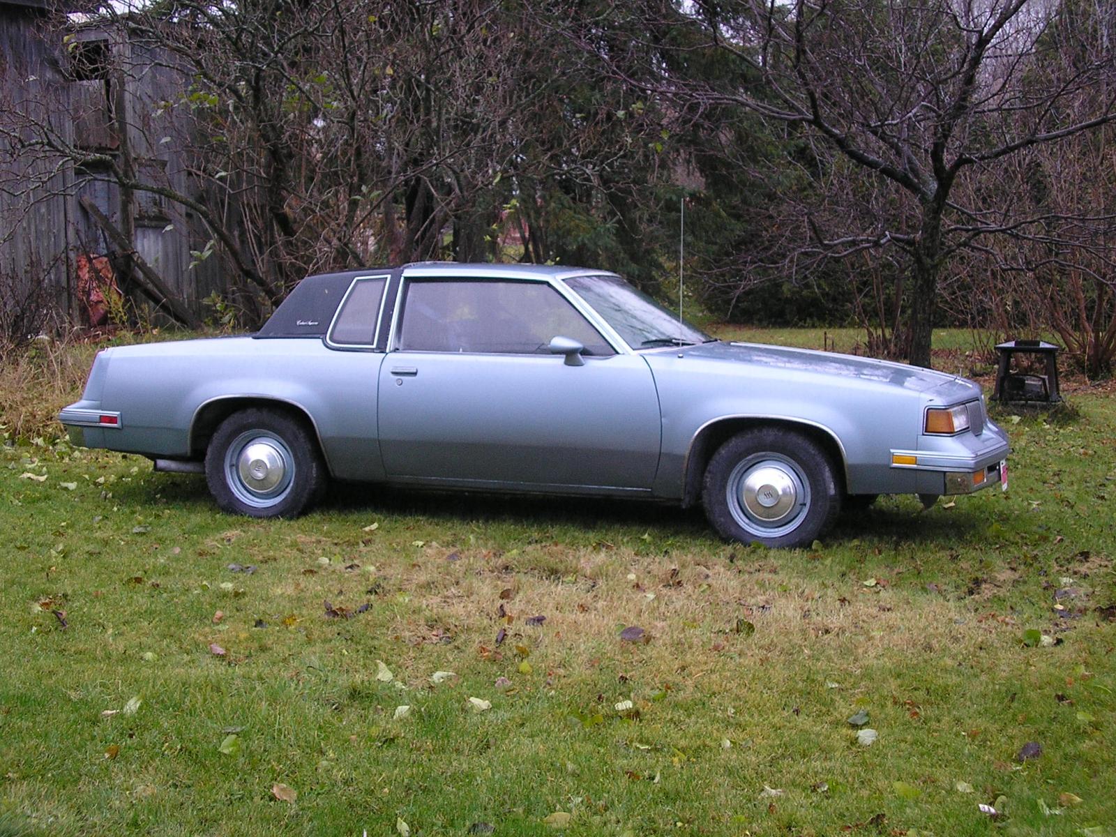

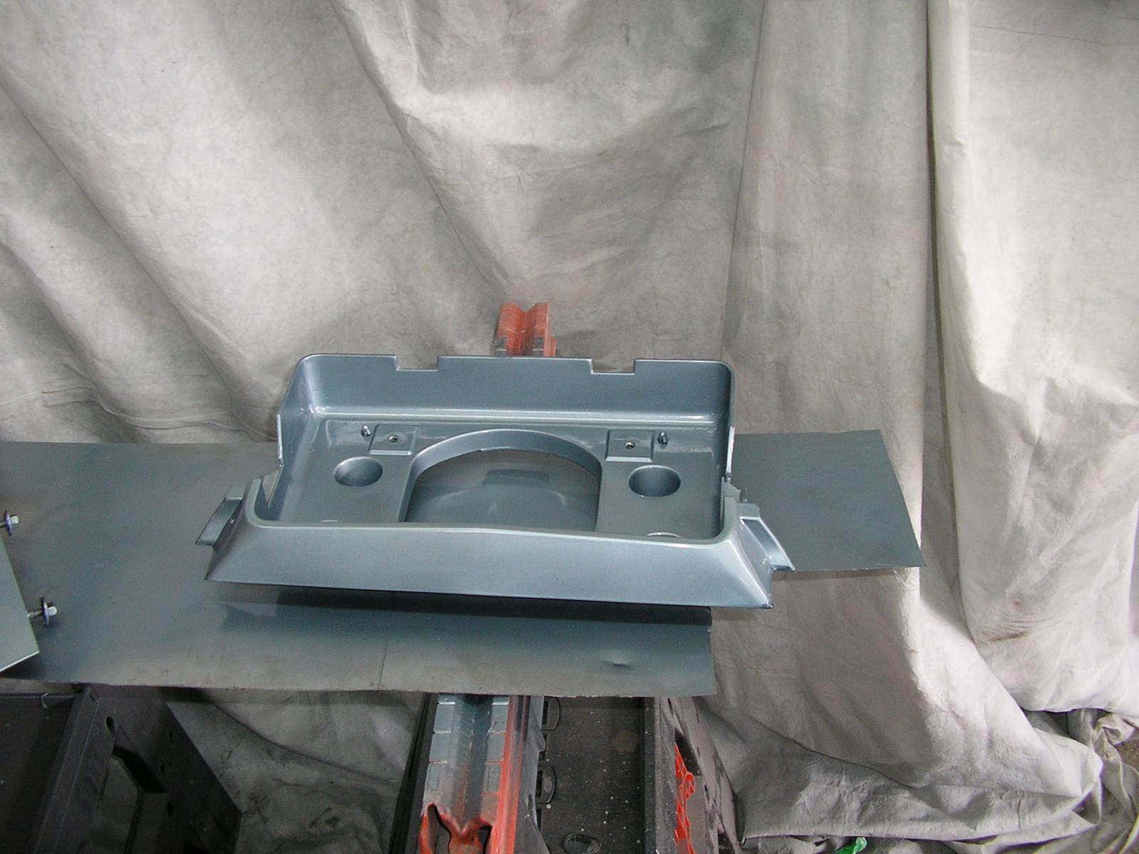

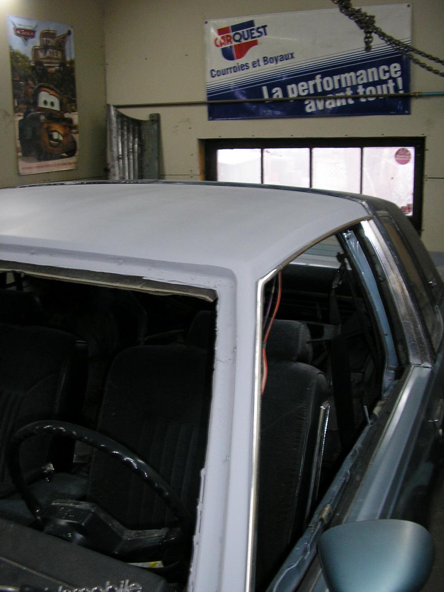

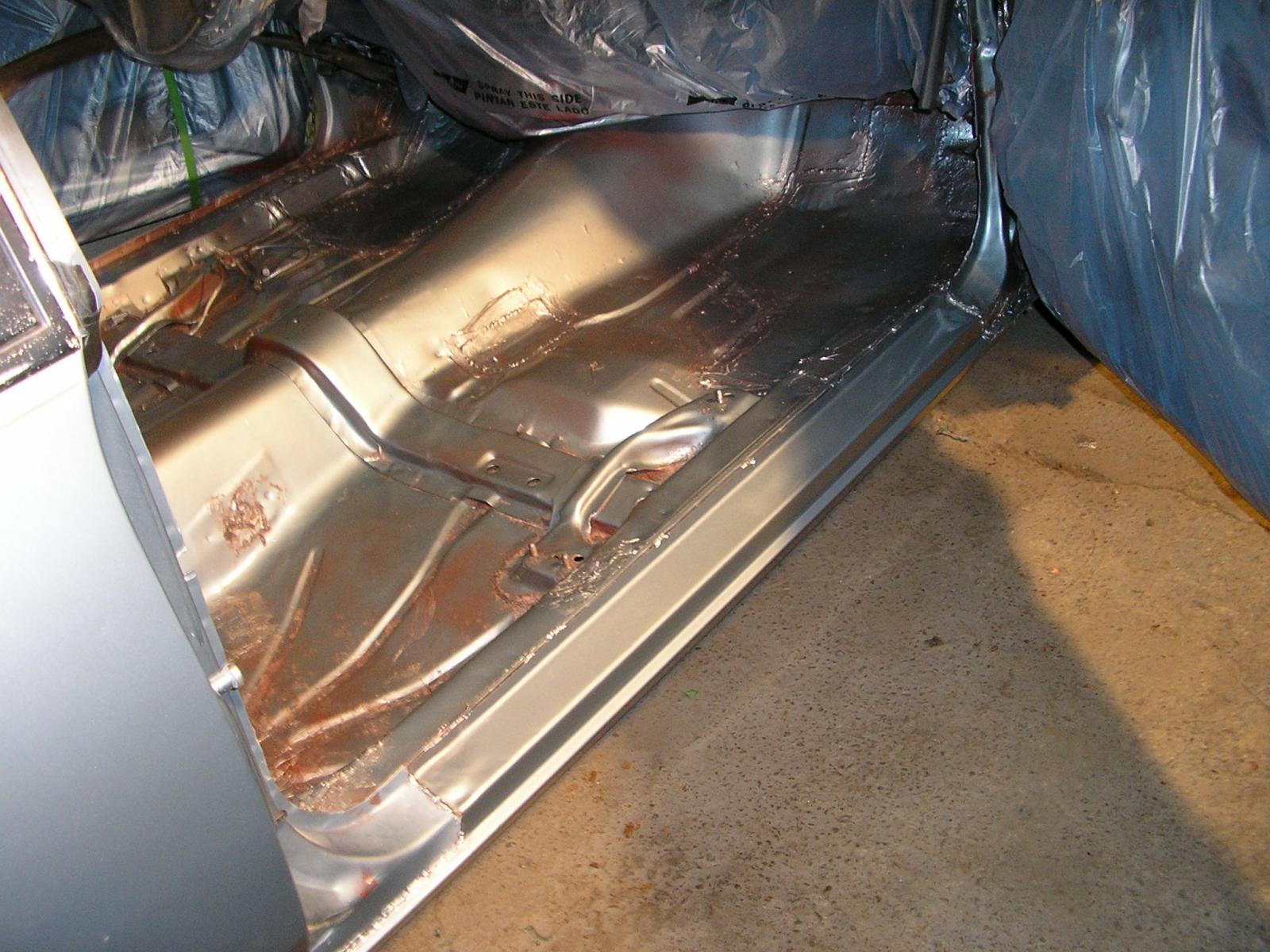

Size:  308.2 KBi redone the flor / trunck put 2 doors from a 1986 paint the car and went driving and drag race 16.458 on 1/4 mille whit 2.73 a 305 whit a intake, edelbrouck carb .malory fire this was the first year . in 2007 a put a 1987 z 28 quick ration steering box a hockis rear sway bar and b&m sfit kit and give nightmare to my brother in law whit is 99 civis si on the country road ! it hock up great ! a big car ! this year i put rear disque brake biger sway bar up front . i will post more picture this week !

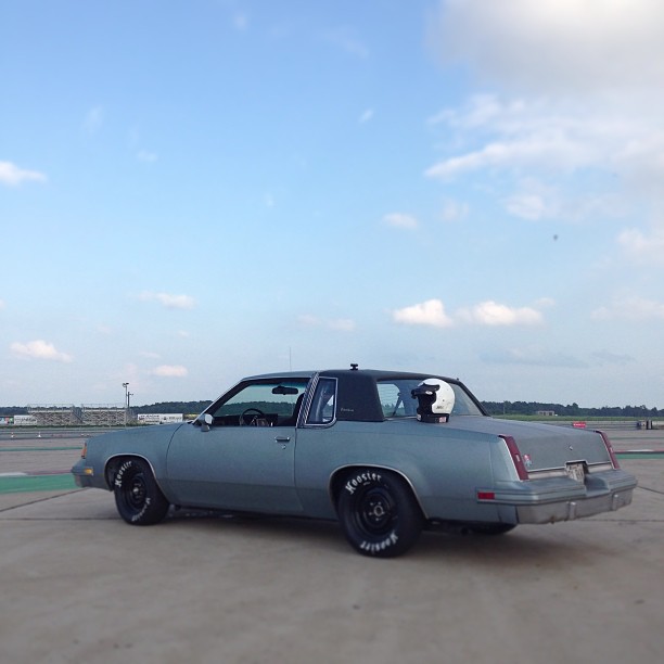

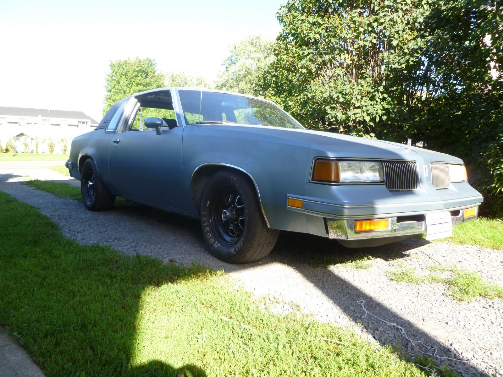

Size:  341.8 KBlast pics off the summer 2012 Name:  dics.jpg
Size:  163.4 KB1993 camaro rear disque on my 7.5 axel cadilac rear caliper whit hand brake afco spring 4 corner. 1987 quick ratio stering boxe 1 in whell spacer rear to clear caliper

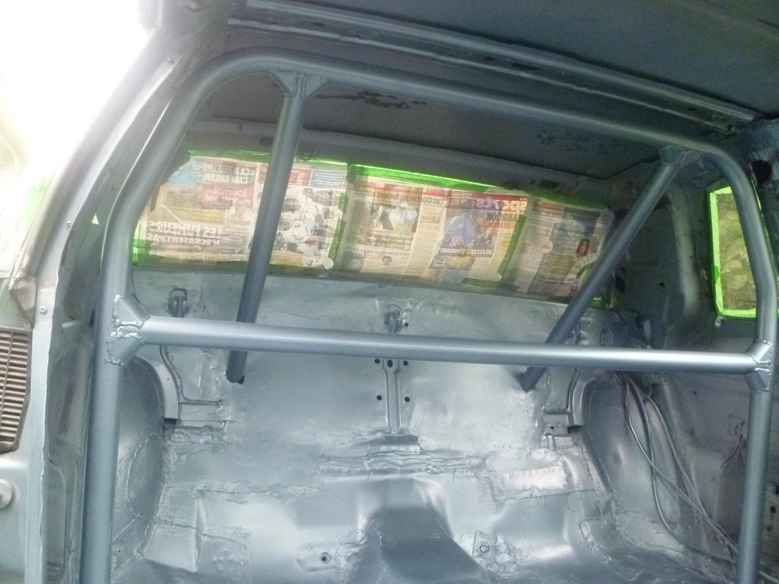

Size:  175.0 KBnew stuff on the cutlass roll cage sway bar exhaut and interior paint

      Nice progress, what all did you do with the suspension and brakes? I see rear disks, are those S10?

      Wow, Klaude, I'll never complain about how much rust my El Camino has again!

      Quote Originally Posted by carguykeith View Post
      those are 1994 camaro rear disks and proteck caliper braker from daymotorsport and metric gm caliper like the one up front , my suspension are afco coil 800lbs front and 175lbs rear. stock shocks for now 1 1/8 front sway bar and 1 rear , i will run bilstein ak shocks next summer and a new sway bar up front 1-1/2 mine used

Size:  43.5 KBfirst time at the trac ! sort time attack corse i made 8 runs best was 31.16 . to compare Honda b20 vtec run 29.13 and wrx 33.00 .got to get in to second gear on haf track here the track Name:  419034_577848582260192_877013922_n.jpg
