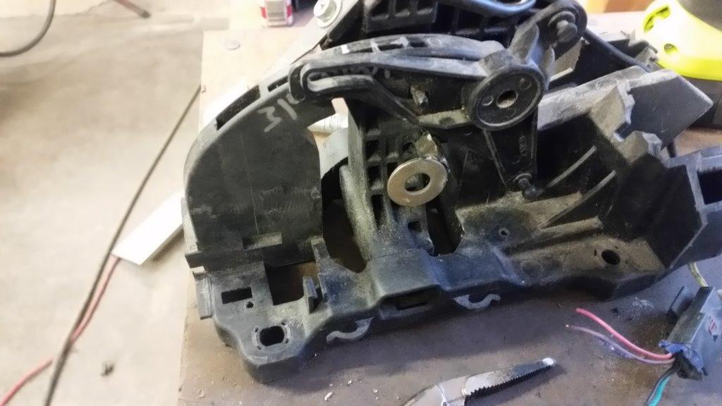

      6L80E Malibu shifter

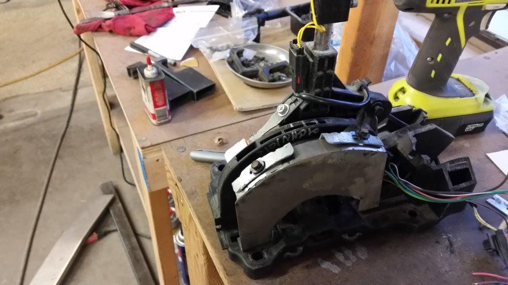

      I finally had some time to get some work done, after being gone away on a work trip for a couple of weeks. Time is getting short, I have to get this somewhat together before I move in June.
      For this update, I mounted a shifter from a 2008 Malibu. Because it is such a tall shifter and my tunnel is also tall, I had to build a recess for it so that it would reduce the height. Additionally, the Malibu shifter cable wouldn't attach to the transmission with the original bracket so, I had to fabricate one of those as well.
      Life would have been much easier if I had a brake and a shear but, I can't ask for everything.

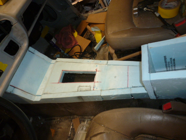

      I've been gone so much with work trips I haven't had time to post an update. I didn't think I accomplished much until I started looking at all of the pictures. I would have had it in primer sooner but, until recently, it's been too cold to put any paint down.
      For this update I've done the following:
      -With some help, built the center console out of household foam insulation and laid it up in fiberglass. I don't have a final picture but, should have one soon. Because of the size of the planned head unit, I had to make a spot in the tunnel for the radio to fit in.

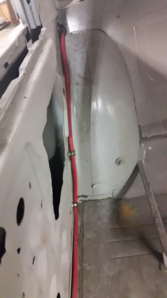

      I haven't done much since the last update. I did manage to seam seal everything on the inside as well as putting some 3M expanding foam in some of the areas where I might get some vibration. Some of you may think, that foam will only rust but, it is an automotive grade. If any of you do this, it expands about 10X the original volume.
      Because I wanted to sell my rotisserie before I moved I went ahead and put the brake lines on it. This was my first experience with NiCop (cuniform) and it was much easier to work with than stainless. I did have to make a couple of modifications on the top of the frame rail and I used studs to hold on the clamps but, nothing too difficult.

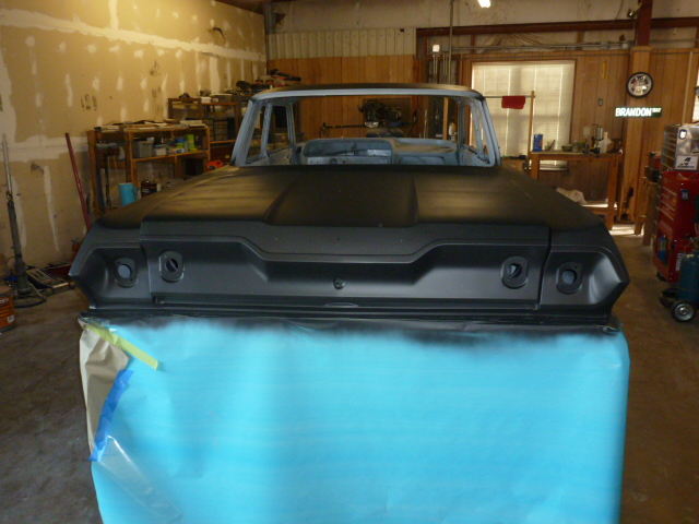

      High build--Finally!
      I finally was able to spray high build (Featherfill G2). There are a few spots that will end up needing some more filler but, so far it looks pretty straight. Still have to fit up the VFN fiberglass hood but, the body work is getting closer.
      Once it is blocked and shot with 2K, I will work on getting it running. My intent is to do all of the final cutting, drilling, etc and not have to worry about scratching paint in the process. I did that on my last project and it was a good lesson learned.

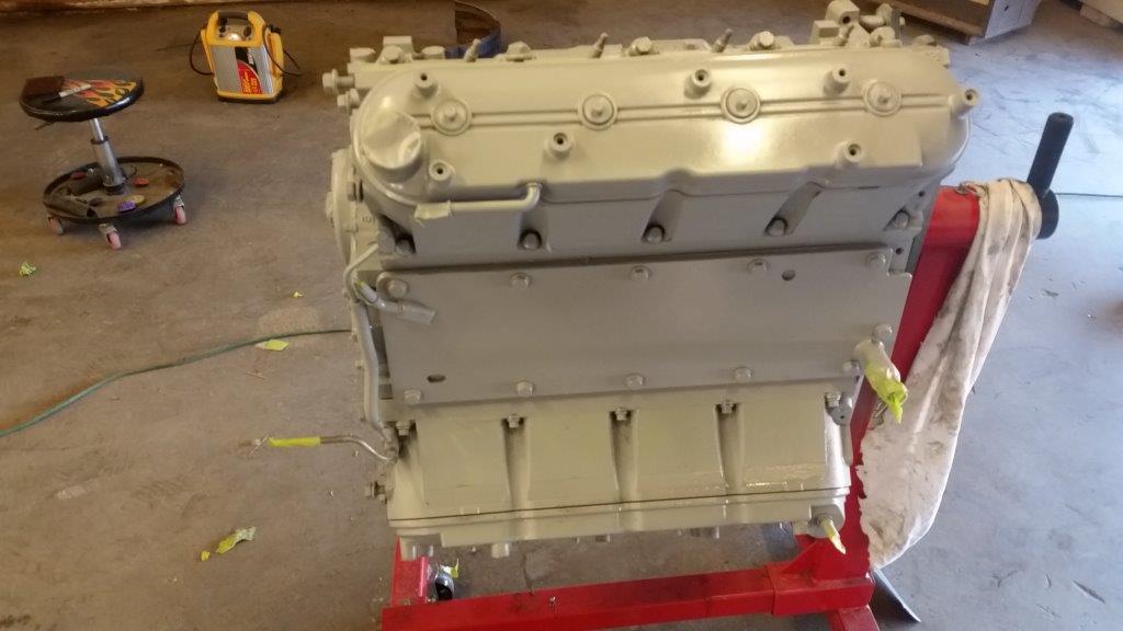

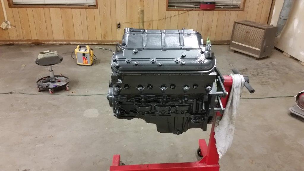

      Not a whole lot to update on. Showing pictures of block sanding is even more boring than doing it.
      I finally received all the parts for the engine, installed the EPS cam, valve springs and push rods. I also finally picked out the colors, which allowed me to paint the engine.
      On to the pics:

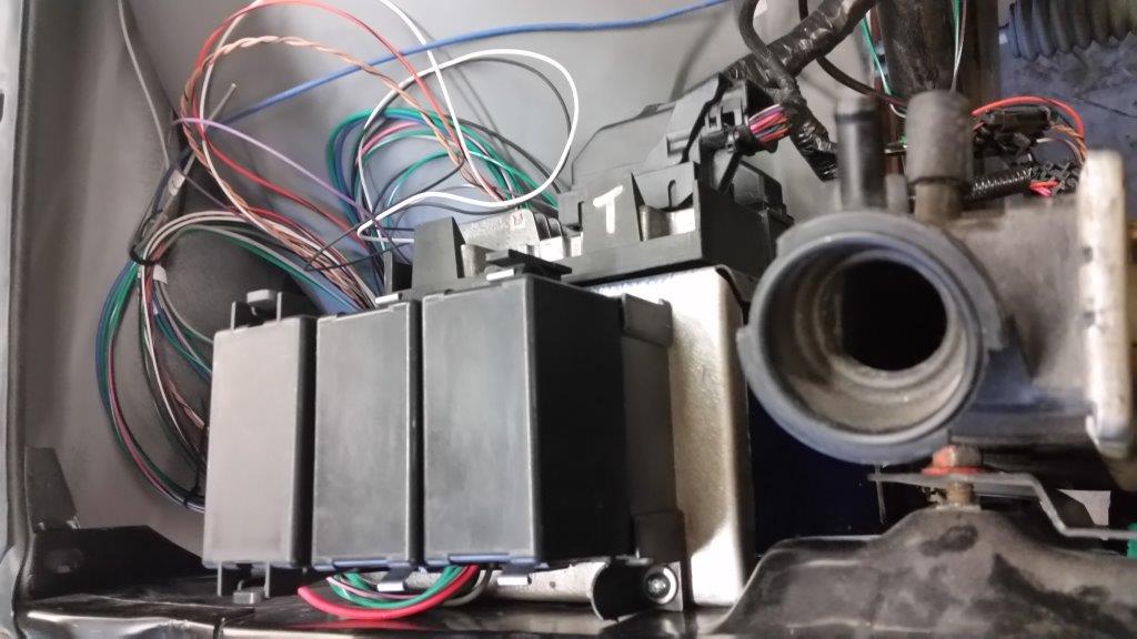

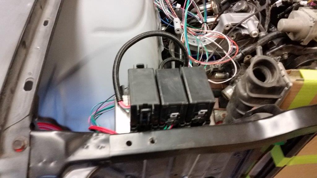

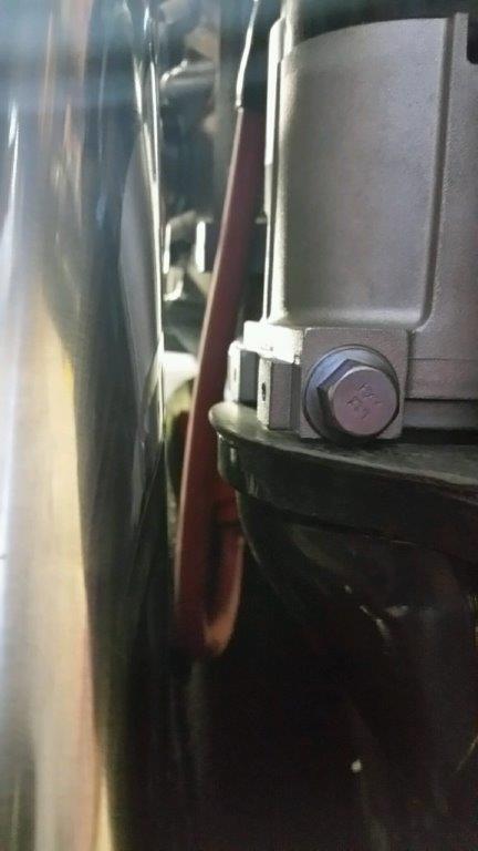

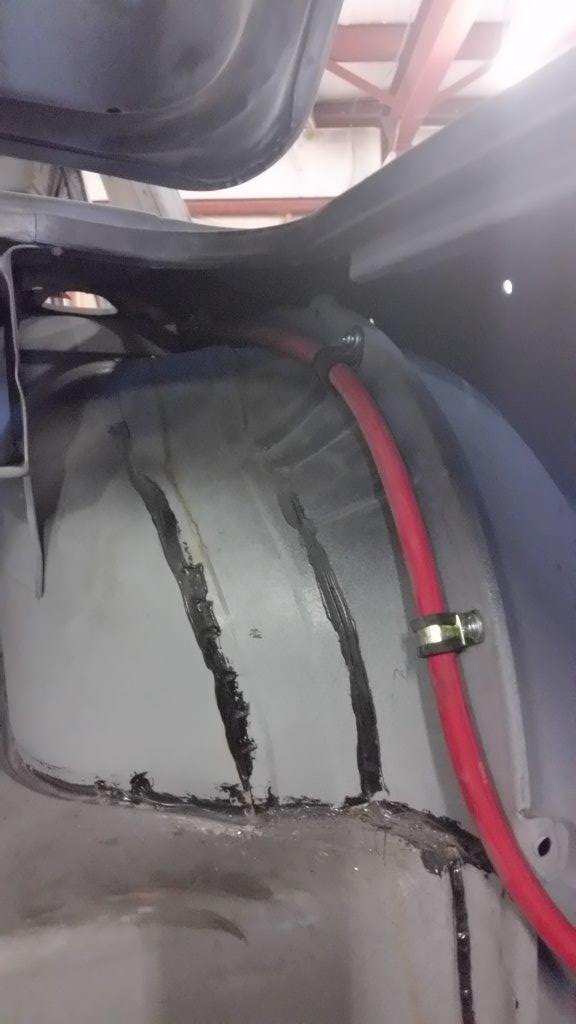

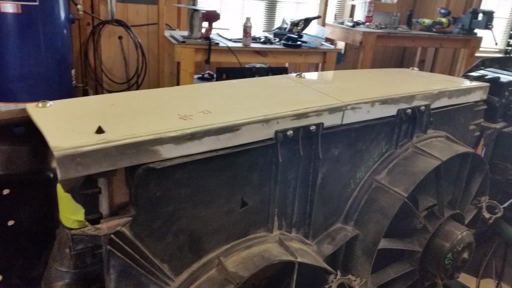

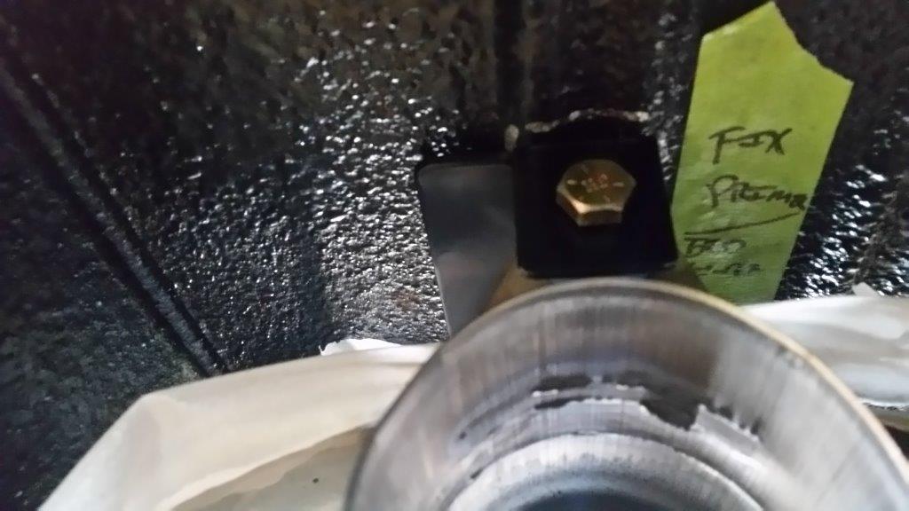

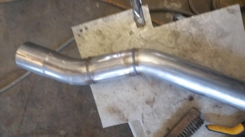

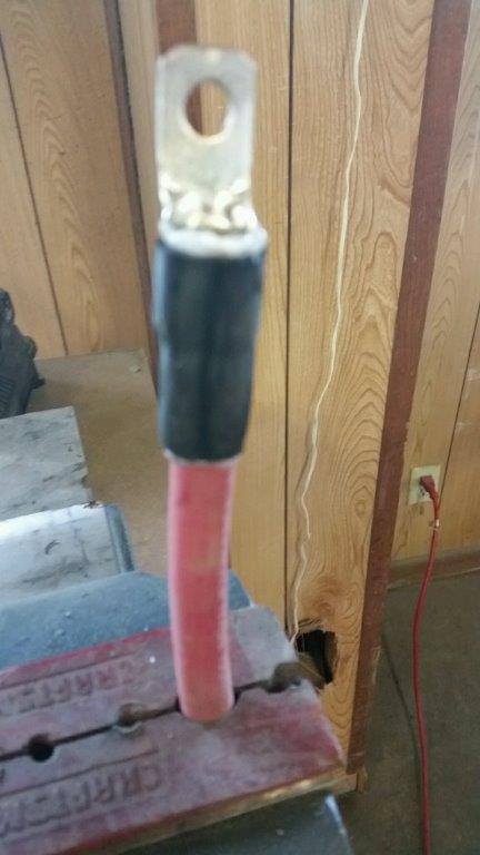

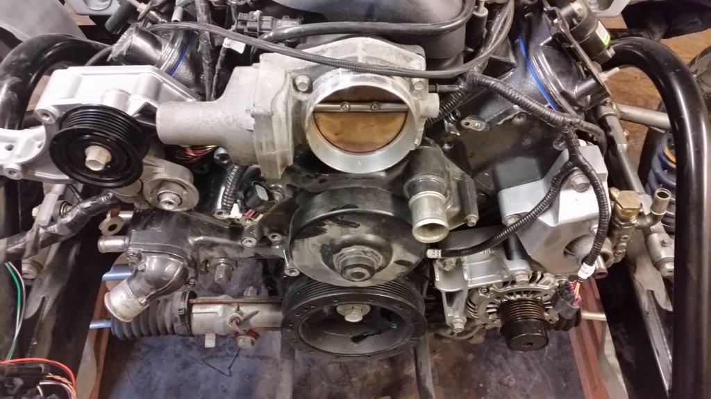

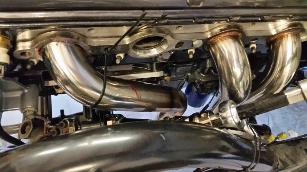

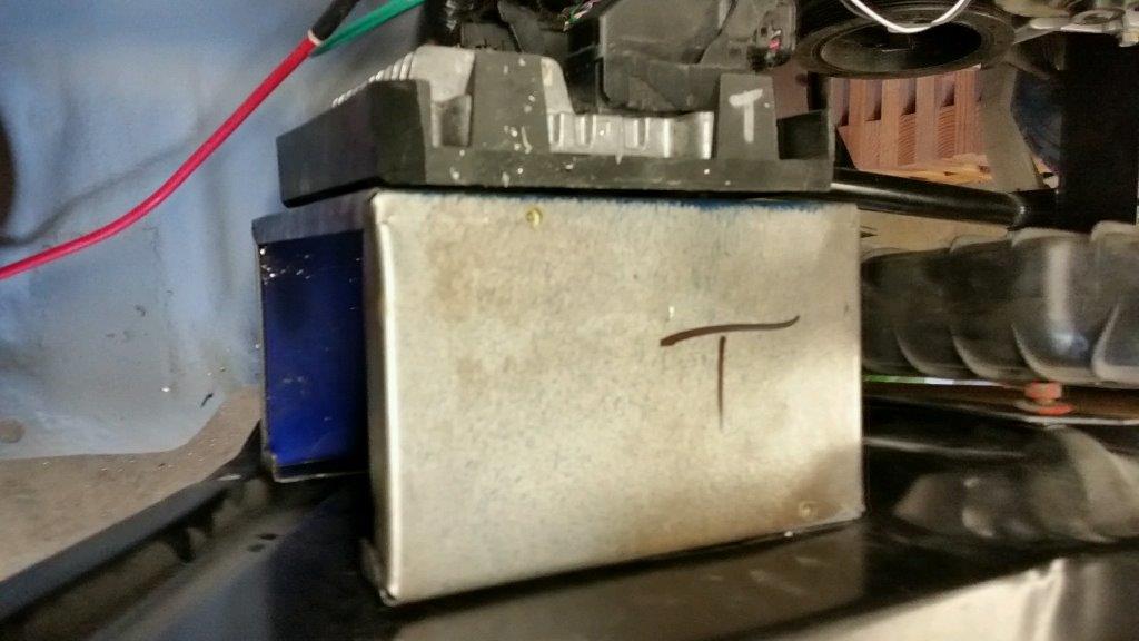

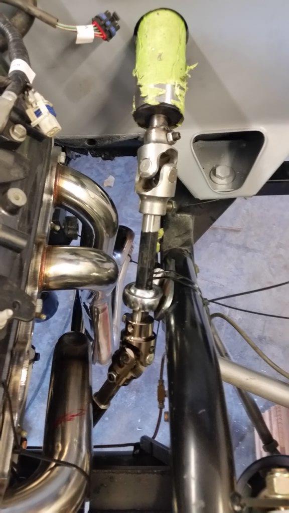

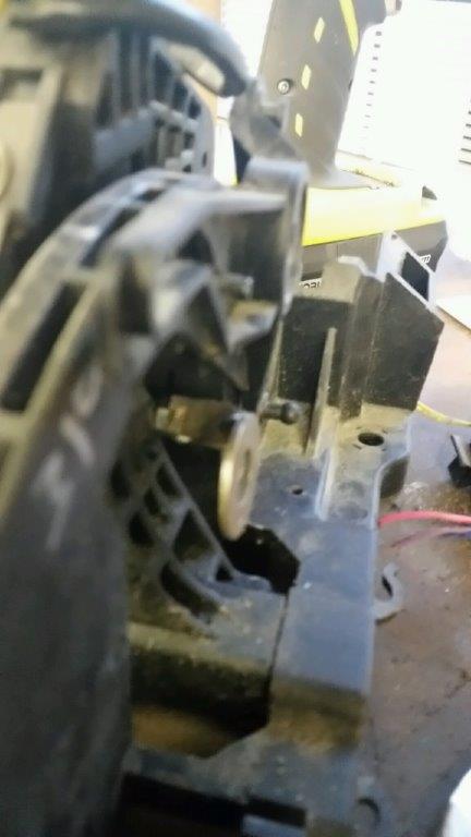

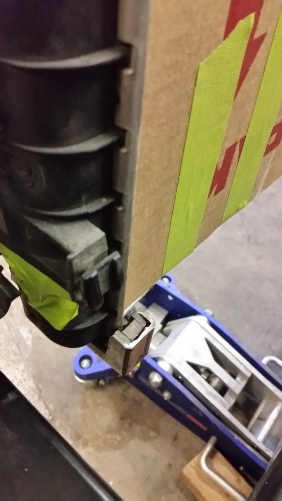

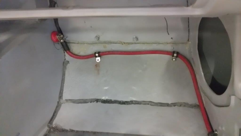

      Misc stuff (steering column, header mod, ECM Mounting, battery cables)

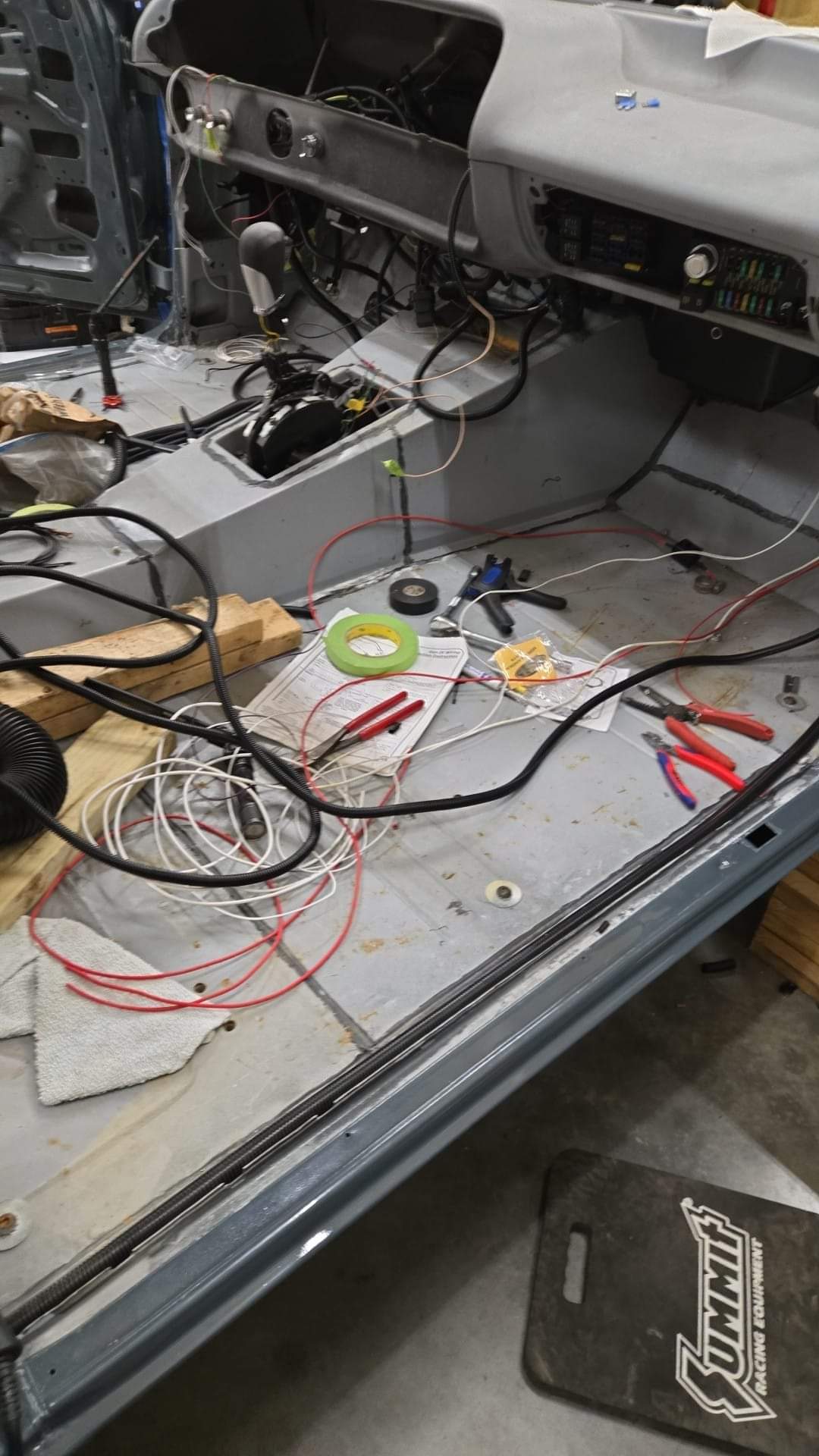

      Despite not posting an update, I've actually been working on the car. For the most part, it has been blocking and sanding. Not a whole lot to take pictures of or, even remotely exciting.
      Now that I'm to the point where I'm about ready to spray 2K primer, I figured I should start doing a lot of the mock up so I don't have to risk drilling thru fresh paint or scratching it. I did that on my last build and really regretted it.

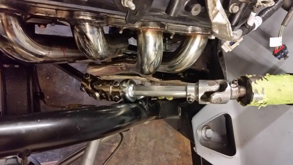

      So, for this update I did the following:

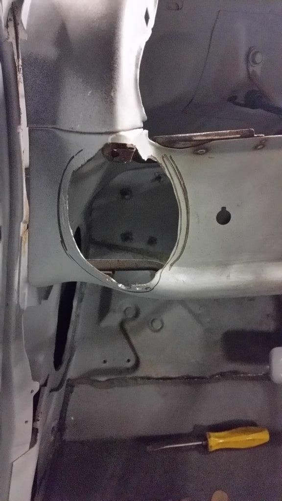

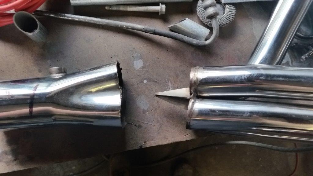

      -Mocked up engine, made radiator mounts and a mount for the ECM. Because I used a re-worked stock harness my options were pretty limited on where to mount it.
      -Mocked up the steering shaft. Because of the angle, I had to use a third joint and a eye bearing to hold it. I really didn't want to grind of powder coating but, we were able to hit the hot metal with powder had it stick and finished the job with a heat gun.

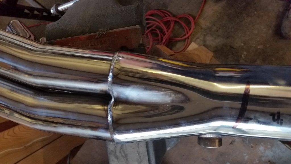

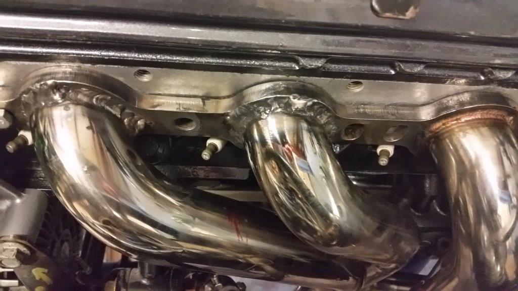

      -Did major surgery on a set of speed engineering headers to get them to fit around the steering shaft. I've only TIG welded a few times but, pretty happy with the welds for the V bands on the outlets. The welds on the tubes are kind of ugly but, they will hold. Polishing them up gets rid of some of the ugliness.

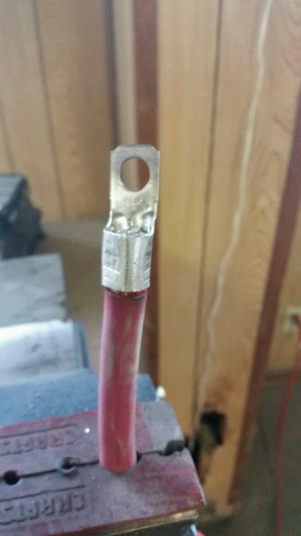

      -Ran my starter power cable and installed the battery box. I used P clamps along it and before I go final I will use some braided wire loom to make sure it doesn't chafe anywhere. I plan on using a Mad electrical solenoid but, have to wait until my allowance builds up.

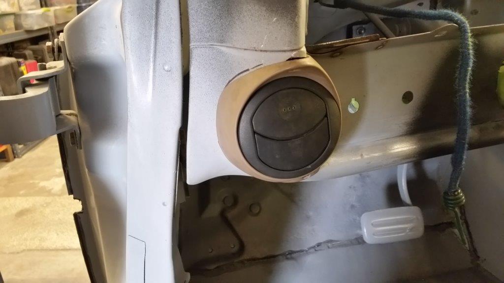

      -Cut holes in the ends of the dash for the vents. I ended up using parts of a dash cut out from another car, glad I did as they are a really difficult template to get it to fit correctly.
      -Made a neutral safety/back up light switch for my Malibu shifter. I've been wracking my brain on how to do this because the 6L80E doesn't use a switch instead it goes thru the BCM. I ended up using a F body switch and modified the shifter to make it fit.
      -Lastly, a few other odds and ends like finishing fitting the body mounts and a lot more sanding.
      Glad I have some help from friends with this. Spatial things like figuring out how to re-work the headers makes my head hurt.

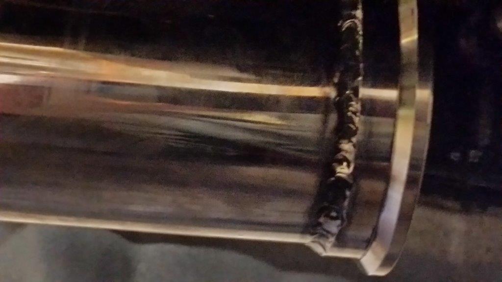

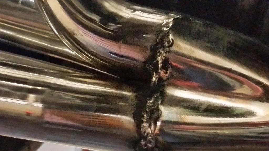

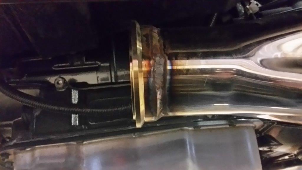

      Gotta work on that TIG! ;)
      Did the passenger side header work out ok?
      -Dale
      SchwartzPerformance
    15. #75
      Mar 2012
      Texarkana, TX
      186
      I'll have to get a better picture of the last flange, looks better than the rest of them but, far from great. I suppose not too bad for only doing it a few times.
      The PS worked out just fine. I just had to shorten the collector a couple of inches to line up with the DS header.
      63 Biscayne
      Schwartz Performance Chassis
      My build thread: https://www.pro-touring.com/showthre...ht=#post916553
    16. #76
      Apr 2012
      Woodstock, IL
      2,410
      Cool. Yeah the V band flanges are looking good.
      Sometimes you can just go back over the areas you welded to make them look prettier. Clean with a brush then go back and pedal it with little blasts of heat.
      -Dale
      SchwartzPerformance
    17. #77
      Mar 2012
      Texarkana, TX
      186
      Thanks. I really need to invest in a tig welder but, that would mean less parts.

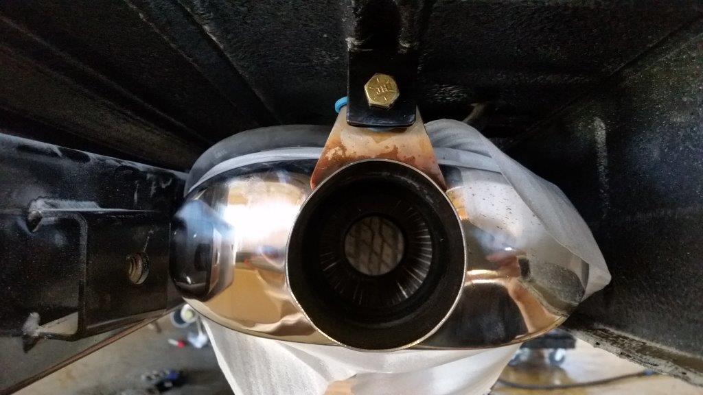

      186

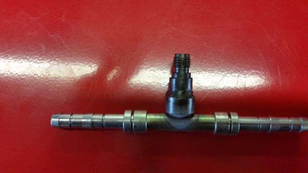

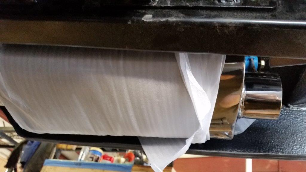

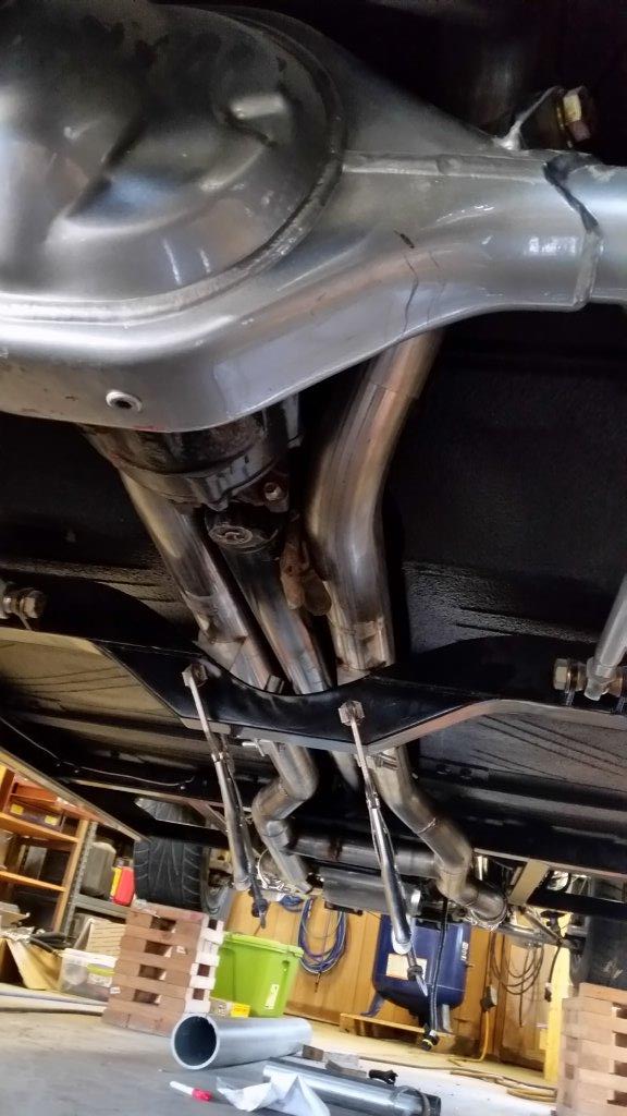

      Exhaust and AC mock up, and LS AC pressure switch adapter

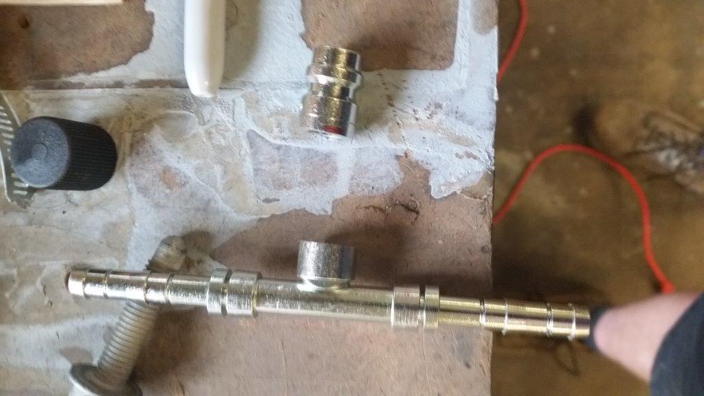

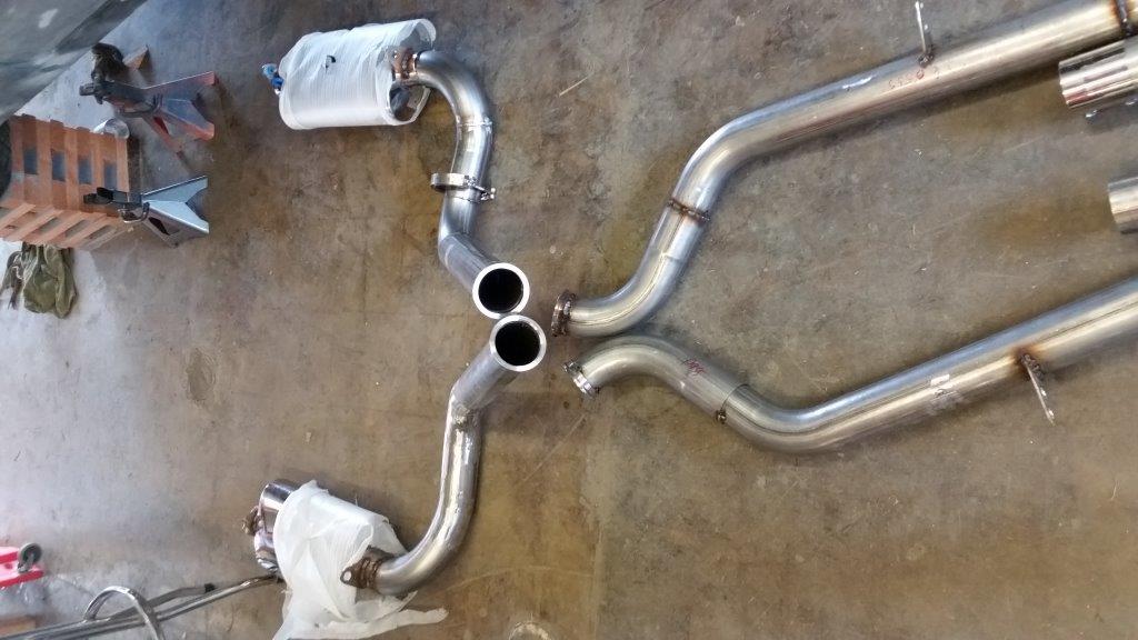

      I've made a little progress since the last update. For this one, I finally received all of the parts to finish up the accessory drive, installed the top cover for the radiator, mounted the fans, mocked up the AC lines and have just about finished the exhaust. Just a little bit to finish up on the exhaust but, the big pieces are finished.

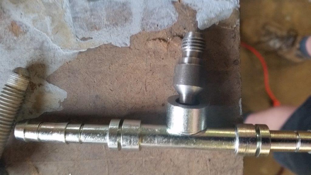

      One of the challenges I had was finding an adapter to connect the LS pressure switch to the AC lines using an EZ clip fitting. They make pressure switch adapters but, most don't have the right threads. I purchased a weld on adapter and TIG welded it to a pressure port EZ clip fitting.
      Next step should be paint unless anyone else has some other suggestions.
