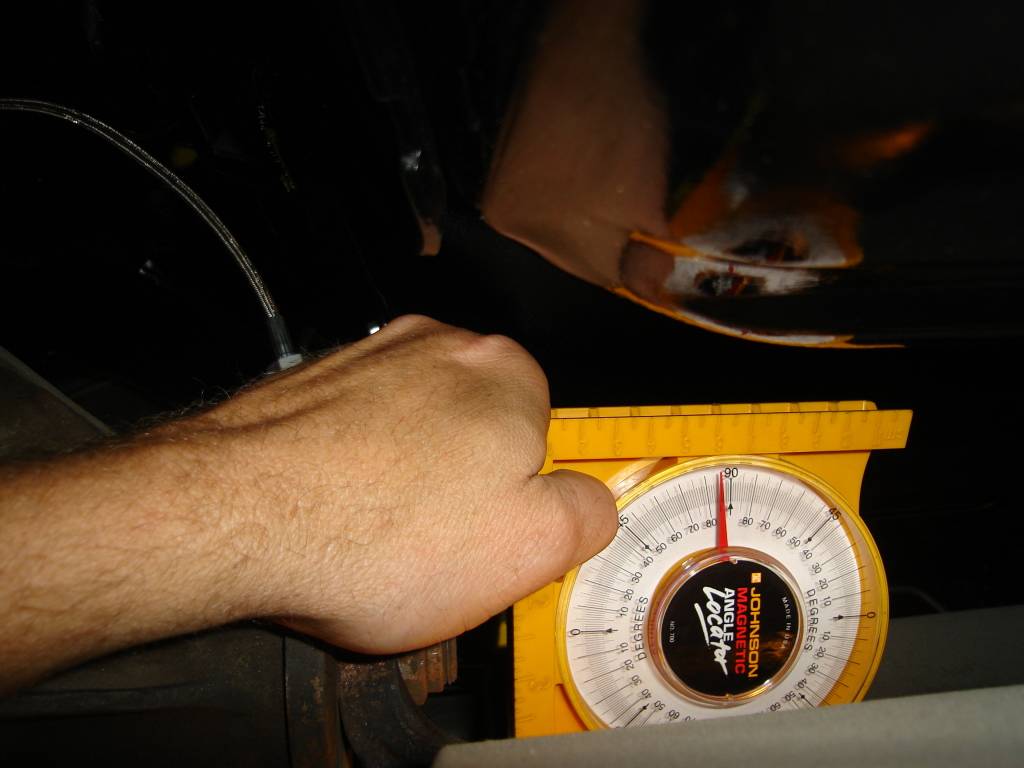

      I bought a 1968 Camaro 12 bolt rearend that was in a friends 41 coupe. I had to cut off the perches that he was using and tack some correct ones on to put it in the car. I think I have it close but the more that I read on the internet the more confused I am. According to Currie I think I did it correct.
      I will base everything off of 0 degrees to make it easier.

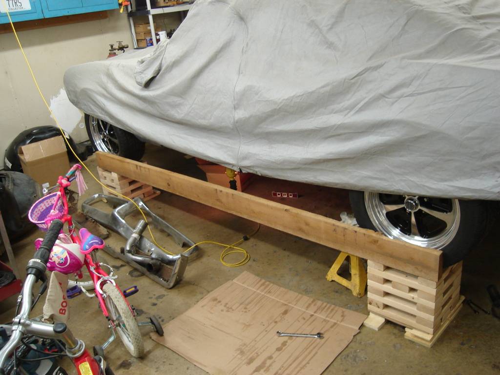

      I first started with leveling the car the best that I could. My garage floor is horrible.

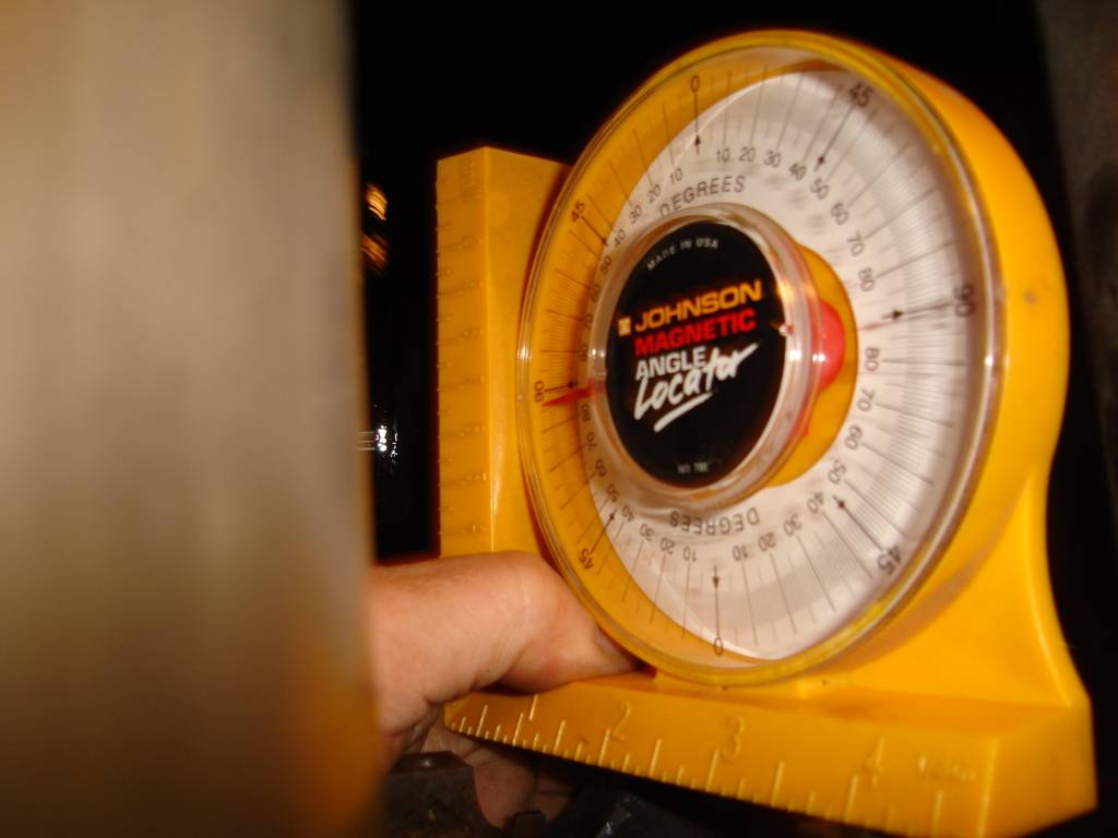

      I started with my reading off of the tail shaft which should be the same as the crank. 4 degrees down. Factory should be 3 degrees down, but my leveling could be off one degree.
      Pinion angle 3-4 degrees down. I have read that you do not want the pinion ever pointed up.
      Drivesahft angle is 2.5 degrees up.
      According to Currie you want less than 2 degrees difference from drivesahft to trans shaft and driveshaft to pinion.
      So,I would have 1.5 degrees down on the drivesaft to trans output shaft and 1-1.5 degrees down on pinion shaft to driveshaft.
