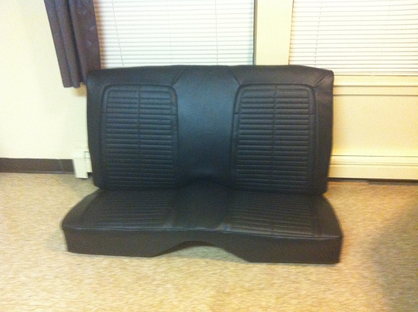

      redid the back seat. doing the front ones in a couple days

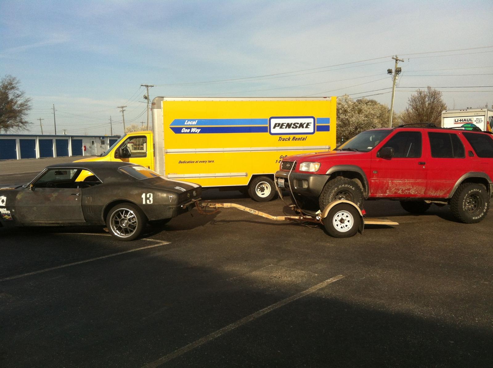

      Well... here's the status now. I'm now stationed at ft bragg and will never again go up to new York and all its salt. I still need to replace the floors from the salt damage and it was a pain to redo the back suspension when I installed the 12 bolt and the 5 leaf heavy duty springs. Also got new wheels with the correct backspacing so I was able to get rid of the 1" adapters in the back and can sleep easy now... The biggest change is I redid the interior aside from the headliner, and finally replaced the drivers door with a dent free rust free patch free original I got for 225 bucks on christmas. No such luck with the passenger door so I gave up and re skinned it for 130 bucks from amd. Also the doors have new hinges and new interior panels and arm rests. I'll post pics of the interior tommorrow.
      Btw I welded together a trailer hitch from a free one I got off my buddies wrecked 93 4 runner... looks like **** but does the job well. I towed a 5,000 pound lifted 2000 pathfinder 800 miles down to north Carolina with no issues. And then turned around and drove it to my in laws in nebraska. After a brief stay in Hawaii I drove the (un) lucky 13 firebird to Missouri where I bought this 67 tempest with a pontiac 400 and an st300 2 speed. I then drove the bird to north Carolina again while hauling this 3500 lb car and with me, two kids, Our dog lacy and my lovely wife. Now keep in mind that I had to disconnect the heater core due to a leak and I don't have any ac either... Also keep in mind that I have Manual 4 wheel discuss brakes and no power steering (bought a new pump but pulled the belt off until I can afford new hoses so as not to burn up the pump).... yeah it was awesome in the hills of kentucky. Brakes never overheated in the downhills and the 461 monster under the hood and Ford top loader 3 speed never skipped a beat passing anything and everything at 75-80 up those steep hills...
      Here's pics of the 67 tempest, the pathfinder and me using the bird to load my 67 shelby clone project ....
      As someone mentioned earlier... This is no garage queen. Really hoping to get out and race it finally... getting pretty old just having to use it as a truck... got my fingers crossed for this summer at some good guys events or something...
