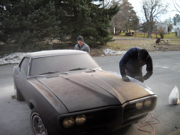

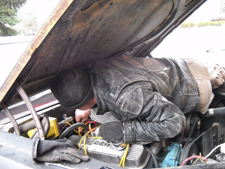

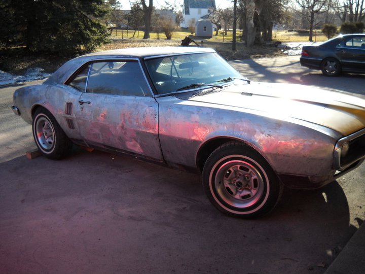

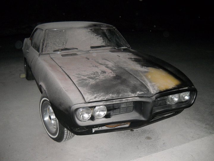

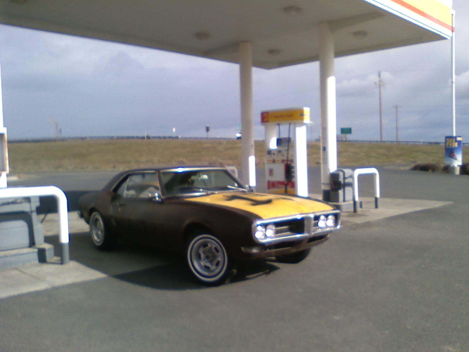

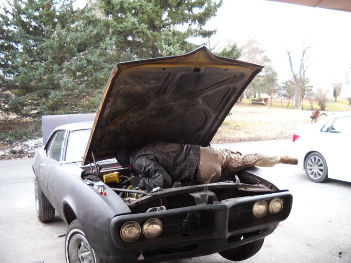

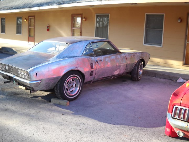

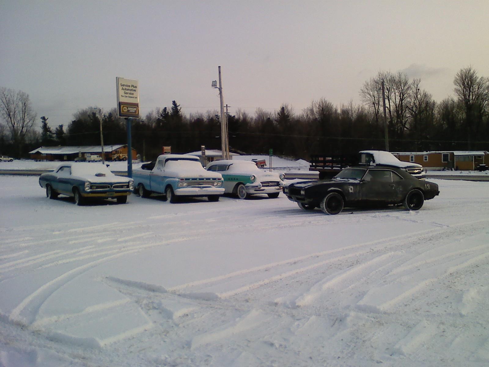

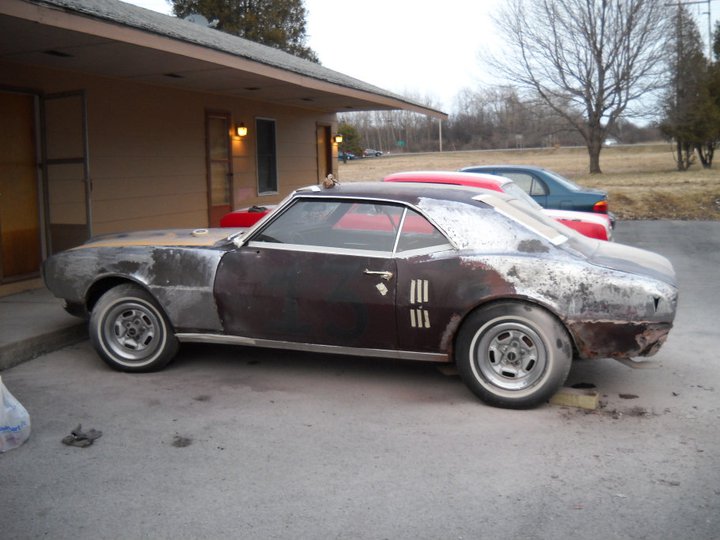

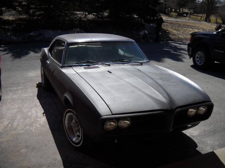

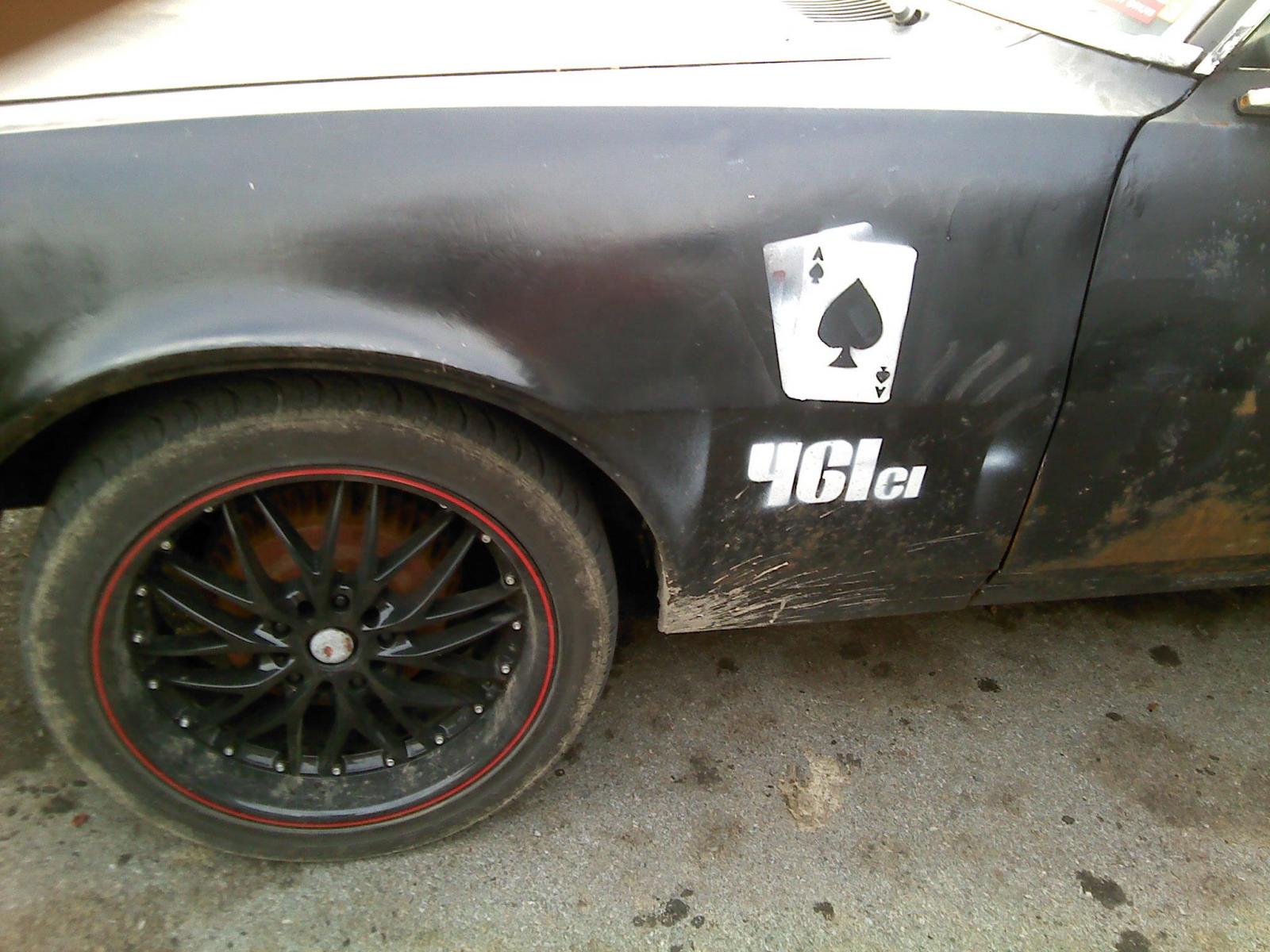

      First thing I should tell you is that this car sees on average about 60-120 miles a day commuting to work and getting groceries with my two kids and wife. This is no trailer queen. I've driven across the country when i first bought it as a private in the army., here's a small sampling of whats been done to it so far. started out with a saginaw 4 speed and a 350 poncho, now has a ford 3 speed and a 461 sotroker pontiac monster. the rear end is a 3.90 ratio open diff 10 bolt that was originaly a 3.55 ratio.

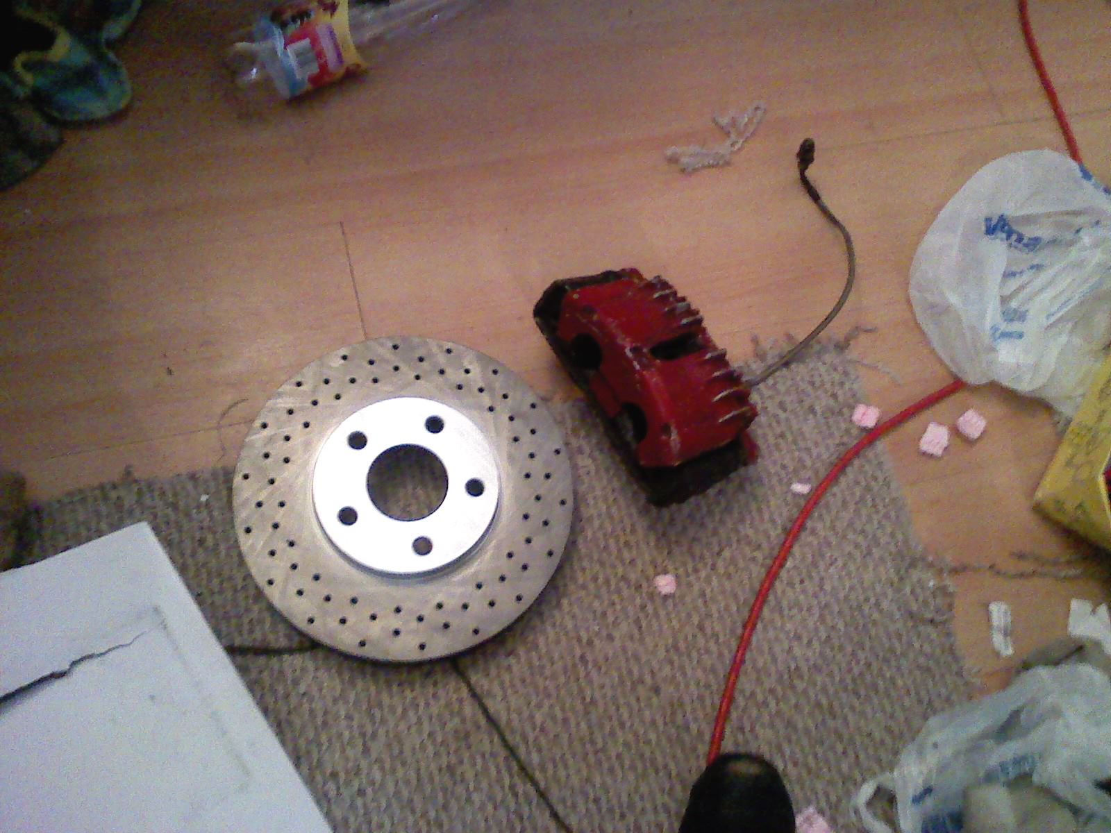

      i have LS1 rotors and calipers but not the conversion kit from brp hot rods yet. I do have a disc master cyl and brake line conversion pieces. planning on replacing the door skins soon as well as both quarters and re-doing the floors but this time with the actual stampings, not with sheet metal i made myself from 16ga hammered into shape.
      love the car, for now its all motor, but someday it'll get all the parts it needs. go to the paved track on ocasion and go in circles for fun, do burnout contests and then when i blow my tires, I swap them and drive the car home.
      no posing here :-) just daily life with 600lbs of torque.

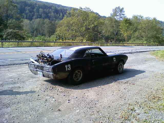

      oh, and the picture with the motor in the trunk was when I unbolted the trunk lid and used the car to haul an inline six 250ci motor for my buddies mustang. All this was done while living in a hotel room for a year with my wife and baby at the time, so that i could afford to buy an $8,000 stroker motor for the thing. seats are all torn up, exterior is terrible, but this is my only running car, so priorities after blowing the 350 up was, motor, and new mastercyl and clutch and other things like belts, hoses, new fuel tank, radiator.

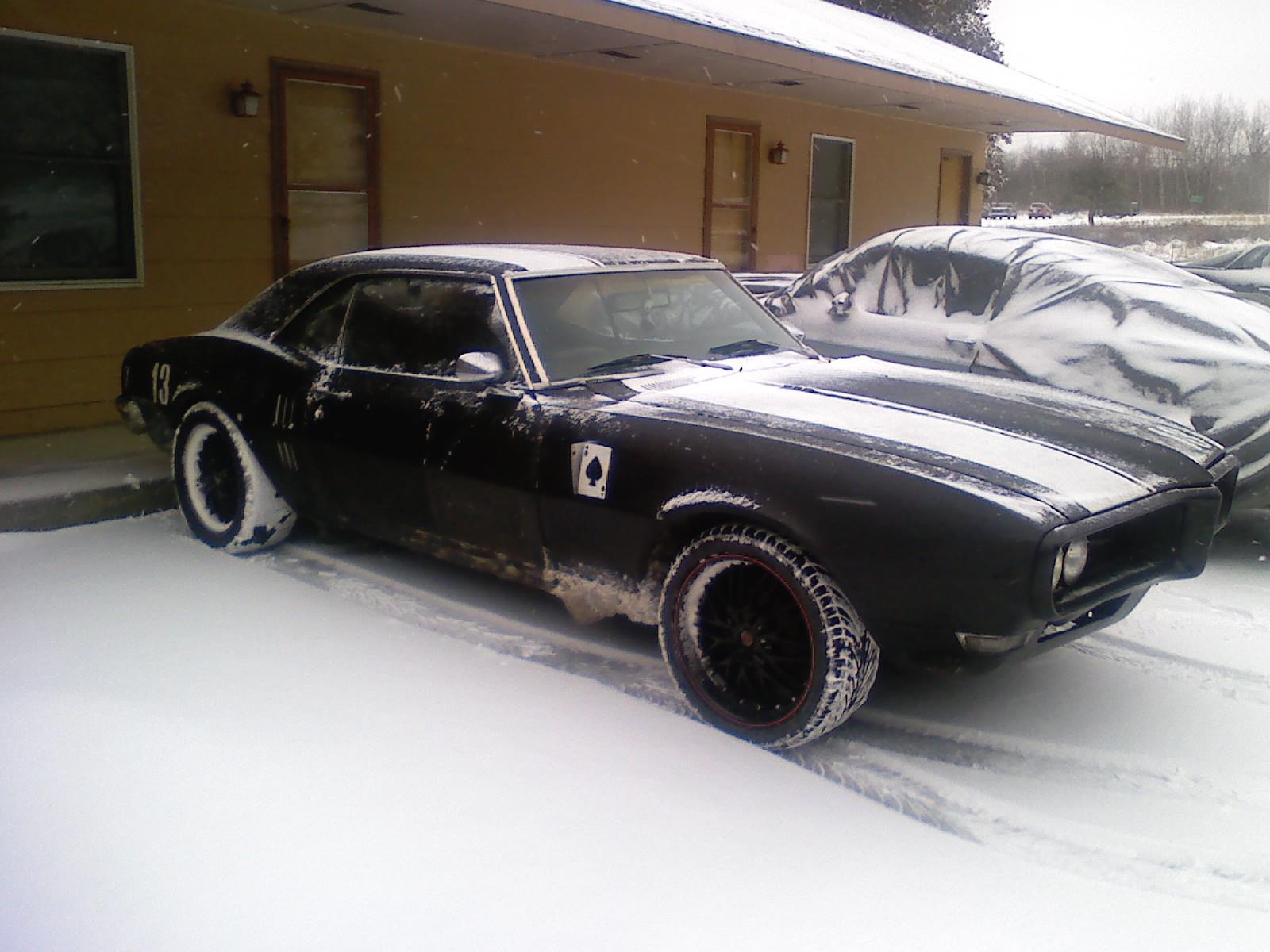

      snow is all kinds of fun :-) And I'm up here in northern new york, so In the summers I have to weld and keep up with the rust. driving in snow is easy, driving this beast in a blinding blizzard is nuts, just nuts. :-) but I don't quite get the guys that say drum brakes are unsafe, been using them to good effect for 2 years now :-)
