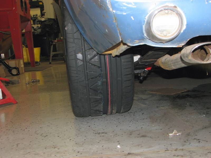

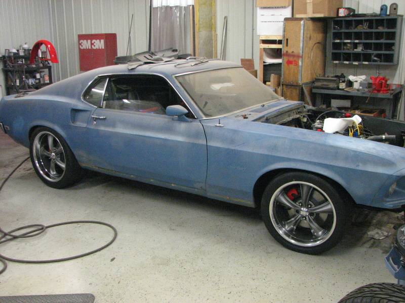

      how close are the dimensions between the ranchero & a regular torino as far as the rear wells? i recently sold my 17's (9.5" wide rear w/ 285/40's) off my mustang & went with a 20x10 in the rear with a 295/35. i sold the 17's to a guy with a 71 torino gt & they fit his car fine, so figured the rear wells must be similar to mine. depending on how close yours are to a reg torino, you shouldn't have any trouble with something that size.
      heres my new setup;

      I'm almost positive that'd fit...I've got one of those Percy's tire fitment gauges on the way to make sure. I had a 295/50r15 shoved up in there for a while, but back spacing wasn't right and the tires kissed the fender lips while cornering.

      Are those 20's all the way around? And what kind of tires are those?

      thanks! just remember that the 295/35-20 is 2" taller in overal diameter than the 295/50-15 was. width should be o.k. but make sure you have enough room in the front & rear inner well where they curve out.
      the percy's tool will help. i made my own out of scrap stel laying around the shop & it has been a big help on the last few cars i've built.
      tires are nitto invo's & the fronts are 18x8' with 245/40's.
