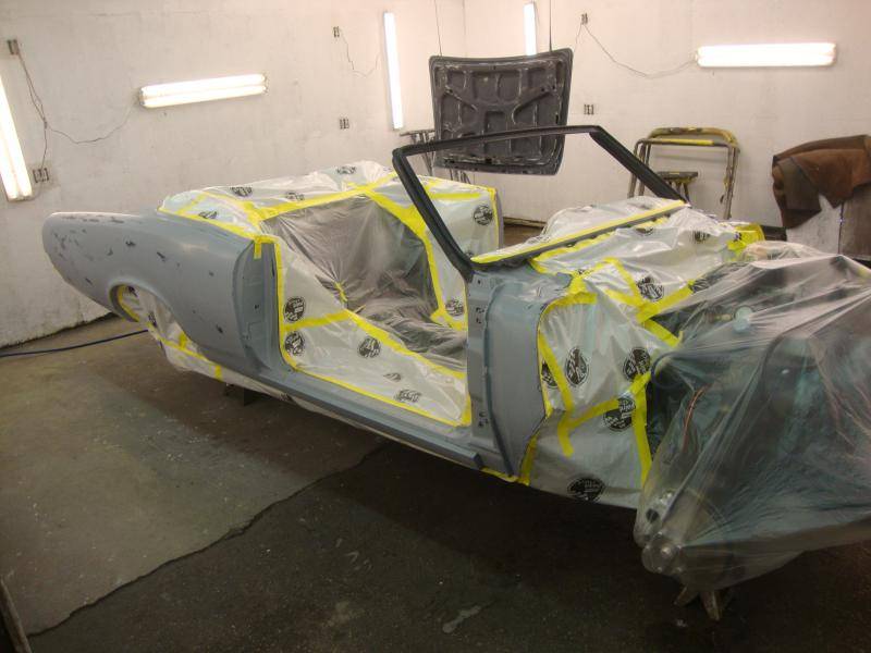

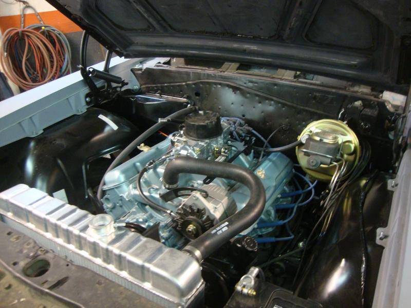

      Making a little engine progress..

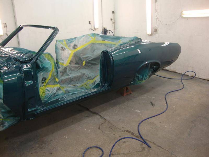

      Very glad to be onto this stage.

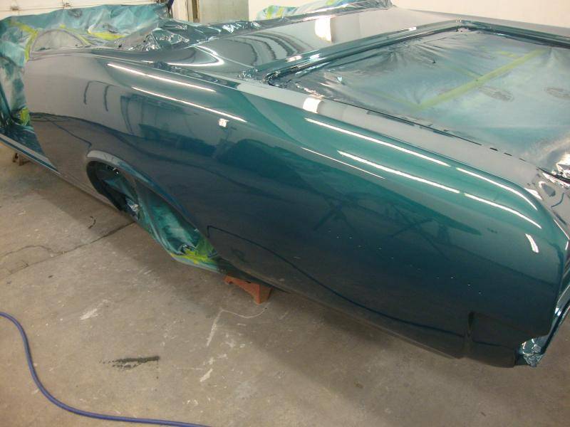

      999
      Paint looks killer.
      What did you put down in the trunk and on the floors?

      Nice job, I like that color!

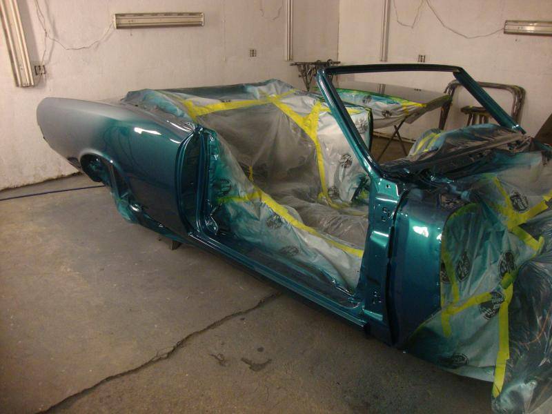

    7. #47
      Feb 2012
      SW, Michigan
      875
      Tropic Turquoise is the color. I wasn't sure if it was a good choice or not but after spraying it I'm glad he picked it.
    8. #48
      Feb 2012
      SW, Michigan
      875
      Night shift is hard at it..
      Just finished RD2.
      Tomorrow is going to be rough!!!!

    10. #50
      7,477
    11. #51
      Jan 2015
      Charlotte, NC
      309
      Dig it..thought it was GM Mystic teal at first..but pops more subtle in the light
    12. #52
      Feb 2012
      SW, Michigan
      875

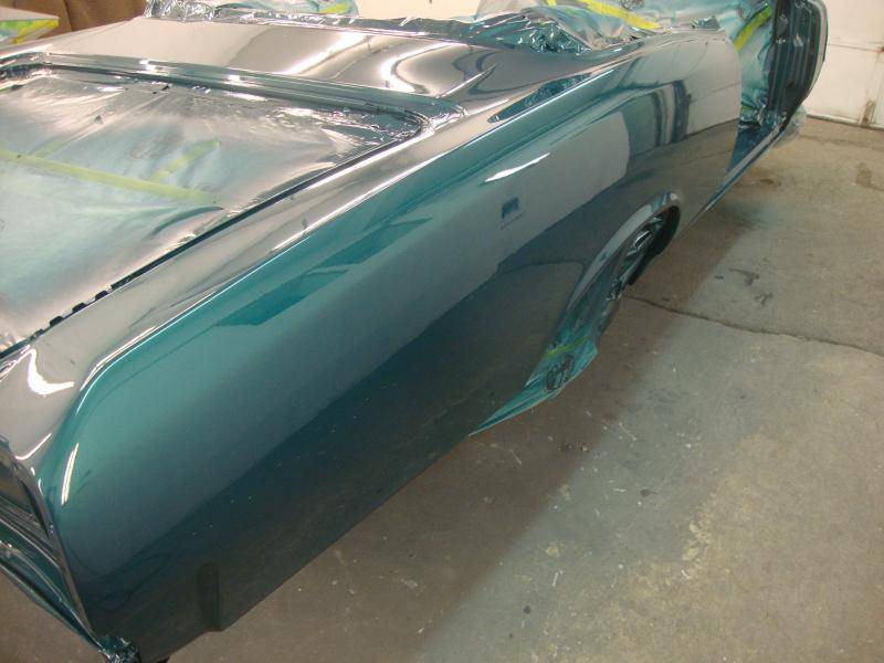

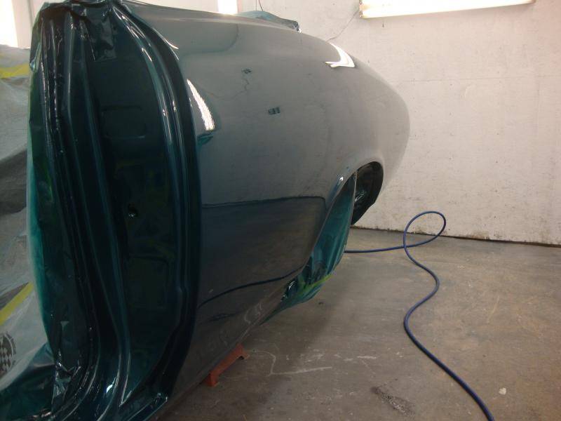

      Thanks guys.. One more round in the booth for color, then one round for the Matte Black pieces.

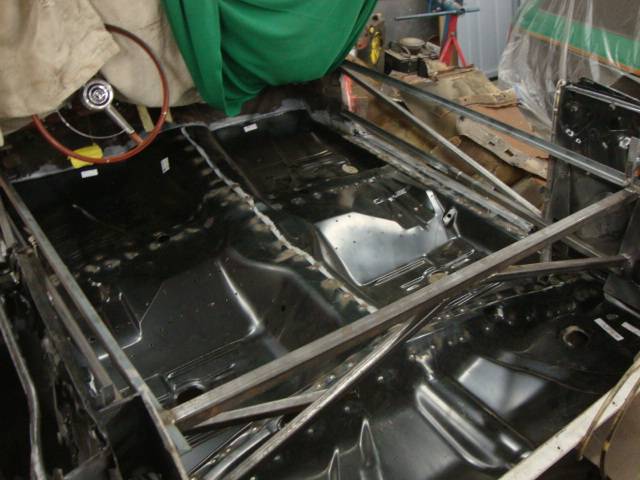

      I've done a bunch of them just on the ground, but I also just picked up a chassis jig and we just put a 57' chevy on it. From now on I think this may be the way to go when completely going through a car.. Espcially if you need the front floor as well.. If not it may not be worth the time to set up a jig..
      I posted pictures in my fabrication thread on here.

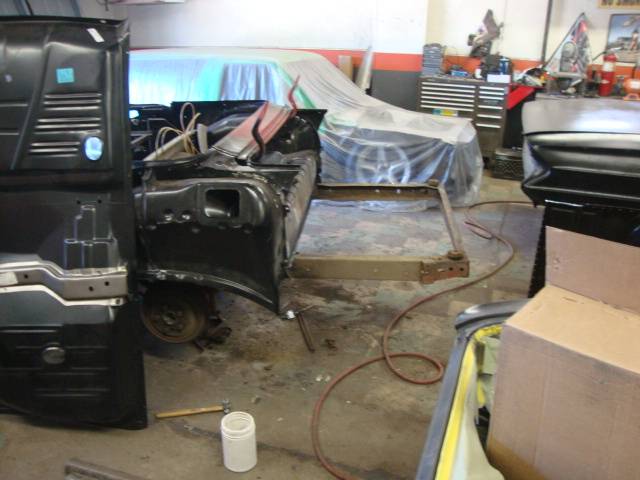

    18. #58
      Oct 2013
      40
      thank you i appreciate it , im just a bit worried that i could screw the car up completely by not bracing it properly
    19. #59
      Oct 2013
      40
      i just checked out your pictures and oh man that is a serious body cart , i have seen people take measurements and also seen some that dont do it when they change out the quarters since there is no way i can get my body cart set up like that which one would you recommend

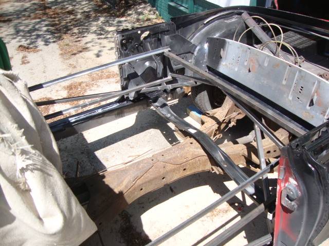

    20. #60
      Feb 2012
      SW, Michigan
      875
      Quote Originally Posted by 67Tempest View Post
      This car is getting a full floor front to back, full inner quarter sections, which means the only item we are leaving alone is the rear trunk hinge and the firewall. At one point, the only thing that will be left on the 57 will be the firewall and the hinge mounting section. so with a build that serious I feel it needs a good jig.
      However I'll attach a picture of another car we did that I didn't do nearly as much work setting it up before we began replacing panels.
      These pictures are from a 64 Impala Convertible that we didn't do all of the jig work, but we did a lot of the work before we took the car off of the frame.
      The jig basically replicates where the frame would be but gives you room to work around.
      However I have re-bodied a lot of Camaro's which don't have a frame without a jig as well.. In many cases you just make the car fit as it is suppose to and move on, I just feel the Jig is a way to speed things up and add another item to the equation to help guarantee that everything is as it is suppose to be. With the Impala I spent a lot of time double checking everything before I welded anything. I won't have to do that as much with this jig. We tend to re-body a lot of cars so I just thought at this point it was a wise decision.
