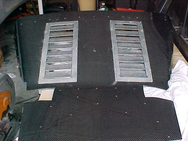

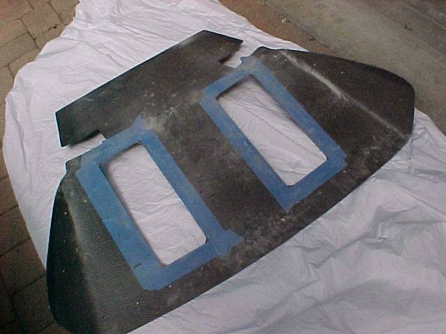

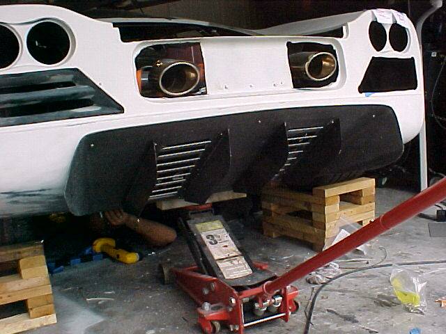

      I finished up the GTM diffuser setup yesterday. As a kit it comes with a carbon fiber diffuser piece molded to somewhat resemble the place it needs to fit and from there you're on your own (which is the case for most of the pieces). I believe the flow straighteners were included in the kit but the vents are from another company. No mounting holes are drilled and no suspension or vent cutouts are done. I'd guess there's about 75 bolts in the diffuser and no way to just measure for drilling because nothing is symmetrical and the body has to be shifted on the chassis. So you can't just measure for center liines etc. The pic below was taken during mock up before the X frame under the trans gets drilled for mounting holes. Painting the inside of the diffuser black will be done after final fitting and cutting/smoothing the outside edge to mimic the body contours. I've gotta take the flow straighteners off and strip some crappy paint someone put on them off before new paint or powdercoat is applied. No decision yet on whether the grills will be aluminum or black.
