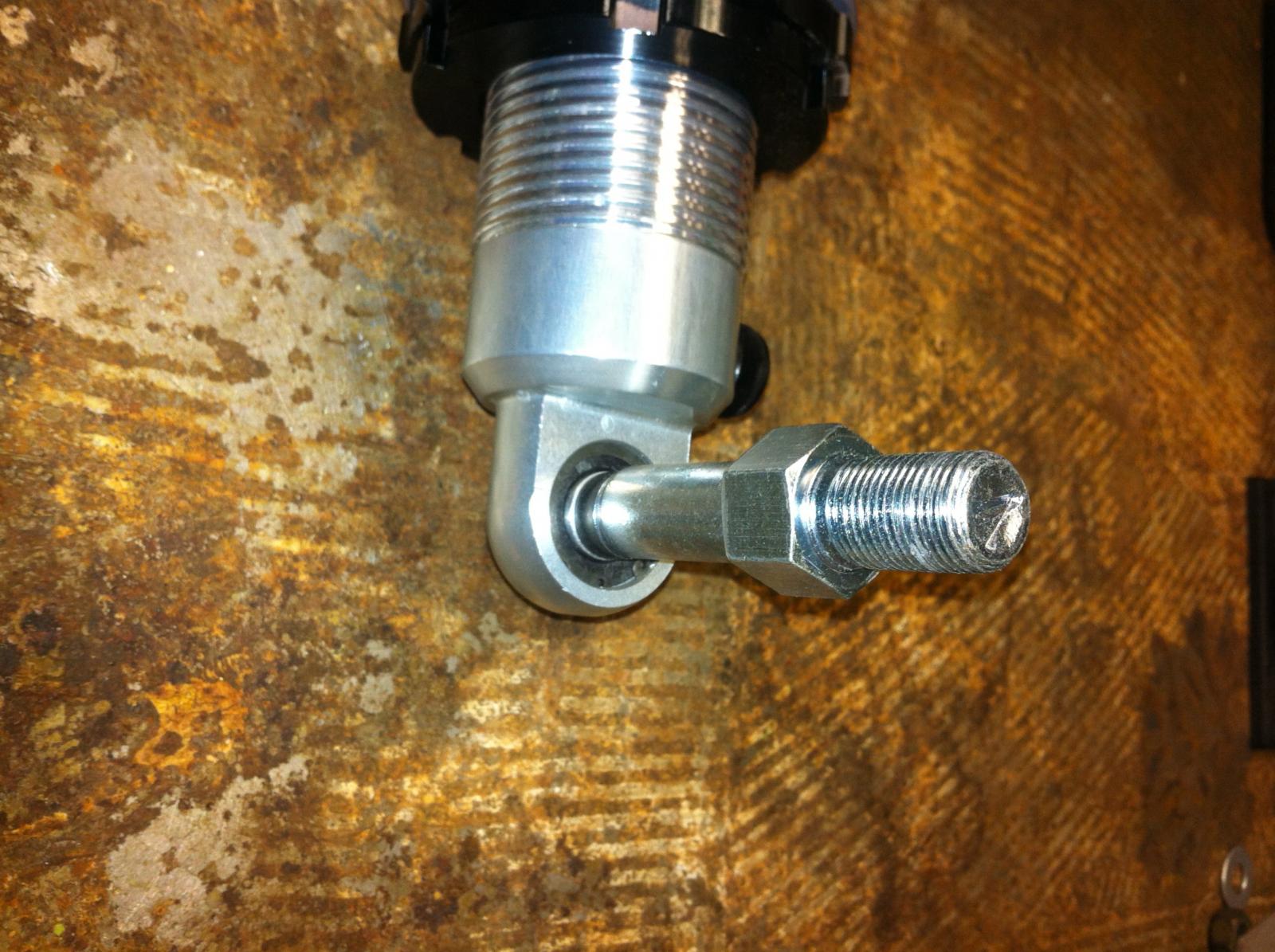

      I bought a Prodigy Bar from Frank back in 2010, which I just got to putting on a couple months ago all to find out it doesn't have the right bushing for the bottom of the QA1 shocks or spacers for the top and bottom bolts. I have tried for the last two months to get Frank to send me the right parts but thats turning out to be a lost cause.
      Would anyone know of the part number for the lower bushing where the QA1 connects to the Axle? If anyone has a couple pics that would help to.
      Thanks

      Thanks, but I have all the end links, it's the bottom shock bushings and I believe I need spacers as well but not sure.
      Here is a pic. Name:  IMG_0993.jpg

      Same thing I posted on Lateral-G:
      Here's the lowdown on an AirBar:
      Upper Mount: 1/2" double shear mount; 1.25" wide
      Lower Mount: 5/8" single shear mount; 1.25" wide (1.375" wide without washers)
      NOTE: Minimum diameter for single shear mount is 5/8" on loaded applications!
      It appears as though the QA1 shocks you have use a 1/2" ID bearing X 1.0" wide.
      Our coil overs and Shockwaves use a bearing with a standard 1.0" OD and a 5/8" ID. We then use spacers /adapters to match the mounting hardware and match the almost industry standard 1.25" mounting width.
      To do this correctly you need to purchase bearings and spacers from us.
      Bearing (if your shocks use a 1" bearing bore):
      http://www.ridetech.com/store/index....roducts.search
      Spacers:
