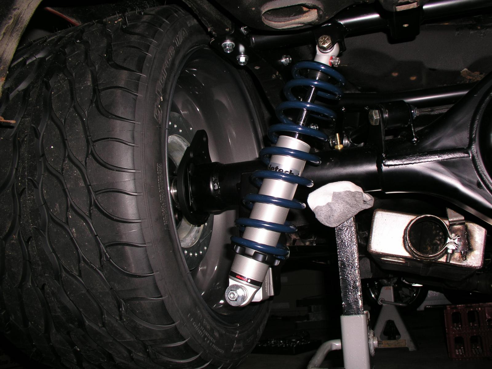

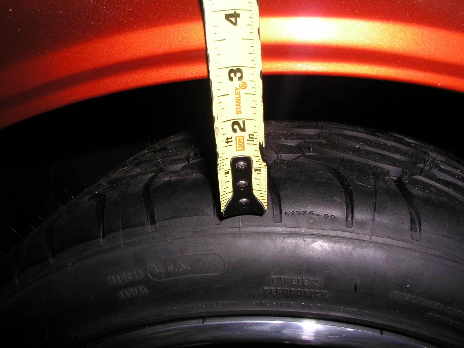

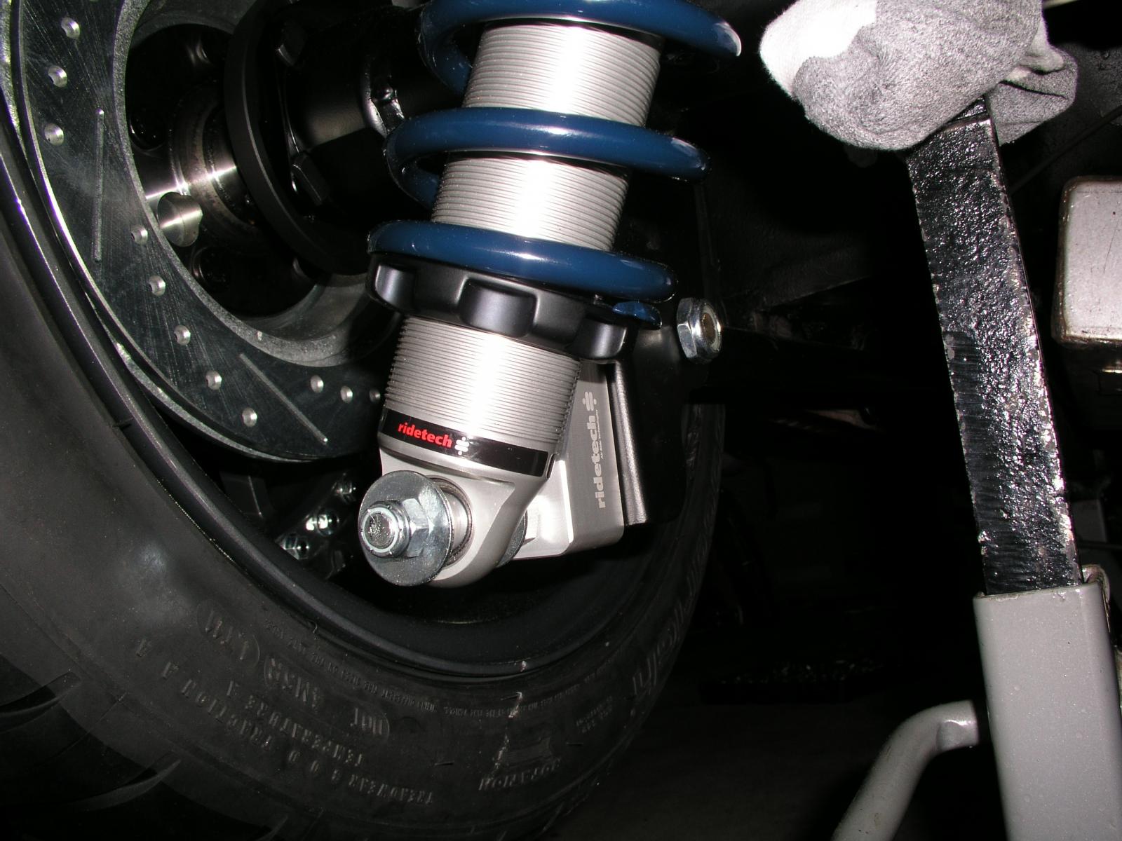

      Car is completely assembled. The only thing that is not in the car is the gas tank but Ive thrown a 90lb fabric roll in the trunk to try and simulate the weight of a gas tank.. Spring rate is 200 which is what it is suppose to be for my camaro and the shock adjustment is set at 3 clicks per the instructions. Here are pics of the wheel at ride height. You can see how high it sits, top of the tire measuring close to 3 inches below the fender lip.

      If your front jackstands are as far back on the front subframe as they look like, all that weight in front of the jack stands is working as a counter balance. You really dont know where you are at until the entire car is on the ground.

      The instructions point out to mount the billet lower shock mount on the 2 lowest holes. According to the pictures you provided, you do not have the mount in the lowest 2 holes. You are 1 hole off. Drop the lower shock mount bracket and your problem will be solved

      Yep that will get the car lower for sure. That should be worth an inch and all of the weight on the wheels and tires should compress the springs 1.5" to 2"....You will be right where you should be then.

      Hey Donny.. yup you are correct.. I dont know why I didnt see that either but right when you mentioned it made sense right away. I never even considered it. So I dropped the front off the jack stands and onto the wheels and did the same for the rear and when I did that it dropped the rear 1 1/2 inches to a total of 1 1/2 inches from the top of the tire to the fender lip. This is without dropping the mount to the last two holes and without the gas tank in place as well. Thankyou to everyone involved here for the info. I guess sometimes you need a fresh prospective on a problem when looking at it. Like I said it totally clicked in my head when Donny mentioned the front jack stands. Never would have looked at it as a counterweight.
