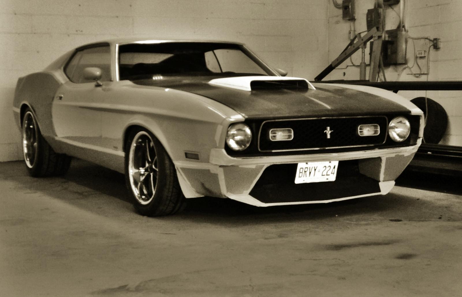

      Finished shapes for the rear of the car so now i moved on to addressing my ideas for the front. I shoot these photos and convert them to black and white so i can get a better understanding of the shapes and proportions i end up with. Make big changes or small tweaks, either way the photos really help the design process since I'm pretty much winging it. I figure i got the final stance very close so now i can figure out how low i can go with the front facia and chin spoiler.

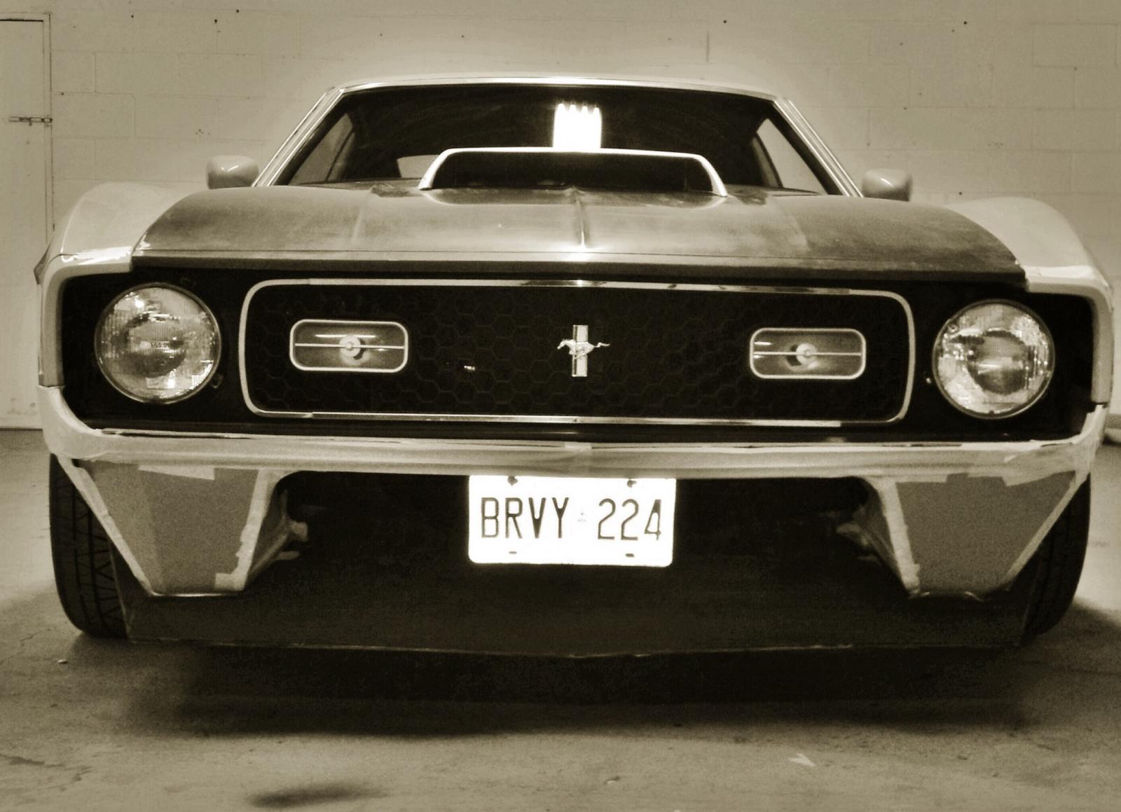

      A work in progress but looks like the direction im going in with the front facia.

      Lower and meaner. Lol.

      Aiming to get the hood scoop and lower valance opening working together for a more aggressive appearance. Making the fog lamps in the grill my new marker lights.

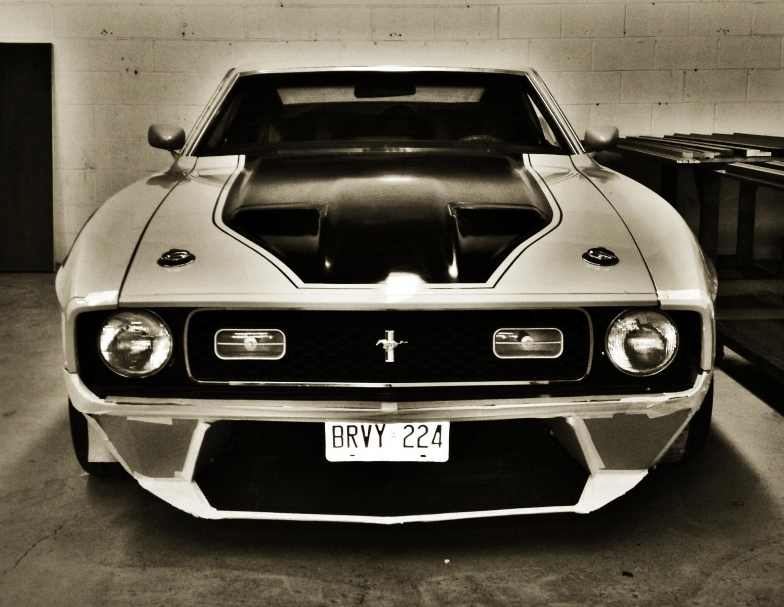

      Put the Nasa hood on the car and it naturally looked so good that now it lives and the shaker is on the back burner. Name:  photo 1.jpg

      A few changes to the front opening
