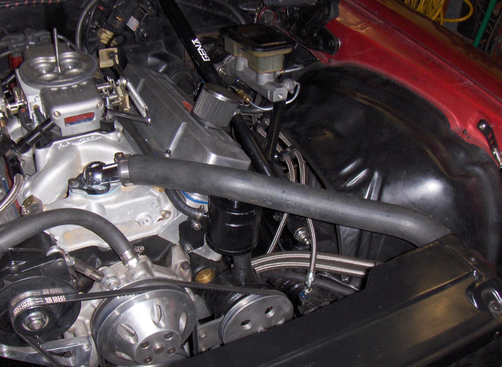

      I used the straight version on my Camaro and am happy with the results.

      I'm not sure of what the mc is off of but I can say it's a little too touchy so I need to change they bore size. I have the factory astro mc and will most likely try it with my C5/LS1 brakes. I modified the mounting bracket slightly by trimming some excess and flipping the booster over. I also had to adjust the length of the rod to the pedal.
