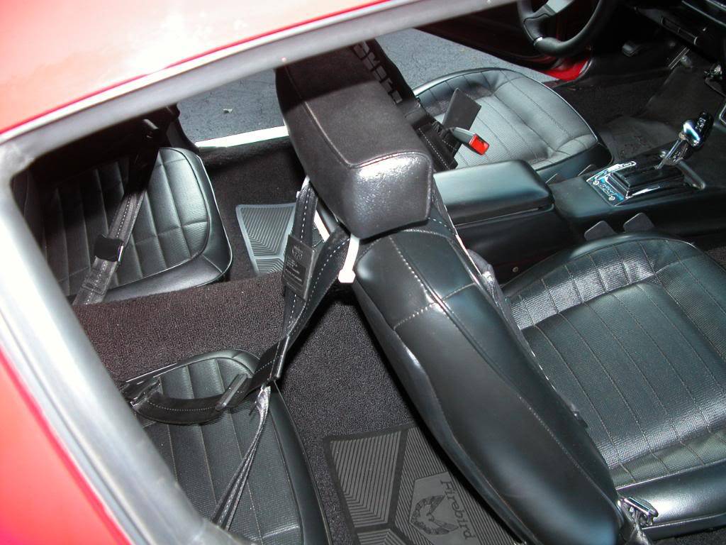

      I used the Schroth 4 point Rallye harnesses with ASM in my car. At the time I had OEM seats similar to the Pro Car Rallys. I'm about your height and they worked fine for me (never crash tested thankfully). Because of the ASM feature they do not require a fixed back seat like most 5-6 point harness manufacturers recommend. The 4 point Rallye harness is designed to allow controlled body movement during an impact while the 5-6 point harnesses are typically designed to have very limited body movement.
      When I first installed the Schroths I also kept the stock seat belts (lap only) but quickly found myself using the schroths exclusively so I removed the stockers. The only drawback I noticed was that the schroth shoulder harness wanted to slide off the seat and fall out the door so as you can see in the pic below I used a zip tie just to prevent the belt from melting on my side pipes.

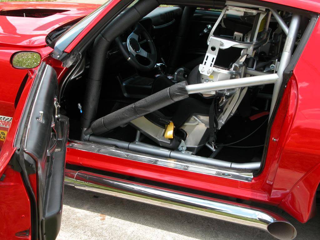

      A fixed back race seat with back support to the roll bar combined with 5-6 point harness attached to a harness bar of a roll bar will offer more protection. I started spending more time on road courses and going to land speed races so I put safety equipment in my car for ludicrous speeds. I've had several brands of harnesses in various cars but I liked the Schroth Rallyes so much I bought their 6 points when I switched setups. Also very happy with their 6 points.

      Thank you so much for the input! The information (and bonus photos) you shared is exactly what I was to figure out. I'm still a bit undecided, but I'm leaning toward the setup I mentioned earlier until such time as I start spending more time on road courses. Thanks again!
