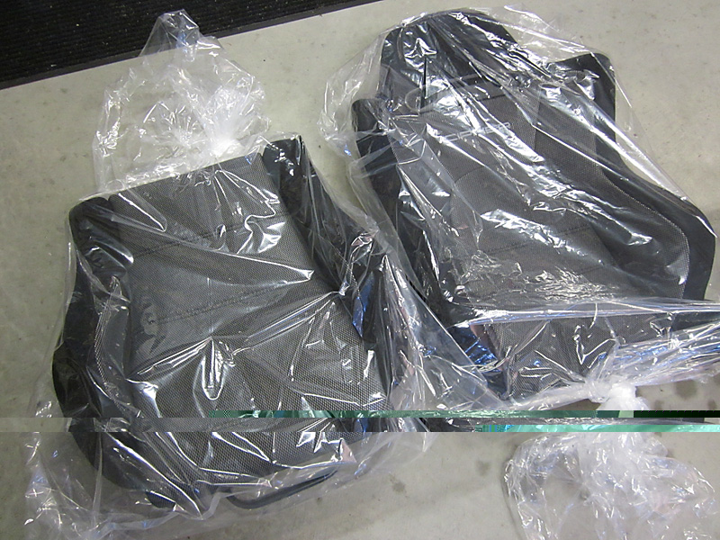

      Unpacking the E-8 seats

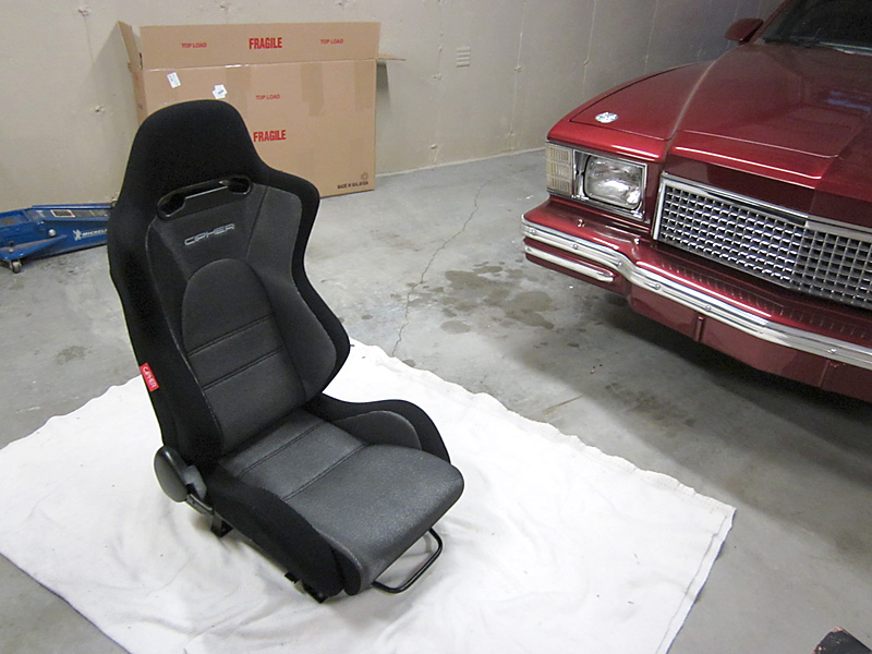

      Here are my current Cipher seats, which were great, but I wanted a little different style of seat.

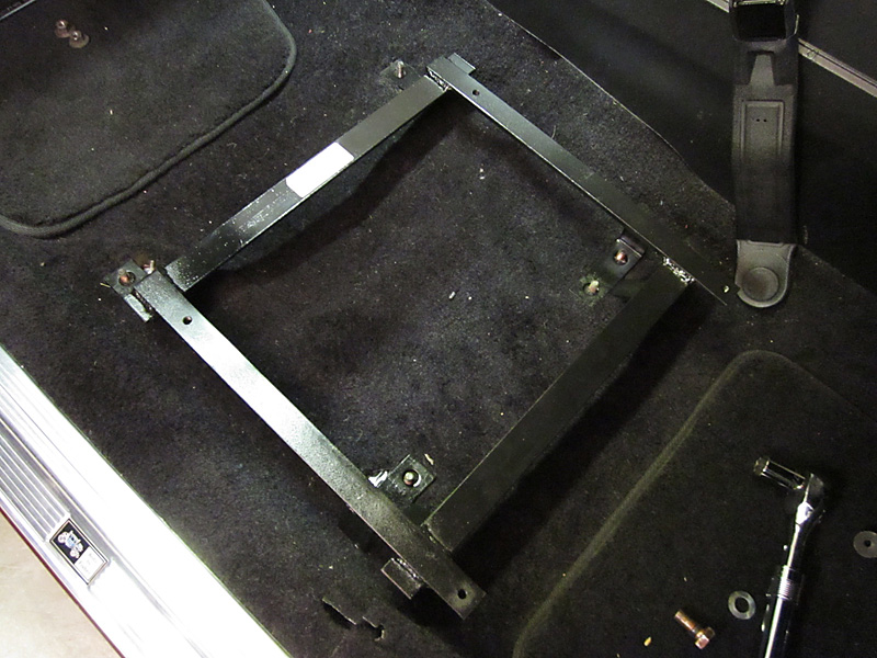

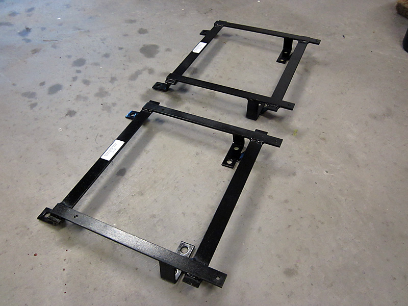

      These are the new brackets that allow me a bolt in installation.

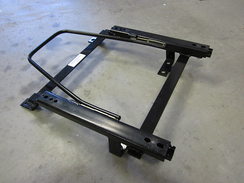

      Sliders are attached to the mounting bracket
      Slider and bracket assy mounted to the seat bottom

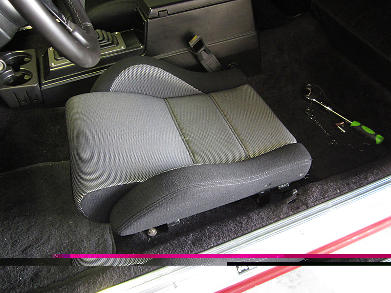

      Seat base bolted in (I would advise putting the whole seat together before you mount it in the car)

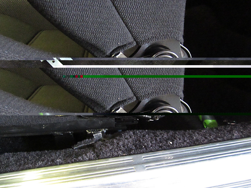

      Close up of the lever. You can recline or fold the seat all the way forward. Grade 8 hardware is used for seat assembly.

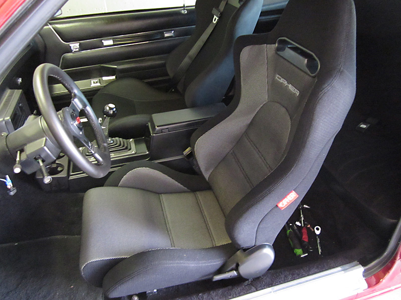

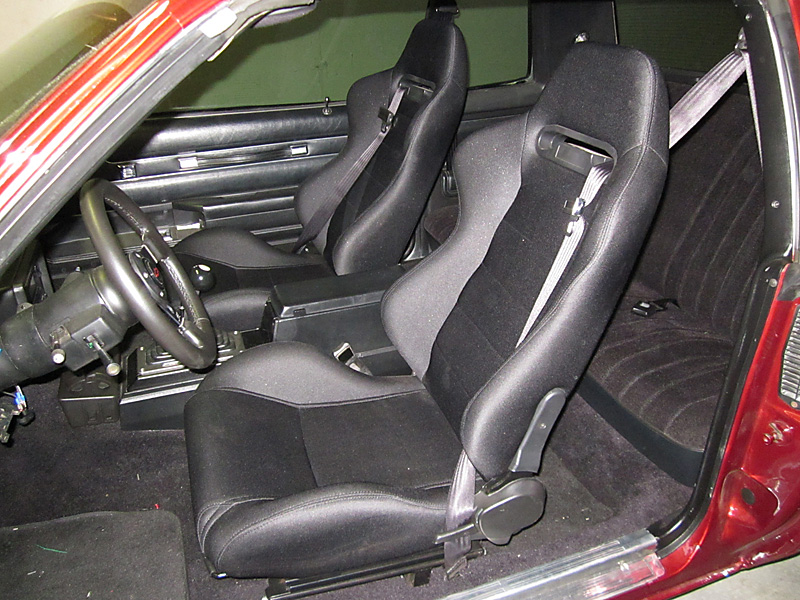

      Drivers seat installed
      This time I assembled the passenger seat before I dropped it in... much easier.

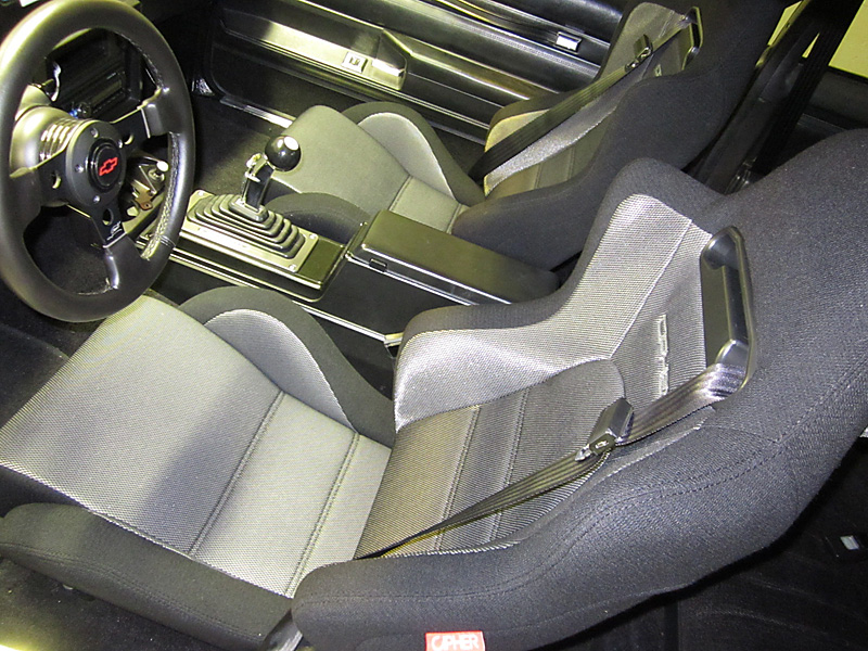

      Both seats are mounted with seatbelts threaded through. Not to take away from the other Cipher seat models, but the E-8 seats are outstanding and fit me perfect.

      Marc, sorry you had a bad experience with Wedge.. these are their brackets. The quality and fit is great in my opinion. I would suggest not getting their adjustable brackets unless you are 5'7" or shorter as they put the seats up too high. But the brackets shown in my install worked perfect for me.

      Seats look great....nice idea, threading the stock belt through the top, neat.

      You can see I originally had the adj brackets. They set my seat up about .5" higher than stock.. which was ok for me. Now with my new seats, I got the flat brackets which sit the seats lower to the floor by a couple inches.
      I would get the flat brackets for you since you're 6ft +.
      Yes it sets the belt right where I want it on my shoulder.. not on my neck. And when the kids need to hop in the back I can just use the seat lever to bring the belt forward so they can get in easily.

      Figure about 2.5" tall for a flat bracket, .5" for the slider and 35.5" for the seat, so a total height from the floor to the top of the seat would be about 38.5"
