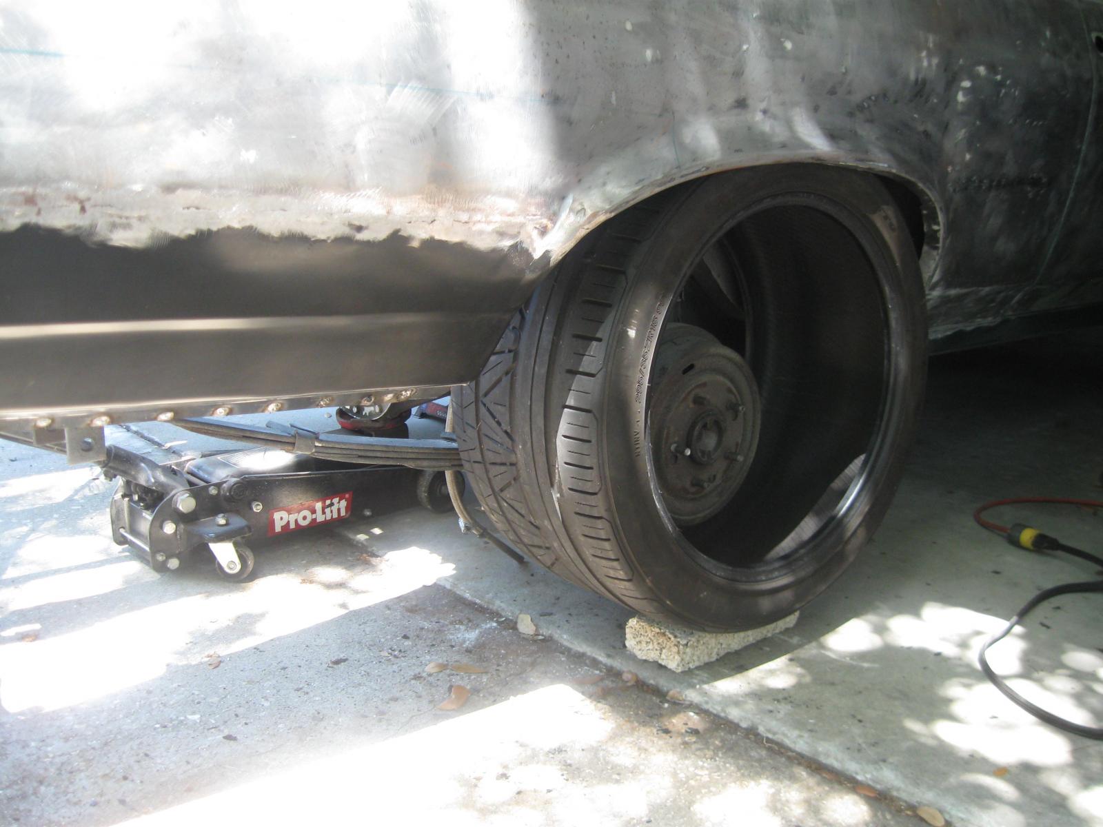

      it fit up there pretty good. the only thing i need to move is the spring mount. and get rid of the slapper bar.Name:  11 inch wheels 002.jpg

      Quote Originally Posted by 69-nova View Post
Size:  176.8 KBName:  11 inch wheels 004.jpg
      You are taking body and tire roll into consideration, right?

      Apr 2012
      86
      yea. once i roll the outer quarter lip it should fit fine. im not say 100% yea its going to fit for sure. but it looks like it should work.
      Dec 2008
      Detroit
      2,665
      I would definitely suggest you take a look at some of these nova threads. Last thing you want to do is spend lots of money on tires that you end up destroying. If you are truly building a car for pro touring and not straight line you must measure twice...lol
