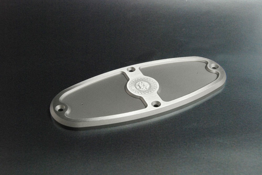

      mine did the same also, so i just bought one of these www.digi-tails.com
      they have 3 different designs

      I saw those when I was looking for the Wilwood part number. They are from Marquez Design, and look great.
      Wilwood is hooking me up with a replacement cover and seal free of charge, and I like the black cover with the aluminum MC. It goes well with the rest of my car, so I'm happy to keep the Wilwood cover, but thanks for the link.

      i also like the wilwood one but i was afraid it would ruin the paint on me again so i eleiminated the probhlem once and for all.
      no worries about the link.

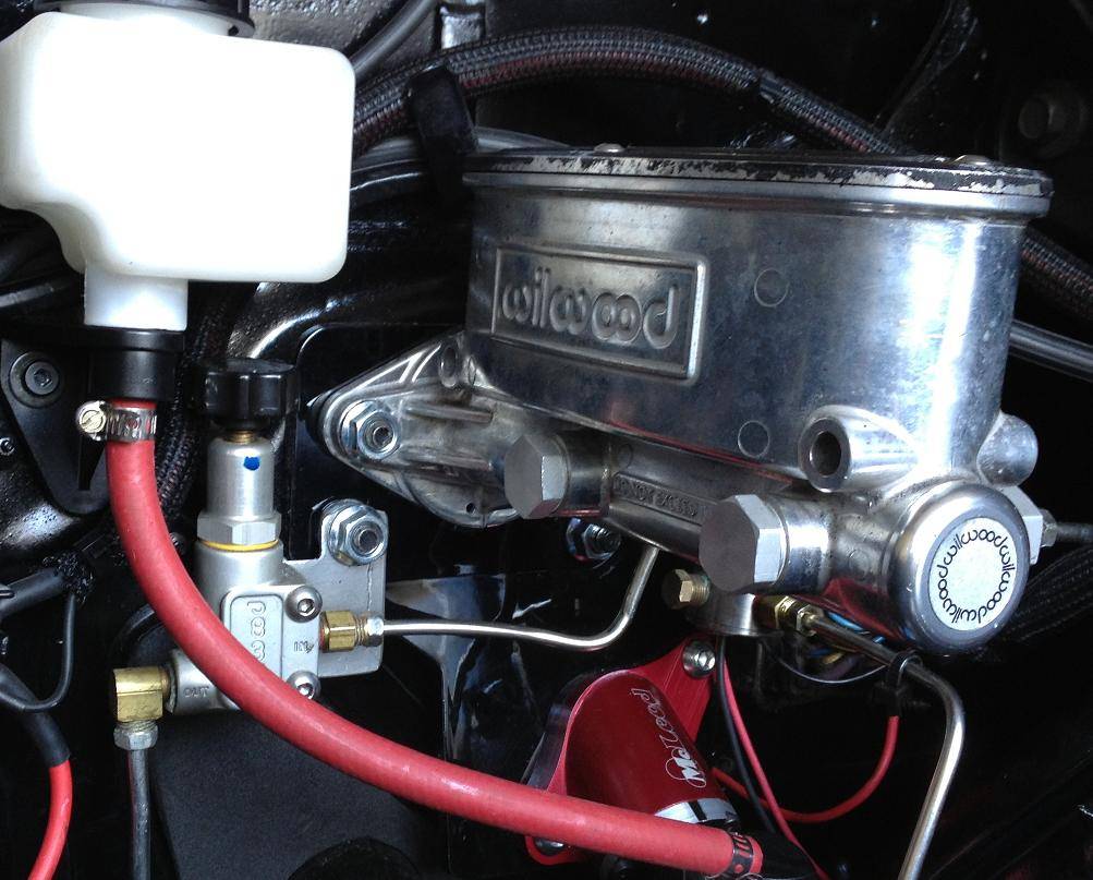

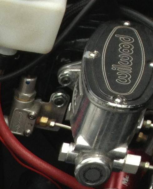

      I got home today and found a package from Wilwood. Thanks Michael for taking care of me. As promised here are pics of the old, new and old vs new. The new cover has a little more "grain" to it, which I prefer. Also the lines of the lettering a little thinner which gives it a crisper look. For future reference, the part numbers are 330-8573 (cover) and 210-8458 (diaphragm).
      Old:
      New:
      New vs Old:
