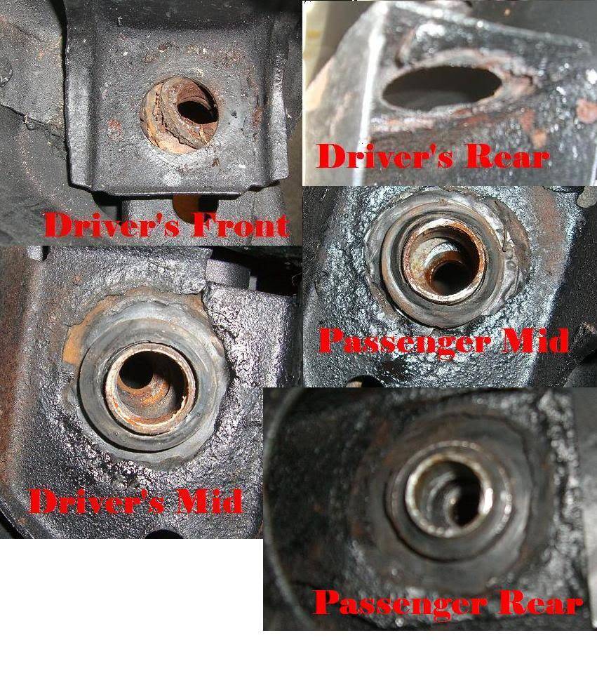

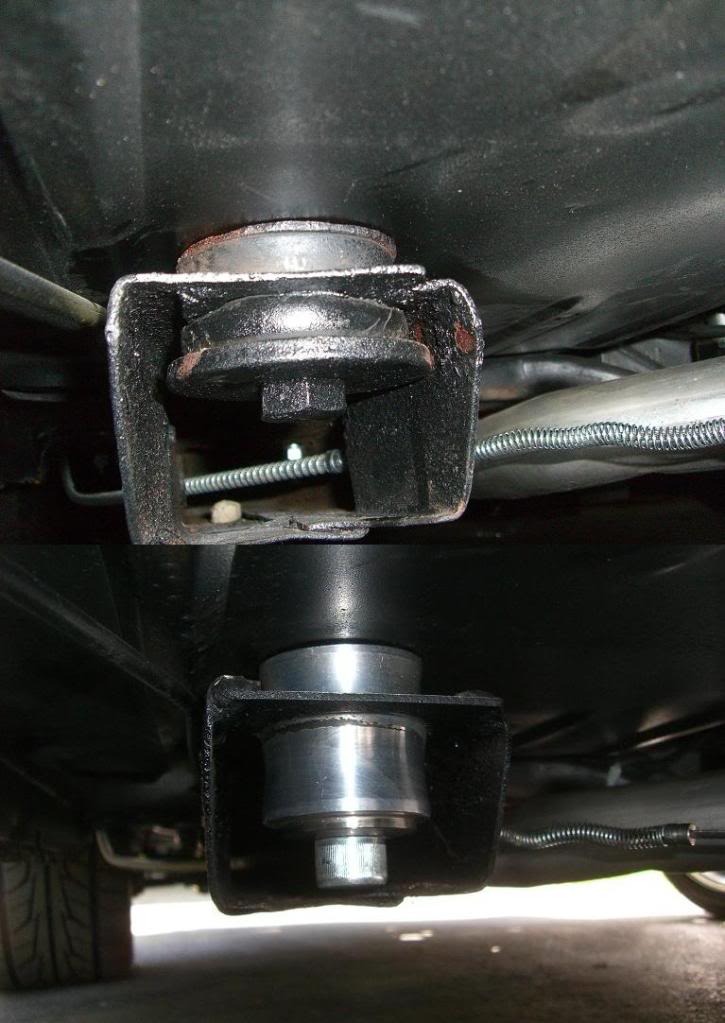

      Most of my mounts were rotten. I can't weld, so I brought it to the shop and they were able to weld the new full plates in while the subframe was still on the car, and they welded them in from the bottom.
      Here's what they looked like:
      And here's a comparison of the old vs new mounts:
