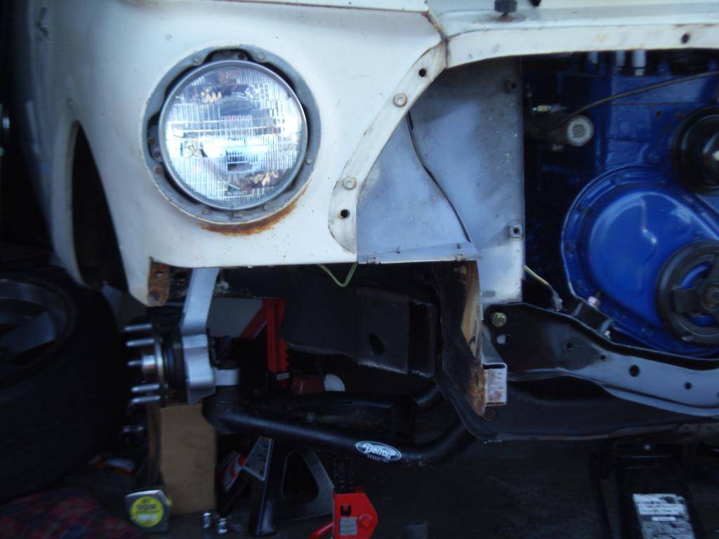

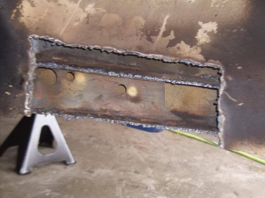

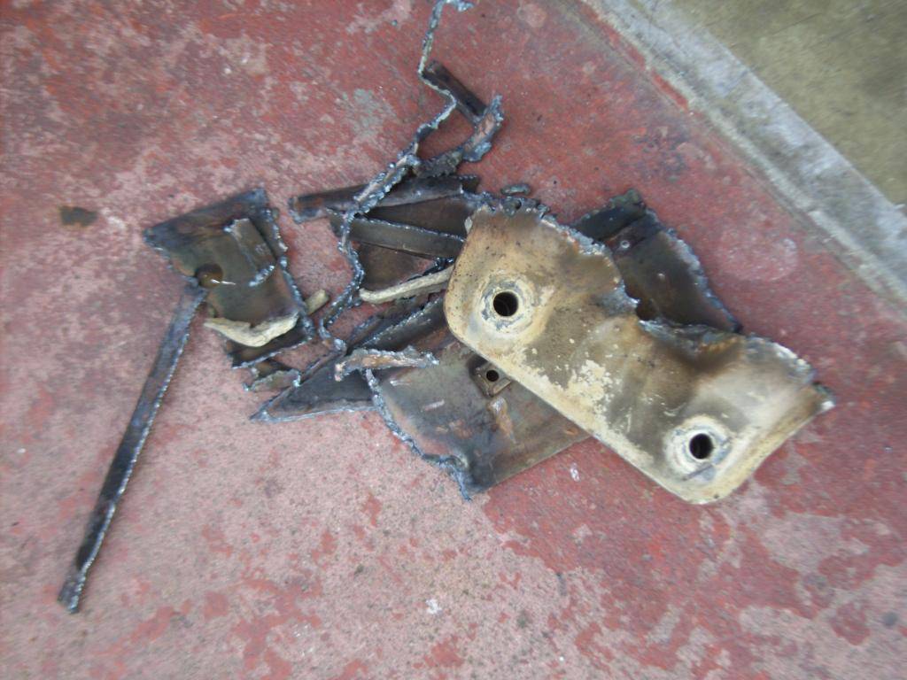

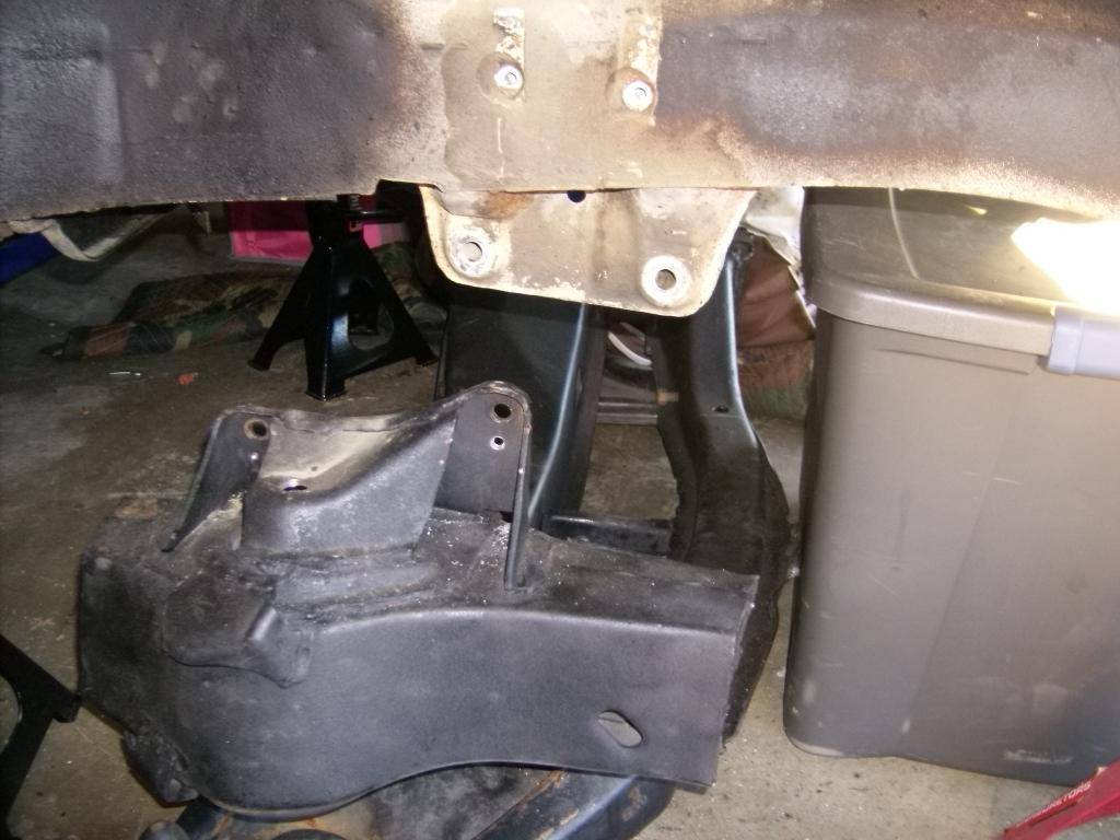

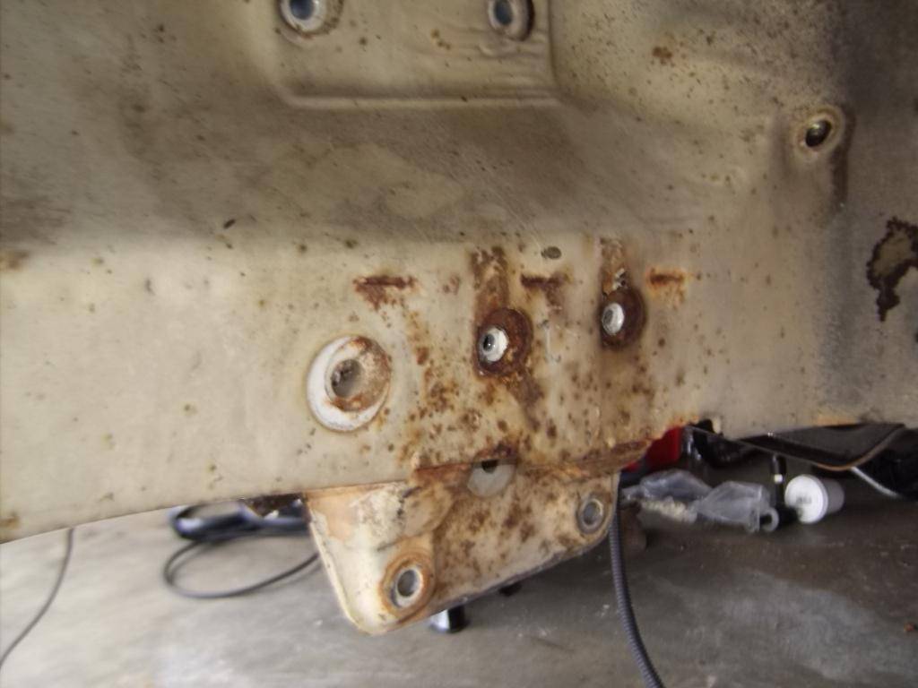

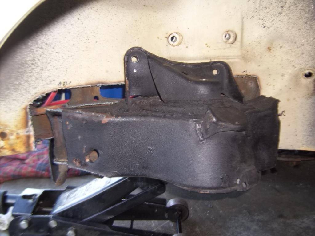

      in order to get a Camaro frame into a 1963 unibody rambler
      the outer frame skin and lower factory arm mount needed to be removed after careful measurements
      heres the aftermath and some rough cutting done with a plasma
      basic test fit and then its time to clean up the fit and all the edges of the cuts and slices
      time to assemble the basic parts to get angles and clearances
      more later!!!

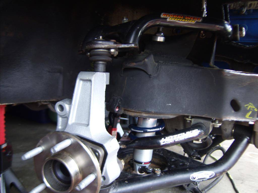

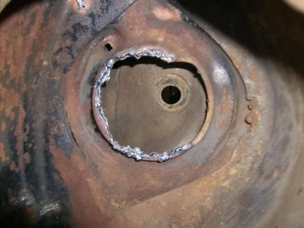

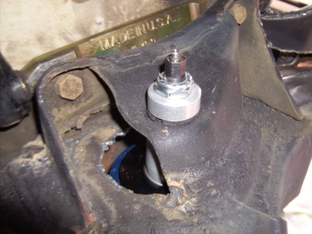

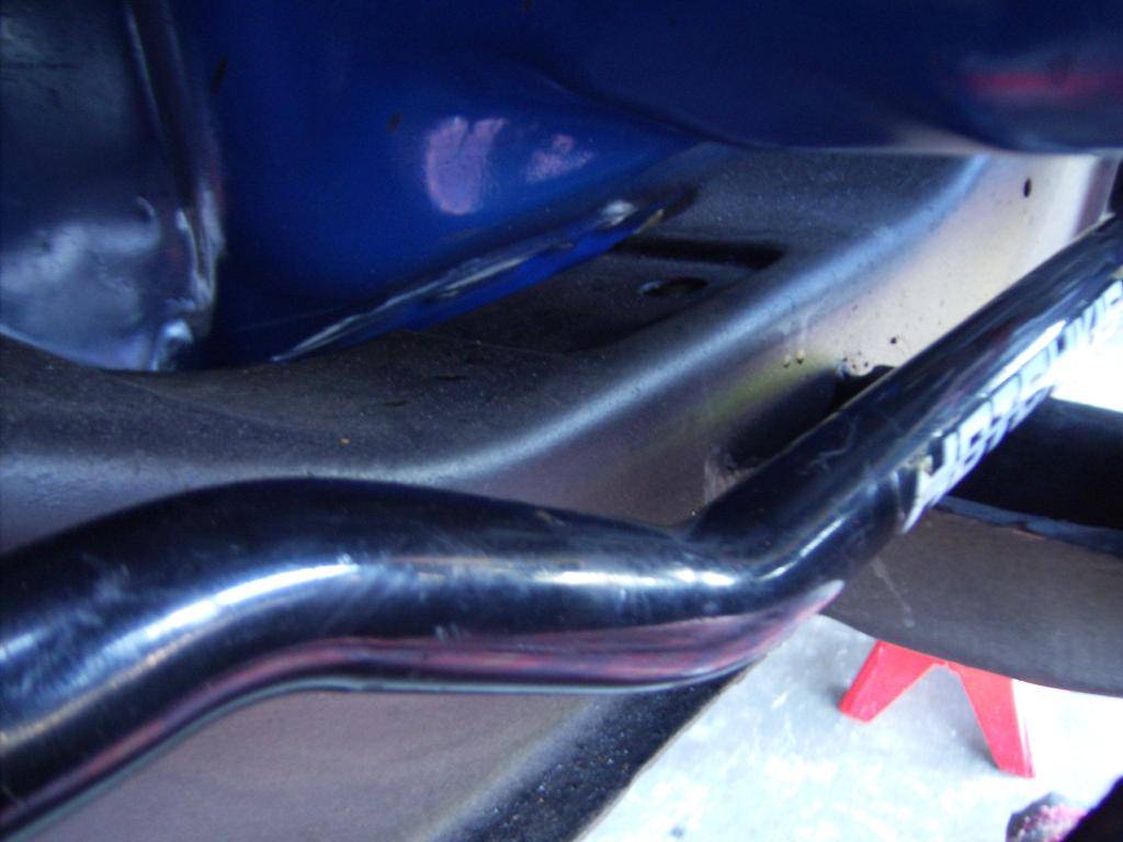

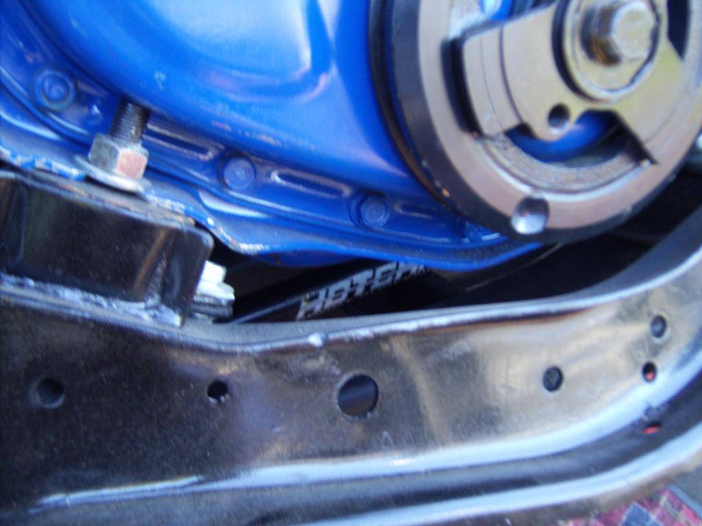

      OK, now that the basics are done and the frame is just tacked in, its time to add some coil-overs and see if the ride height is good. It was determined after trying to fit the coil-over into the frame, that the upper part of the frame had to be cut out.
      back to the plasma cutter
      then fit the ridetech coil-over shock and Hyperco springs

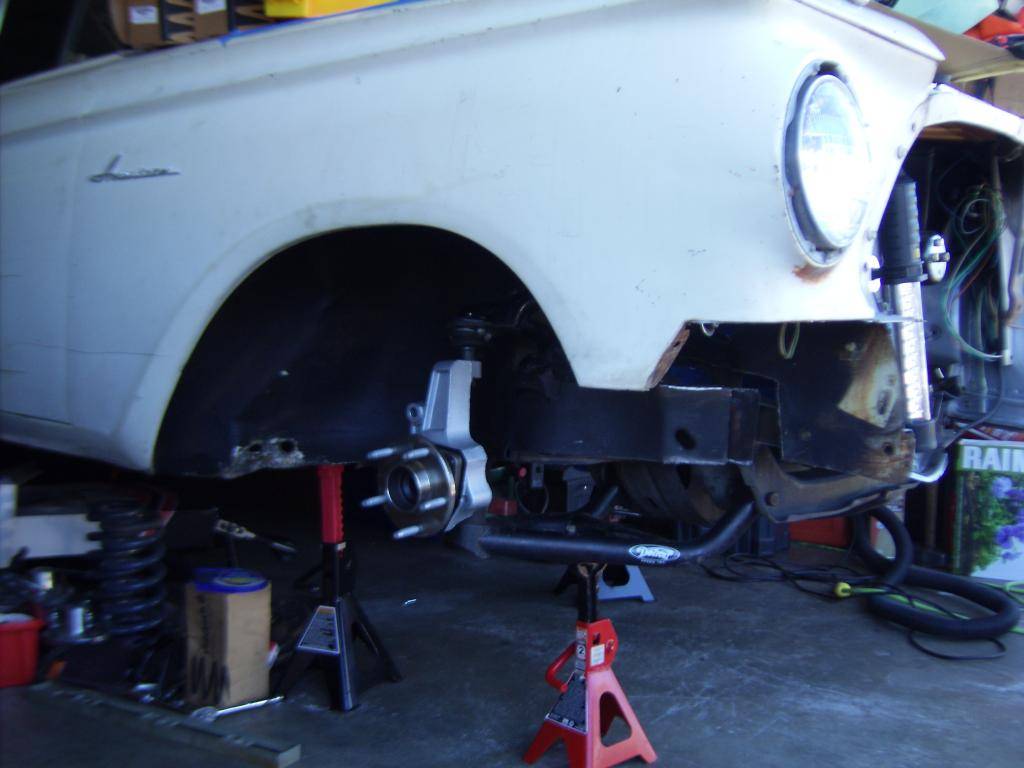

      Trial fitting the Hotchkis swaybar, fits like a glove right under the 1963 rambler motor as if it was made for the car!

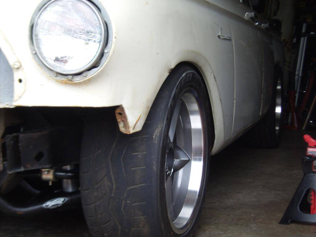

      After adding wheels and getting the car down on the ground... the ride height looks great!
      Just for the fun of it can you guys name all the different companies' components on the front suspension? I've given you a few hints, but see if you can figure out the rest.
      I'll figure out something to send to the first person who gets every single brand shown - a vendor t-shirt or some kinda swag that I've got in my arsenal.
      I need to confess (and give credit, where credit is due) that this work has not been done by me, my Mister Rod has been generous enough to spend long hours with the plasma cutter I gave him for his birthday to get this front end worked out. (Don't even tell me that you've never given your other half a gift that worked to your benefit...) I will be heading out to finish up electrical and some interior work this weekend.

      No Rod you can't guess! Nobody else has tried?
      DSE lowers, Global West uppers, Hotchkis sway, ridetech shocks with Hyperco springs, CPP spindles, C5 hubs, Coys/MB wheels, and Falken tires. There are too many options for tall ball joints and hard to compare different features so I'll just say they're one of the many options for tall ball joints available. Does that count? You mentioned Wilwood brakes earlier but they're not there so I won't say nuttin. ...and you need a Speedtech key chain.

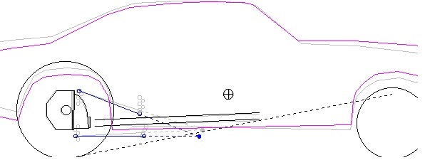

      I scrapped the suspension almost completely (front and rear) and changed the four link design in the back closer to a computer model....built around the 100 inch wheel base car and the current akerman, and control arms anti-dive
      in the real world.....you can see the lower and upper arms now match the model exactly

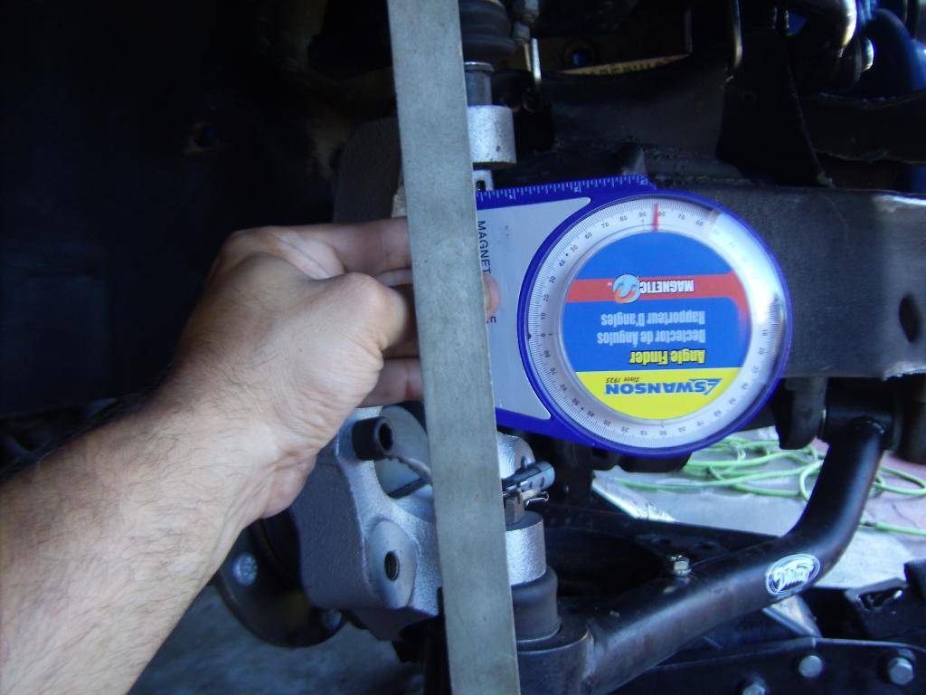

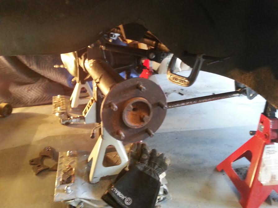

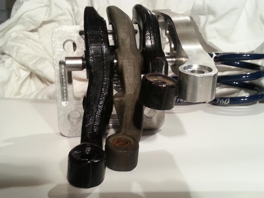

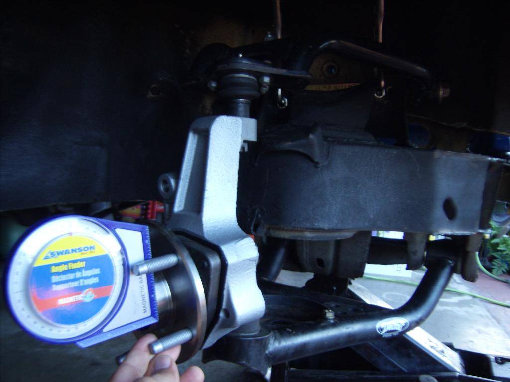

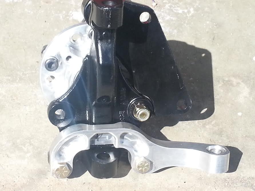

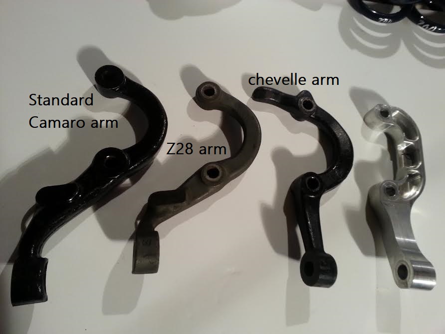

      for the front suspension!! I kept the camaro sub frame but couldn't get the akerman correct for the wheel base, and couldn't get the desired camber curve with the cpp spindle even after adding a tall ball joint ..... so I switched spindles
      standard steering arm, and a short z28 arm also tried the chevelle arm
      custom billet steering arm reduced bump steer and correct akerman
      looks great on mock up and on the suspension cycle test

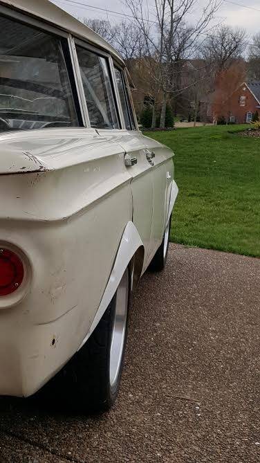

      teaser shot!
      suspension is IN! .....next up FLARES! to hold 10inch wide rims, first a few glamour shots and then back to the garage, pull the engine and cut out the firewall to get the car balance better
      spy the custom made Flares!!
