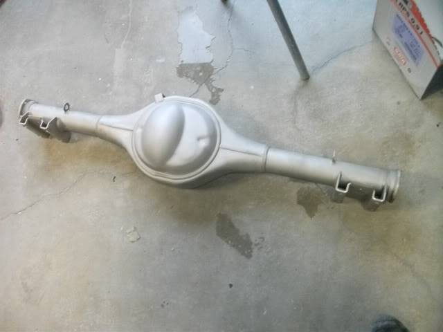

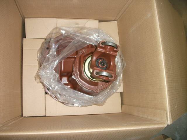

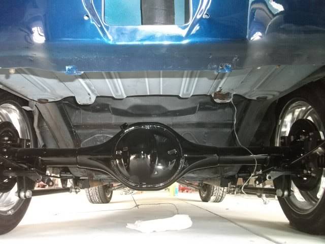

      Had a 61" wide open diff, 12 bolt with some old school biggs and littles. I just placed the order for a brand spankin' new bolt in 9" from 9inchfactory.com. 55 5/16" hub to hub. 3.75 gears, aftermarket axles, ect.

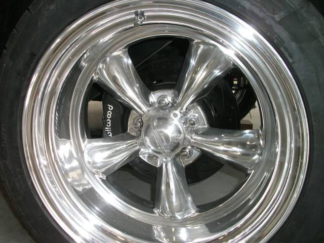

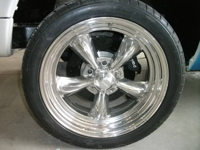

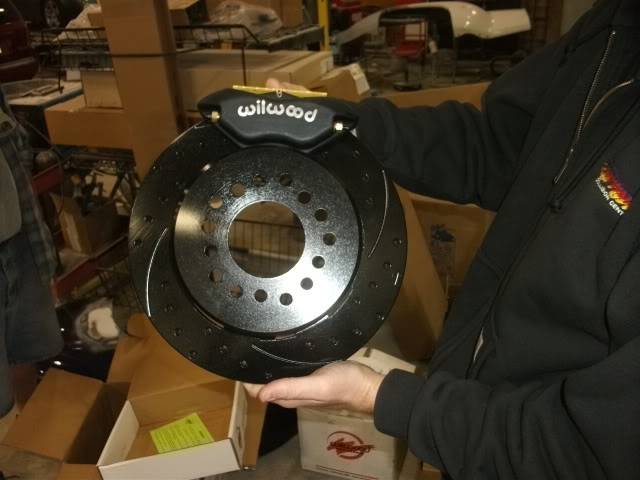

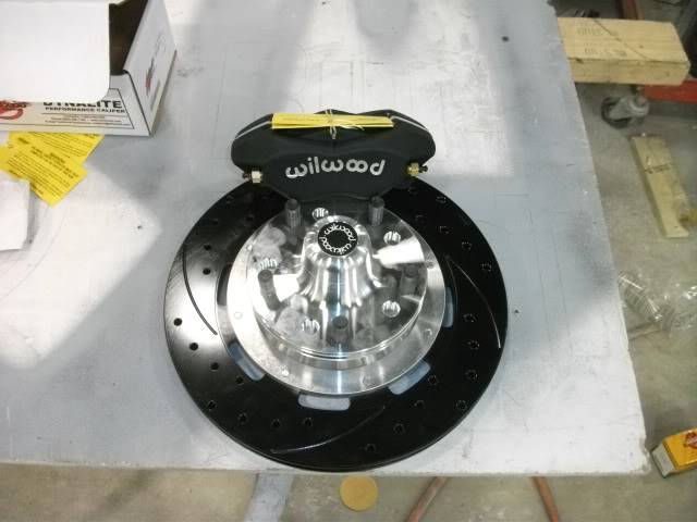

      Brakes all the way around will be drilled and slotted wilwood dynalight 12" disk setup. 2" drop spindles will go on first to see if it can get the ride height we want. If not, then it will be getting coil overs and most likely tubular A arms. Power booster/master cylinder.
      Mono springs with cal-tracks is about it for the rears.

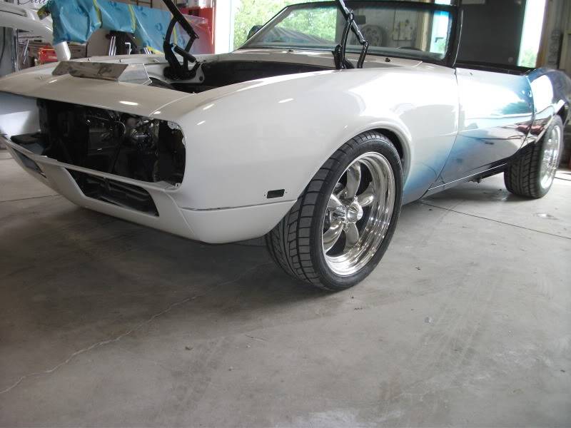

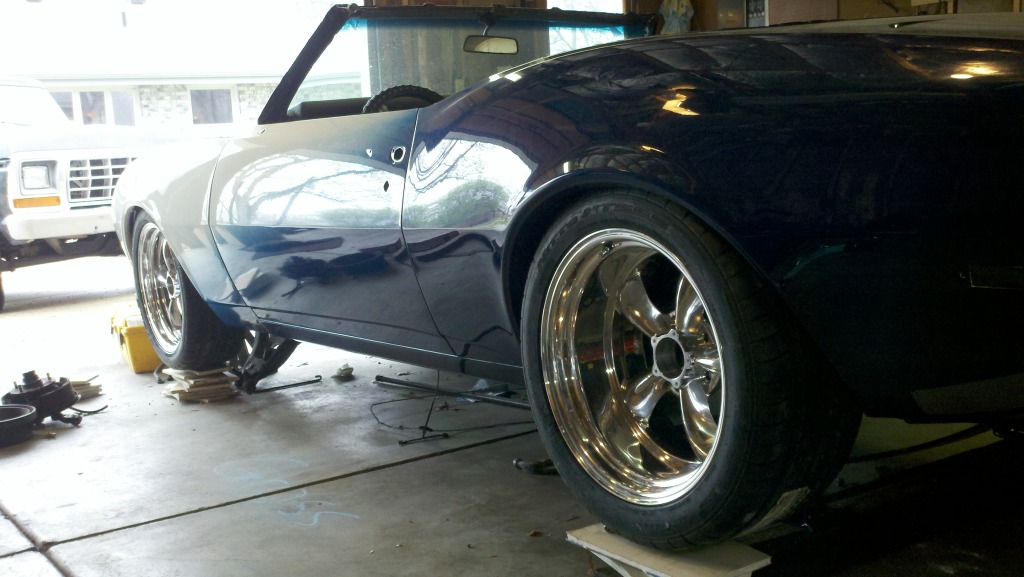

      As some of you have seen with the wheels. I did lots of research for the biggest tires i could fit. the 67-68 quarters are 1.25" narrower than the 69's. With an unmodified tub and quarters, the biggest to fit in the back is 18x9.5, 3.75" b/s with a 275/40/18. Fronts we went with a 18x8 with 5" b/s and 245/40/18. NT555 extremes all the way around.
      Wheels just showed up yesterday.

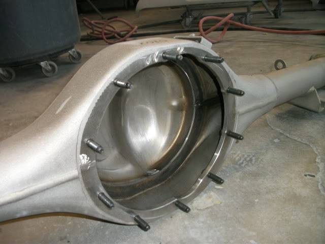

      3.75 gears, trac-lock, all new.

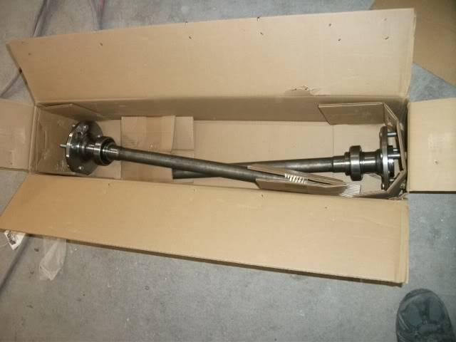

      new 31 spline axles
      brand new housing, right at 50.5"

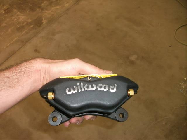

      Dynalight 4 piston calipers all around
      Rear brakes
      I put the fronts together tonight
      Hopefully get the car rolling this weekend, or at least get the front wheels on the ground.

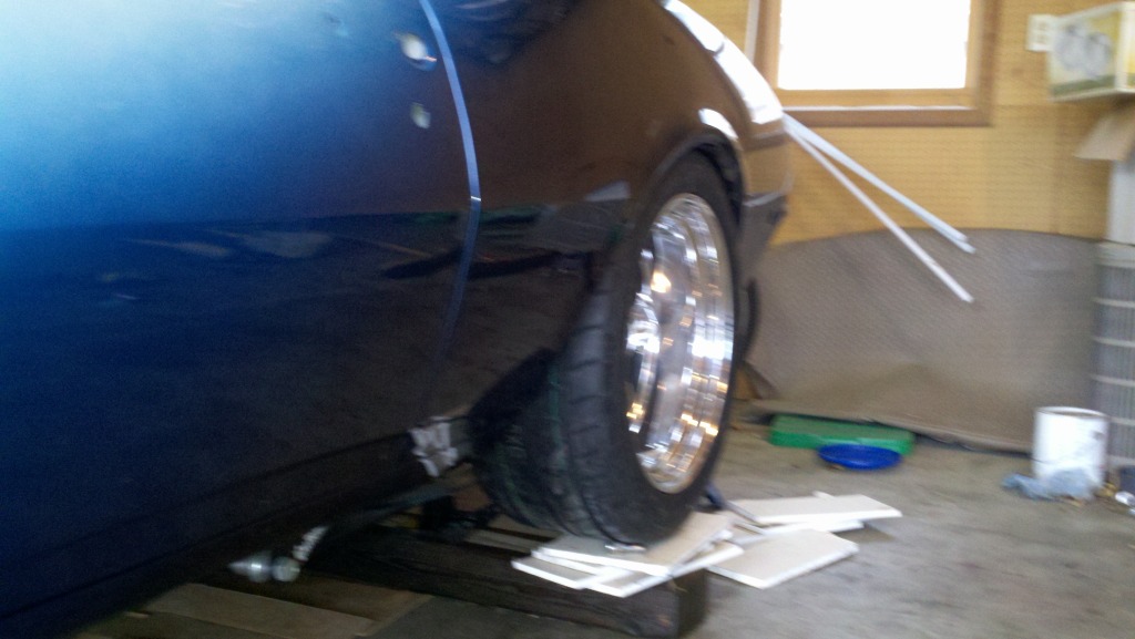

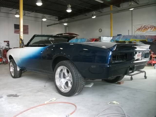

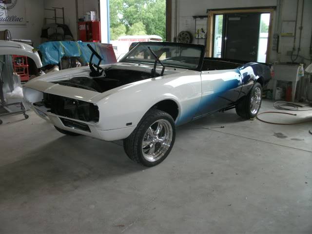

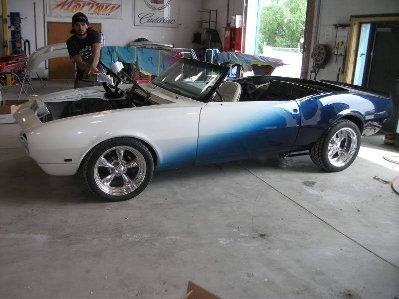

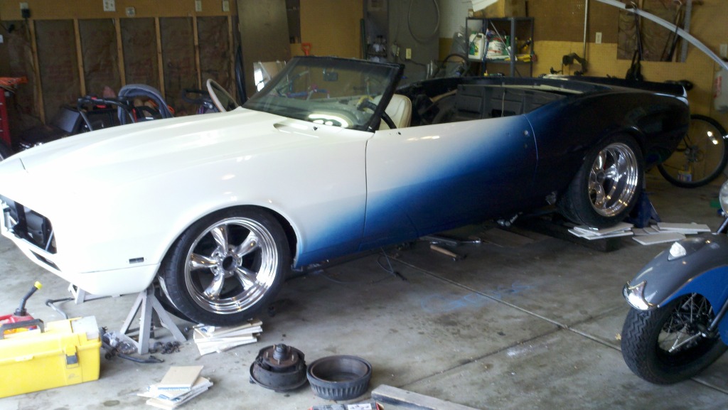

      Finally got the Camaro on all fours. Its now at our shop. It horribly needs a front end alignment, and we will probably end up getting 1" or 2" blocks to lower the rear a bit, but that will be after everything is finished and the full weight of the car is set.
      Ordered the new wiring harness today. Tomorrow I will throw in the new booster assembly and make sure that clears the motor stuff. Then, I will slap on the front end grille conversion for test fit. Front RS valance needs to be fit, throw in the new wiring, all the little accessories, and make sure everything works, possibly even get it running before we rip it back all apart for paint.
      We found a possible buyer and the color might change to Tangelo Orange from HOK. Waiting on a response from our estimate we sent him yesterday.
      Got the motor/trans put in today, and we are thinking these 6 cylinder springs just may be a little too soft.
      The rear shock location wont work as factory did, but still shouldn't be too much of an issue. When we get ride height set, I will weld in a bar going from frame rail to rail, then just weld on some tabs to hold a "custom" length shock off of the stock Caltrack mounts that are flipped inward.
