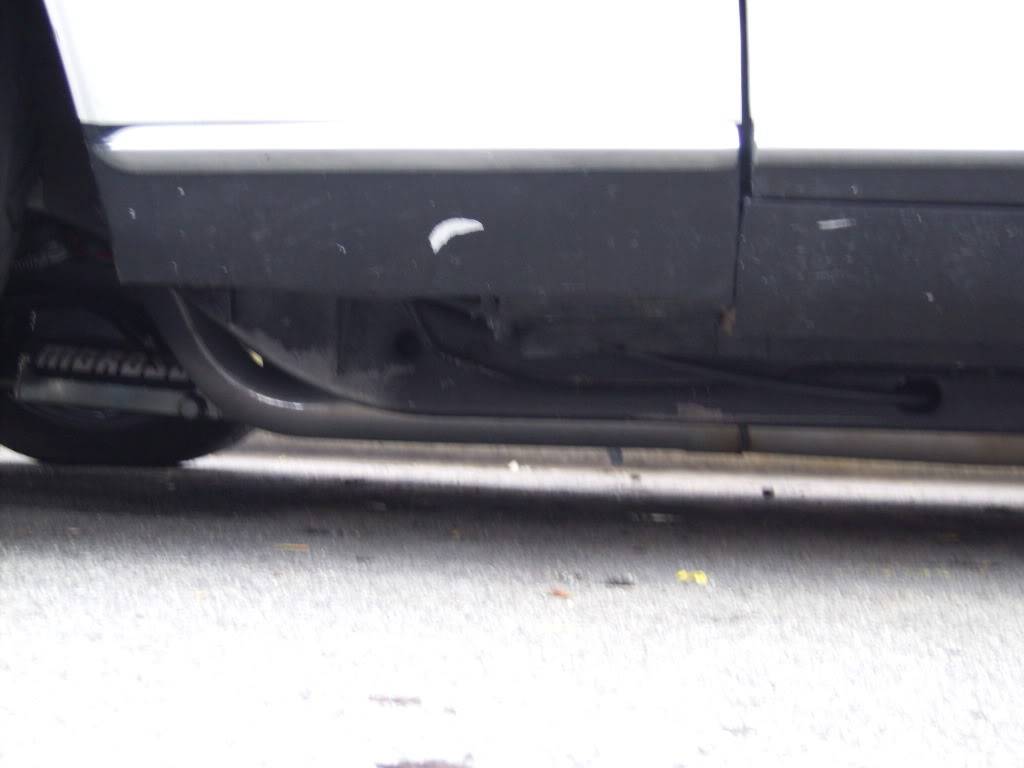

      tucks69 i saw your pictures on lateral-g. They do hang very low.

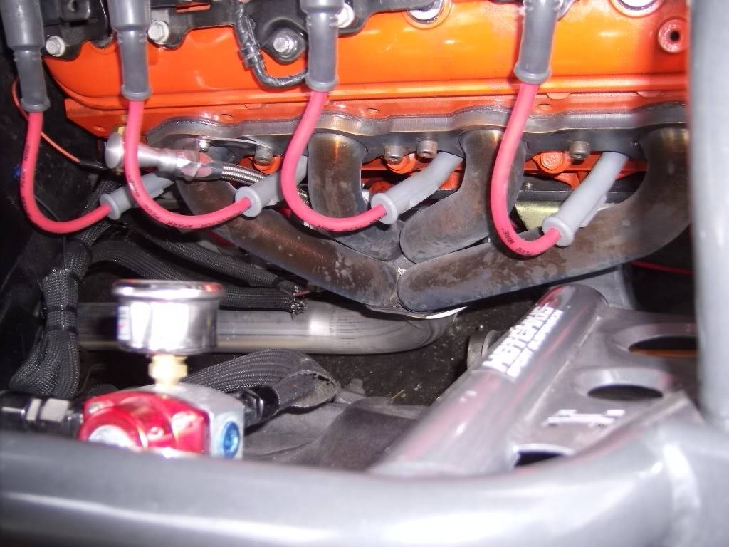

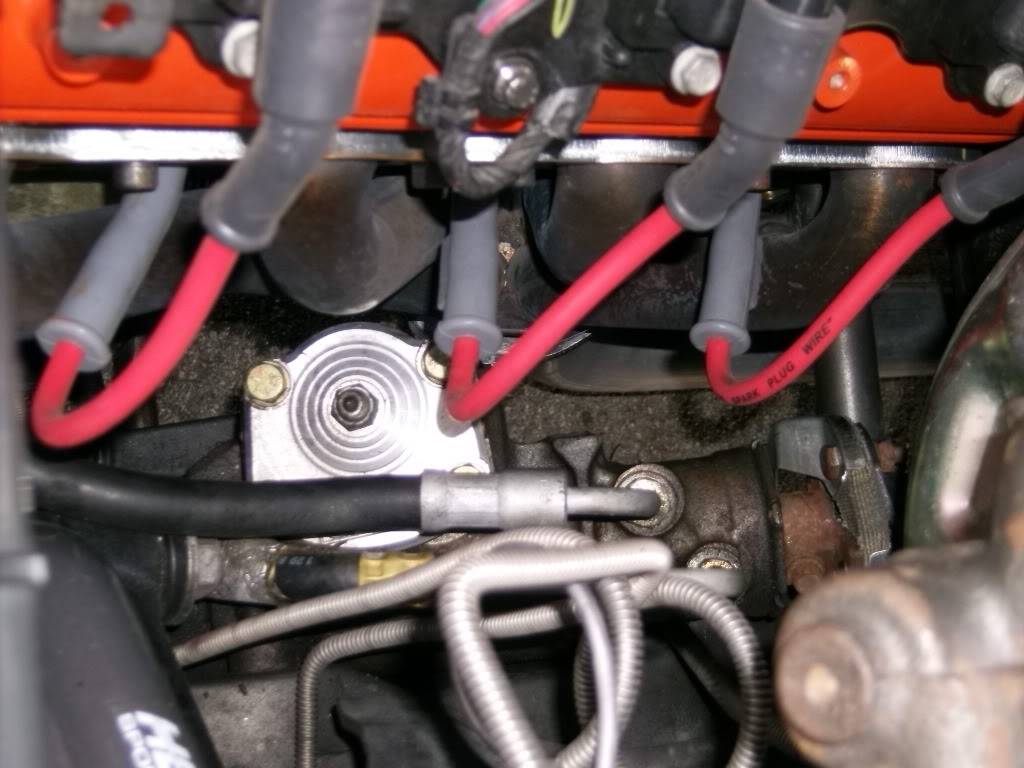

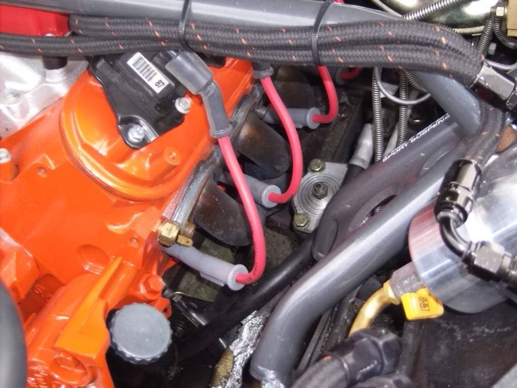

      all those high priced headers sound nice, I tried the dynatechs there nicely made and fit pretty good but I didn't like the 4 bolt collector setup, I used a mid length header from Sanderson headers (still hand made) around 300 bucks, the mid ones allowed me to have maximum ground clearance

      pic?
      Lawrenceburg, TN
      4,098
      Quote Originally Posted by icemanrd19 View Post
      pic?
      the exhaust tube to the headers is in between the frame height and oil pan, and the oil pan is even with the lower cross member
      passenger
      Drivers
      ground level
