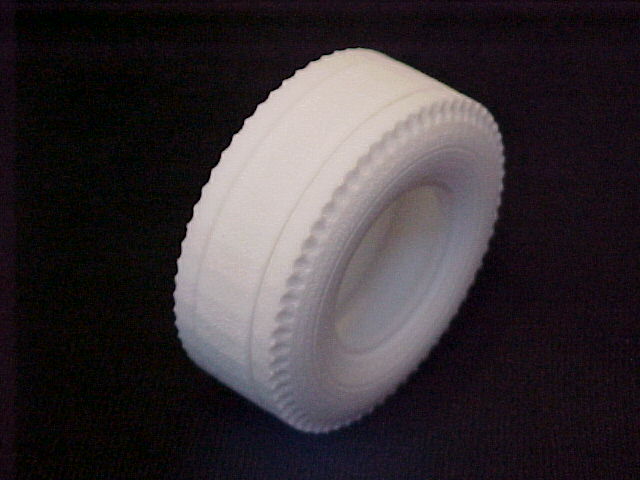

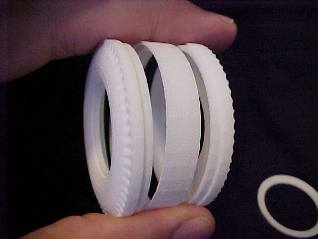

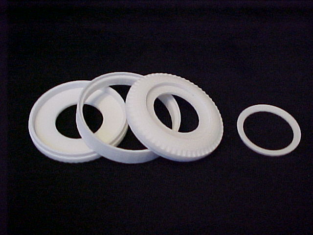

      I just used a company to make some 3D parts for me. I had modeled up some "pie crust" slicks and they quoted me a very cheap price so I gave them a try to see what the quality was like. I used to be into model cars quite a bit. Had a company making turned aluminum and photo-etched parts.
      Here are some pics of the tires.
      As you can see they are multi piece. This makes them easier to cast and they can be used to make different widths by simply swapping out the middle section for a wider or narrower part. They also have a "whitewall" section that snaps in.
      They turned out fairly well and fit was excellant. Surface finish is rough (as expected) but these will get buried in primer and polished. Readying them for resin casting.
      This is pretty kool stuff and I will be getting more parts done.
