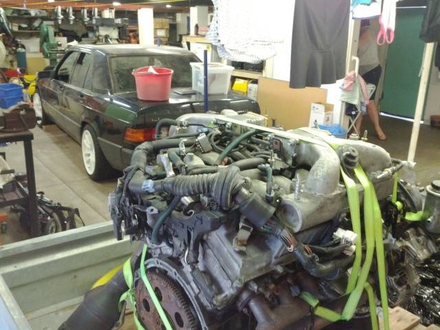

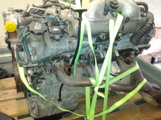

      A little present arrived today. Ooh, what's in here I wonder?
      Six on this side
      And six on this side
      In the shape of a vee

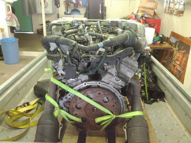

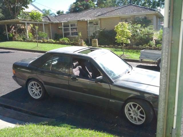

      So, 2000kms in two days to drive down to Sydney and pick this up. Shhh, it's sleeping
      But I woke it up to introduce it to the V12 bitch.

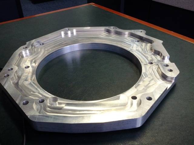

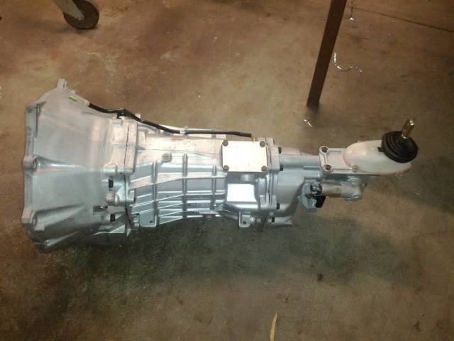

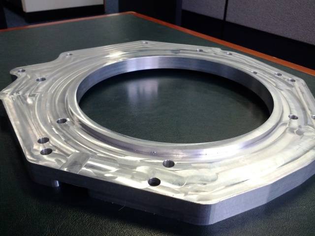

      Do you know why I like knowing someone who knows how to use the $125k CNC mill in his shed at home and who loves making car ****?
      This is the adapter plate that will sit between the 1GZ bellhousing and the T56 gearbox. It was the last essential piece I needed to allow the mounting of the engine and gearbox to start on Monday.

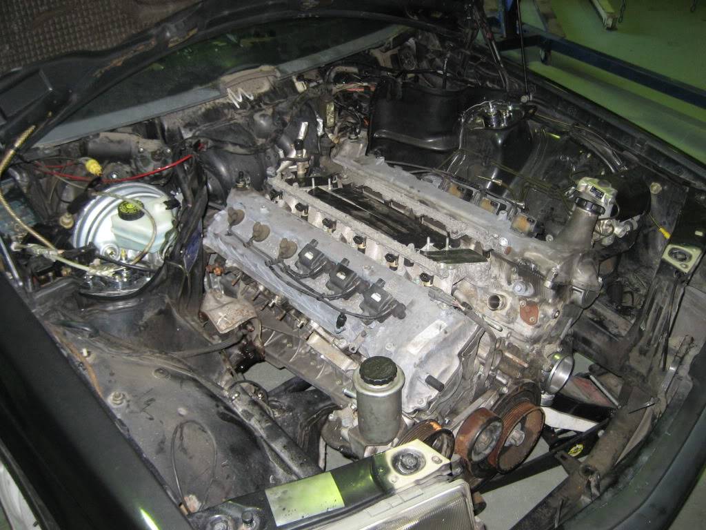

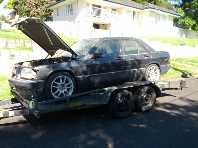

      Pushed this ****ter out on to the road yesterday morning
      And loaded it onto a trailer
      And drove it two hours north to the chop shop where it now sits on a hoist with an already half stripped engine bay.

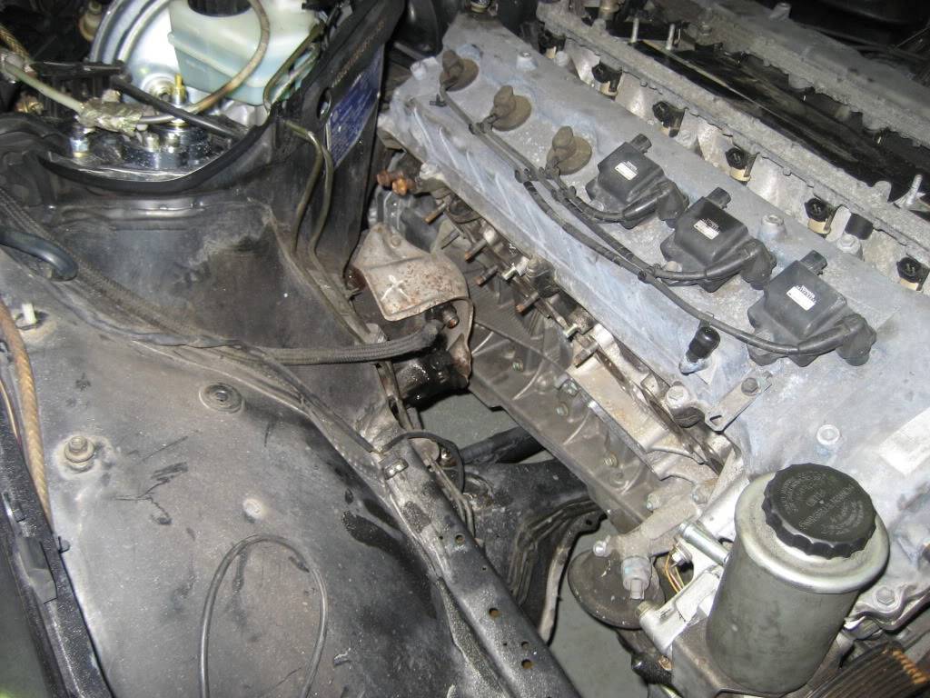

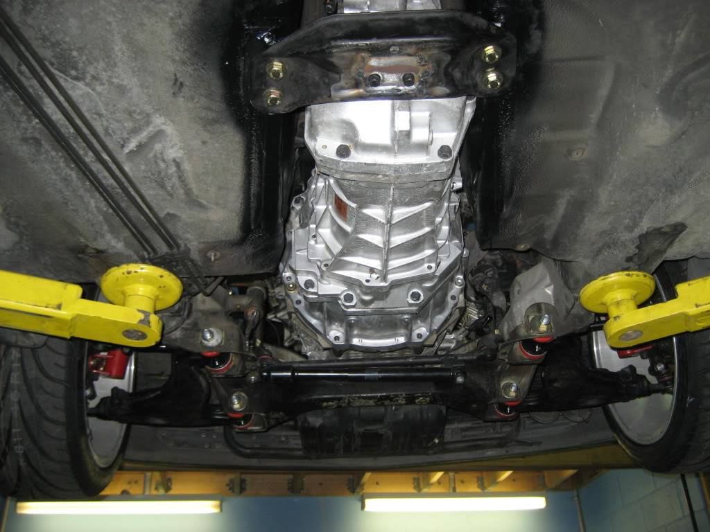

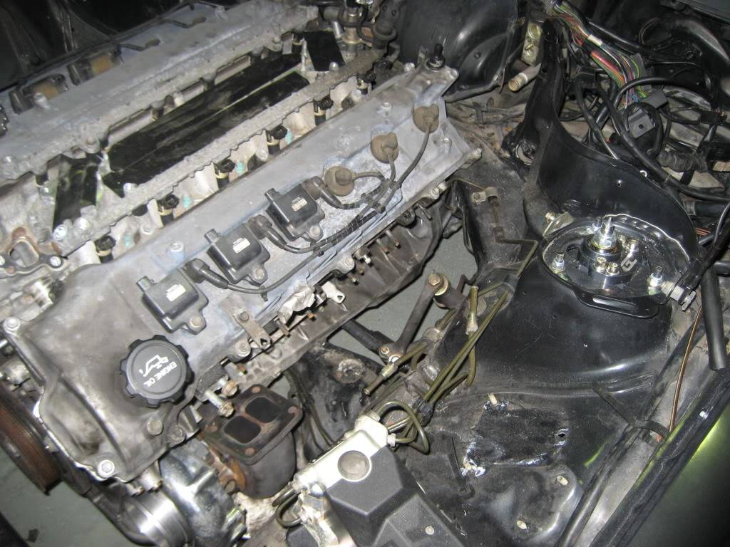

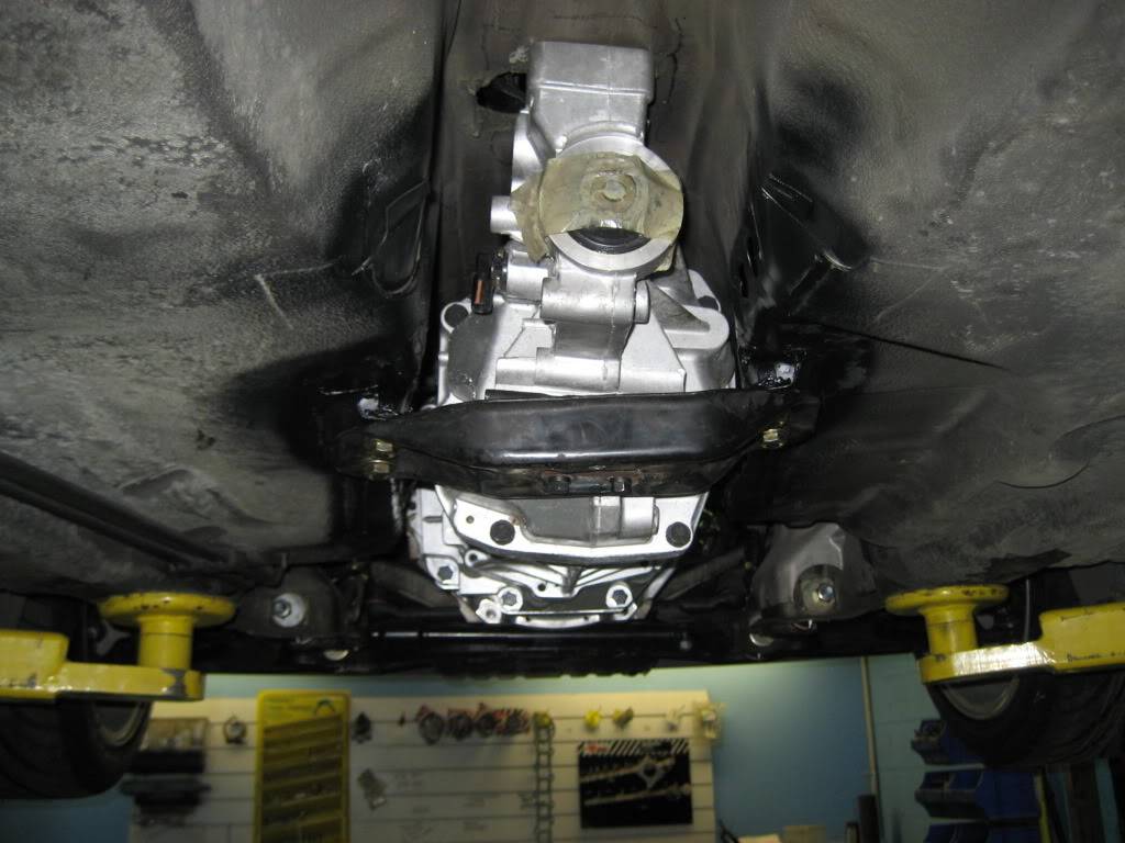

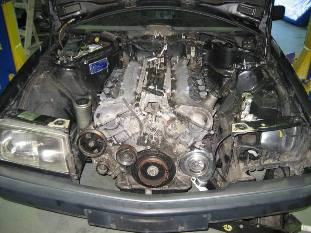

      So work started on this last Monday

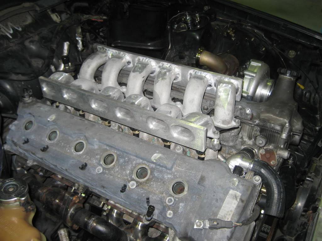

      Fits pretty good once I chopped off a thousand alluminium lumps of the engine and gearbox and brutally beat the tunnel. Steering box has aids so it will have to be single turbo.
      1.19 GT4088 with Turbosmart 50.

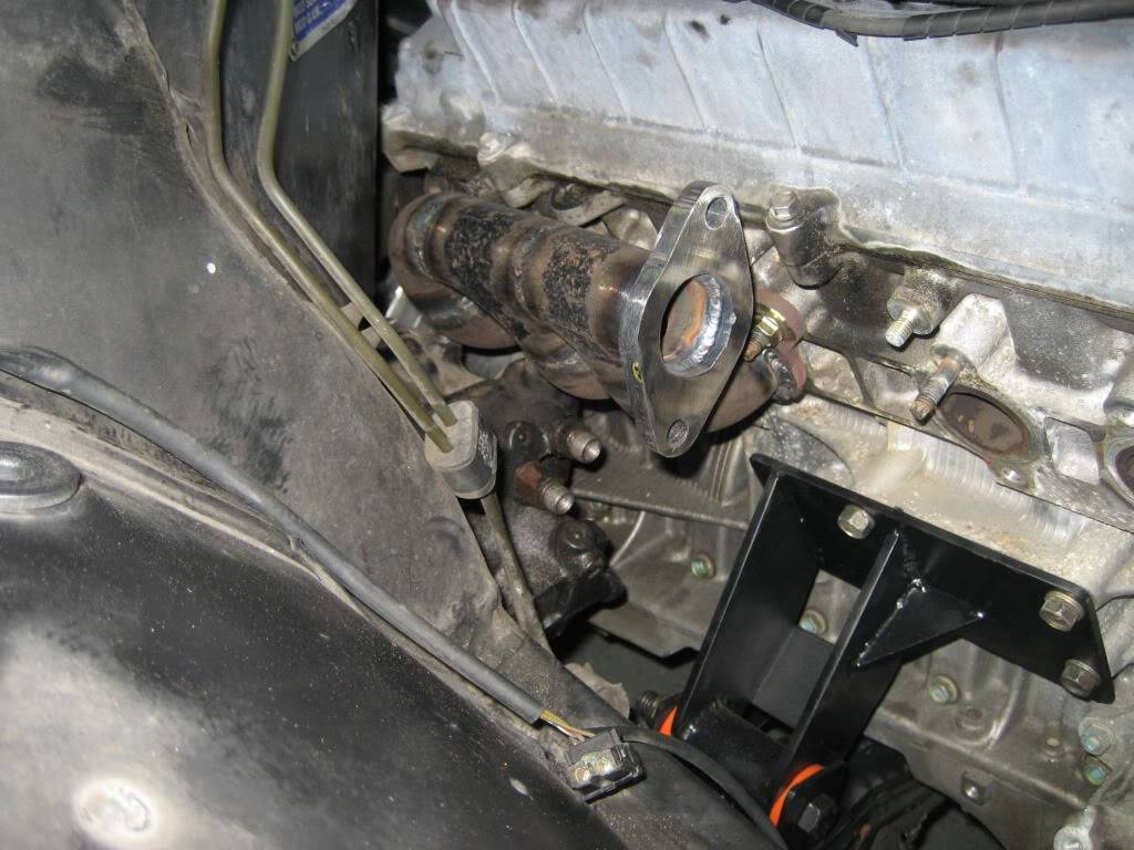

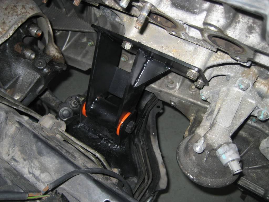

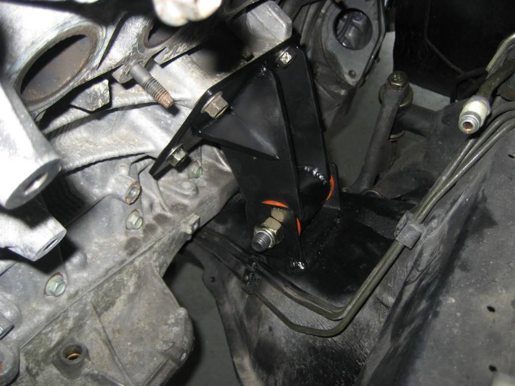

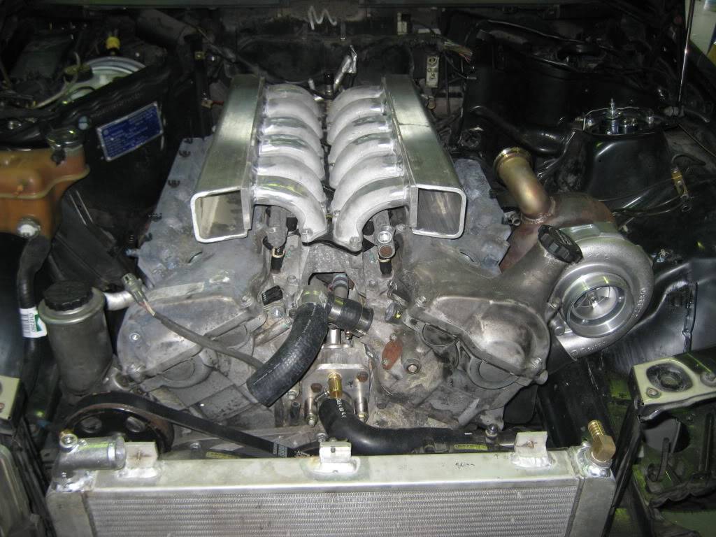

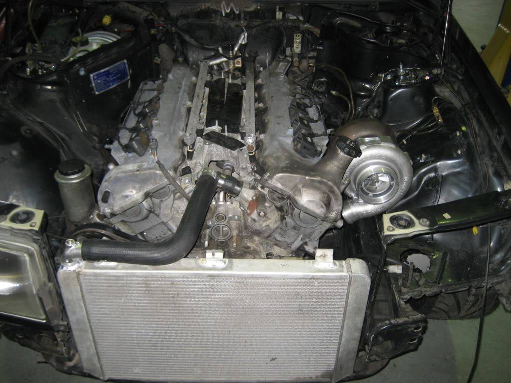

      Next update

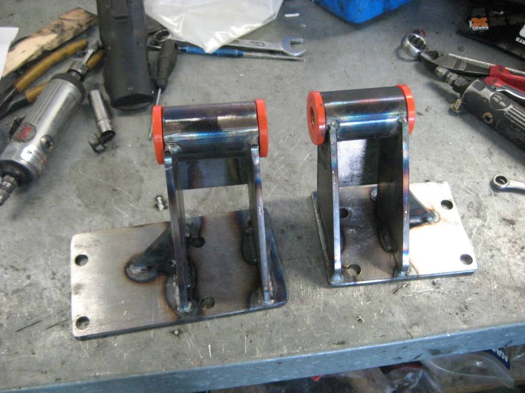

      Engine mounts done.
      Started thinking about radiators and other pipe routing. I found this radiator in my shed, it's been there for years so must be mine. It fits great. Changed the outlet to the top and remodelled the top hose outlets with the aid of some commodore thermostat housings.
      Starter is the only real headache atm. Needs to be changed to clear the idler arm. Working on that.

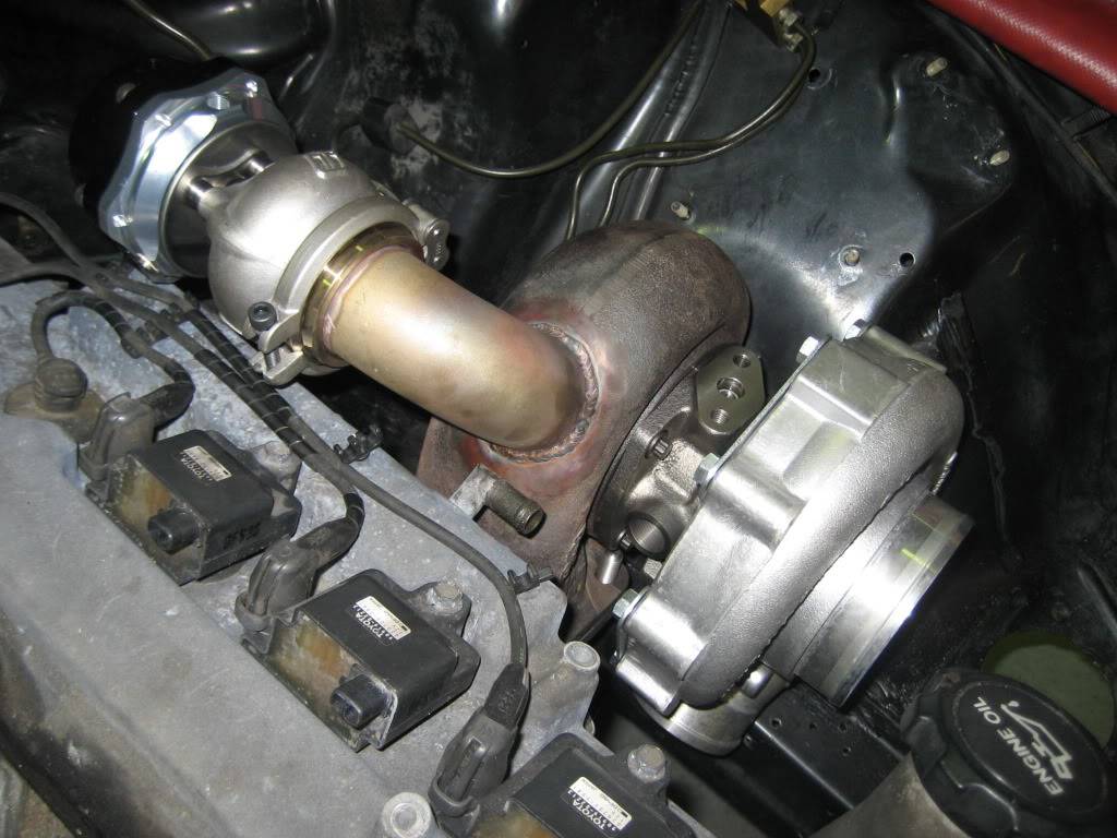

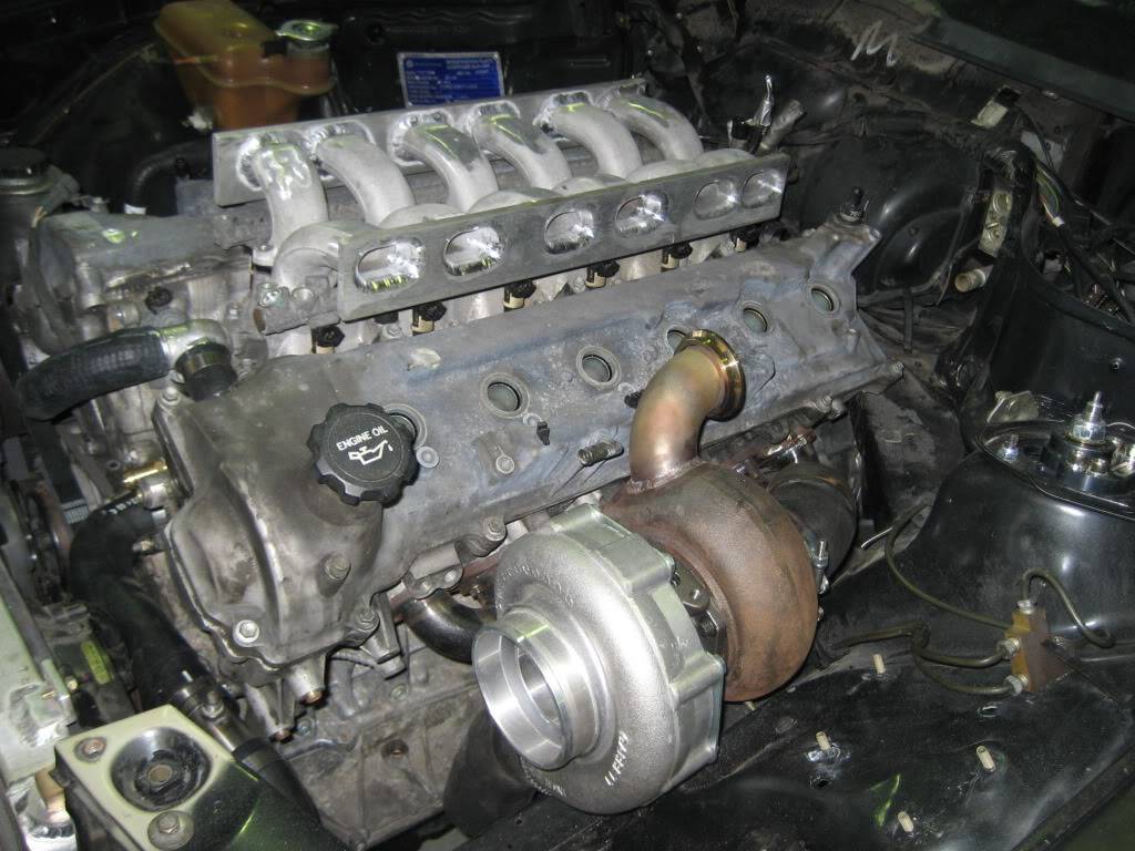

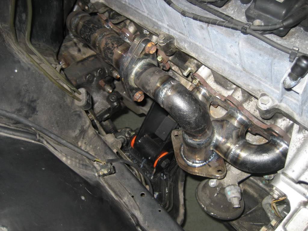

      Mar 2010
      Brisbane, Australia
      138
      Country Flag: Australia

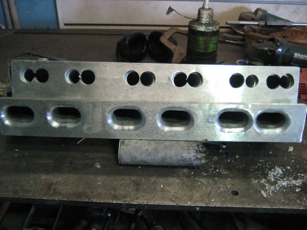

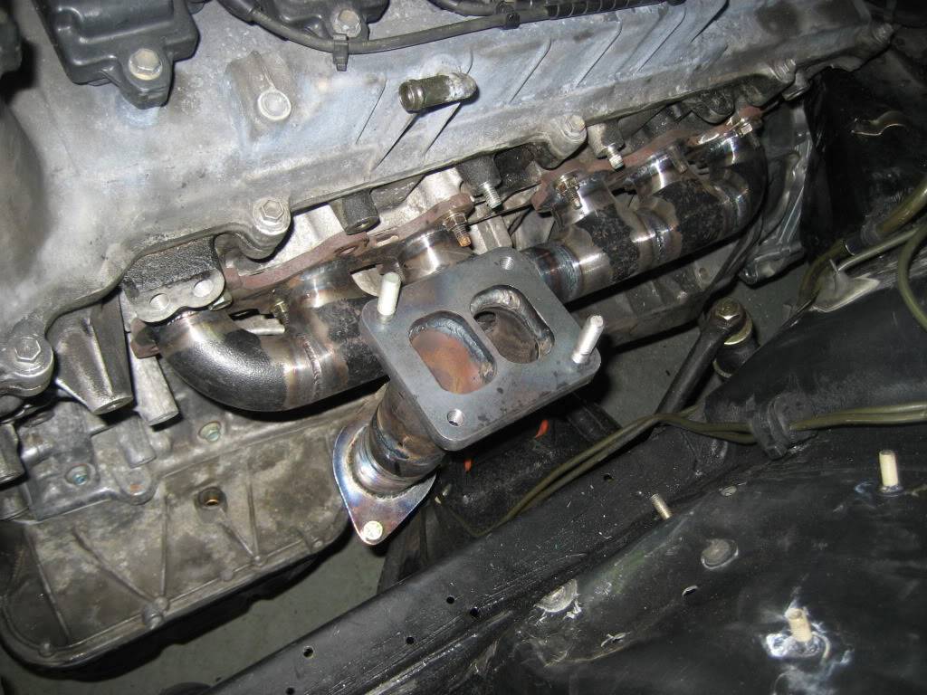

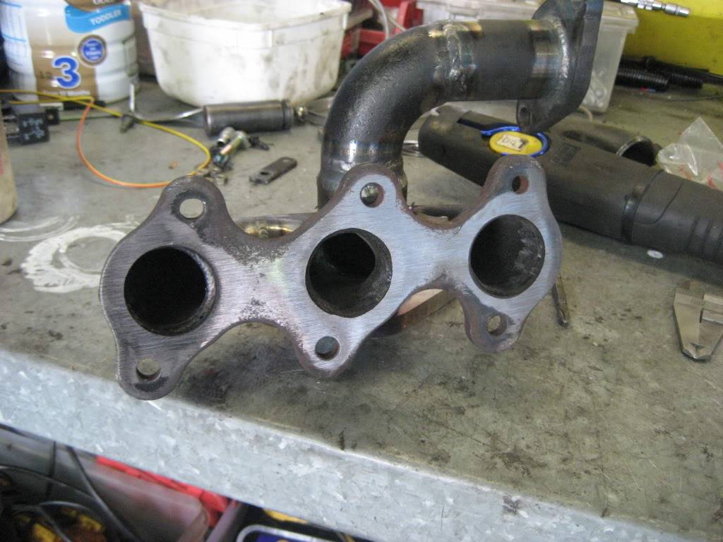

      Then this happened

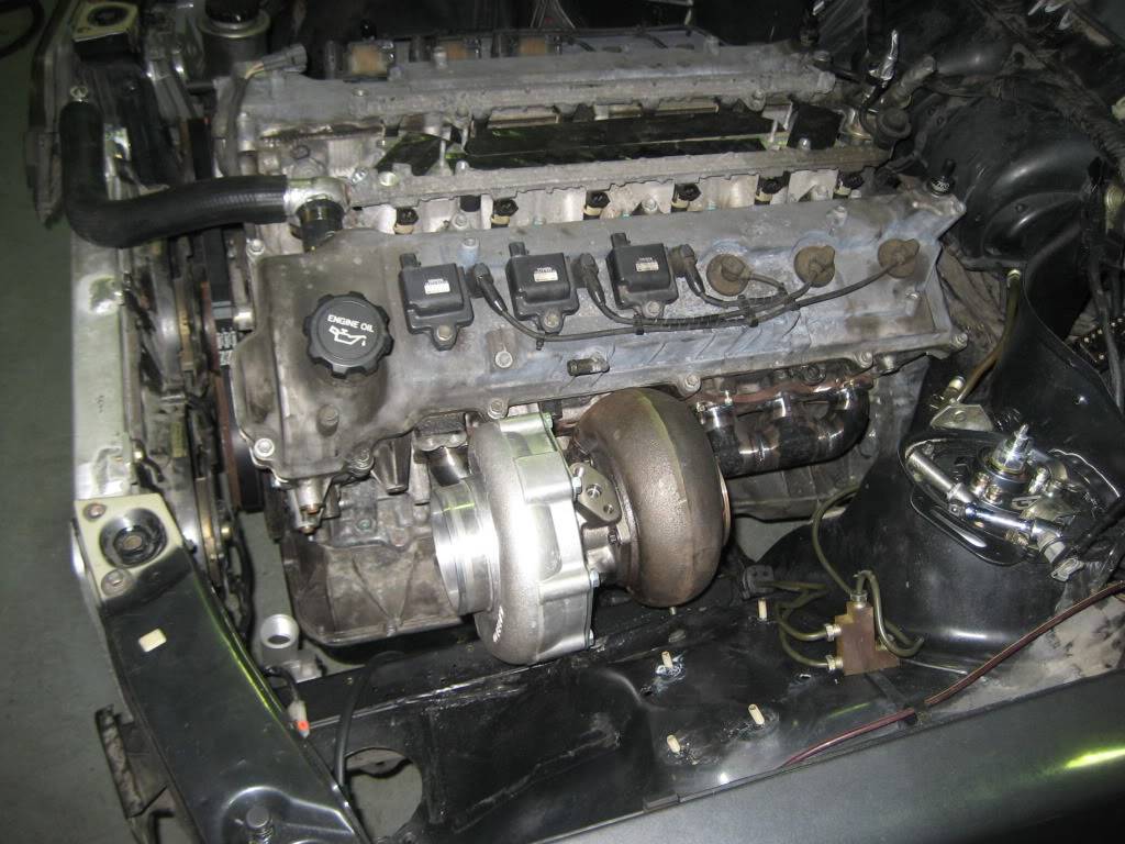

      Manifolds and stuff. Been a bit lazy.
      Devils steering box.
      Will never spool up with log manifolds.
      Some parts and materials not yet arrived.

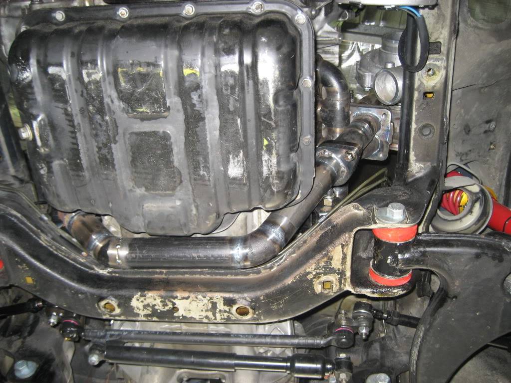

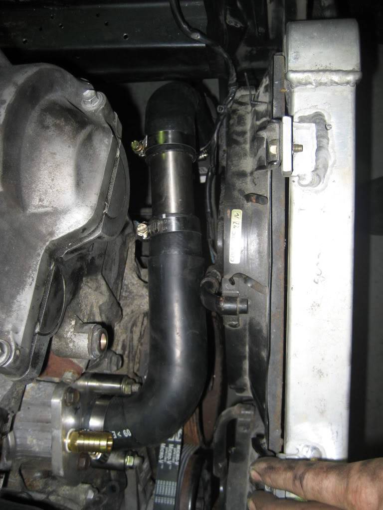

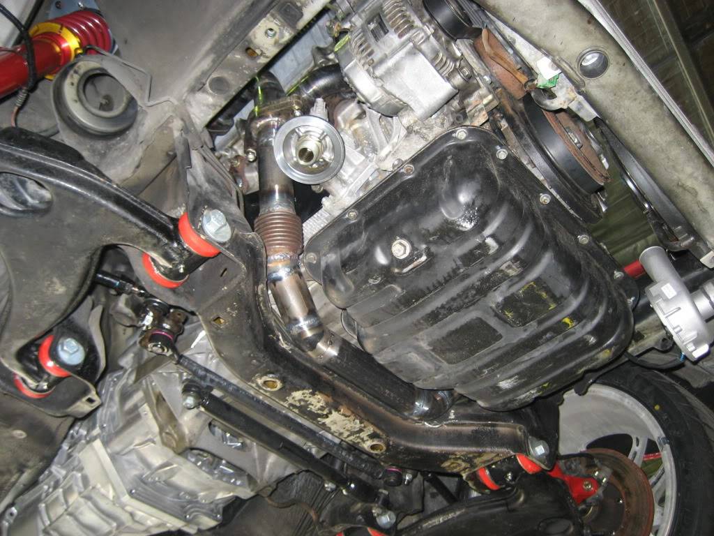

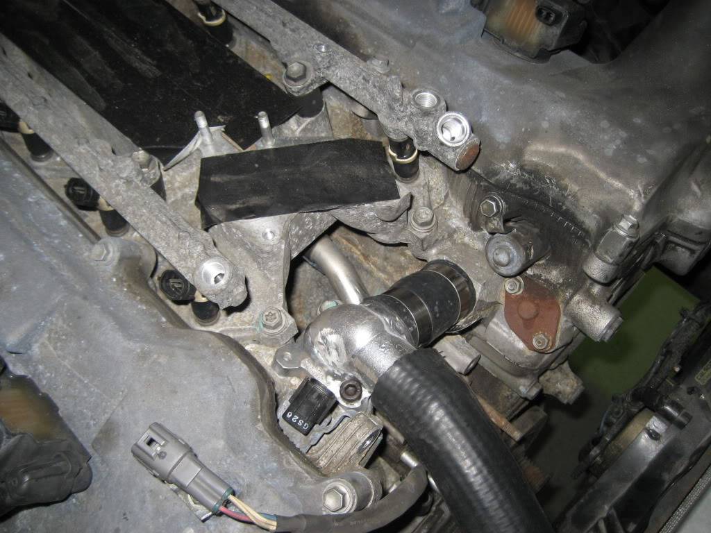

      And to round out the first week of conversion work - note this update contains sarcasm...

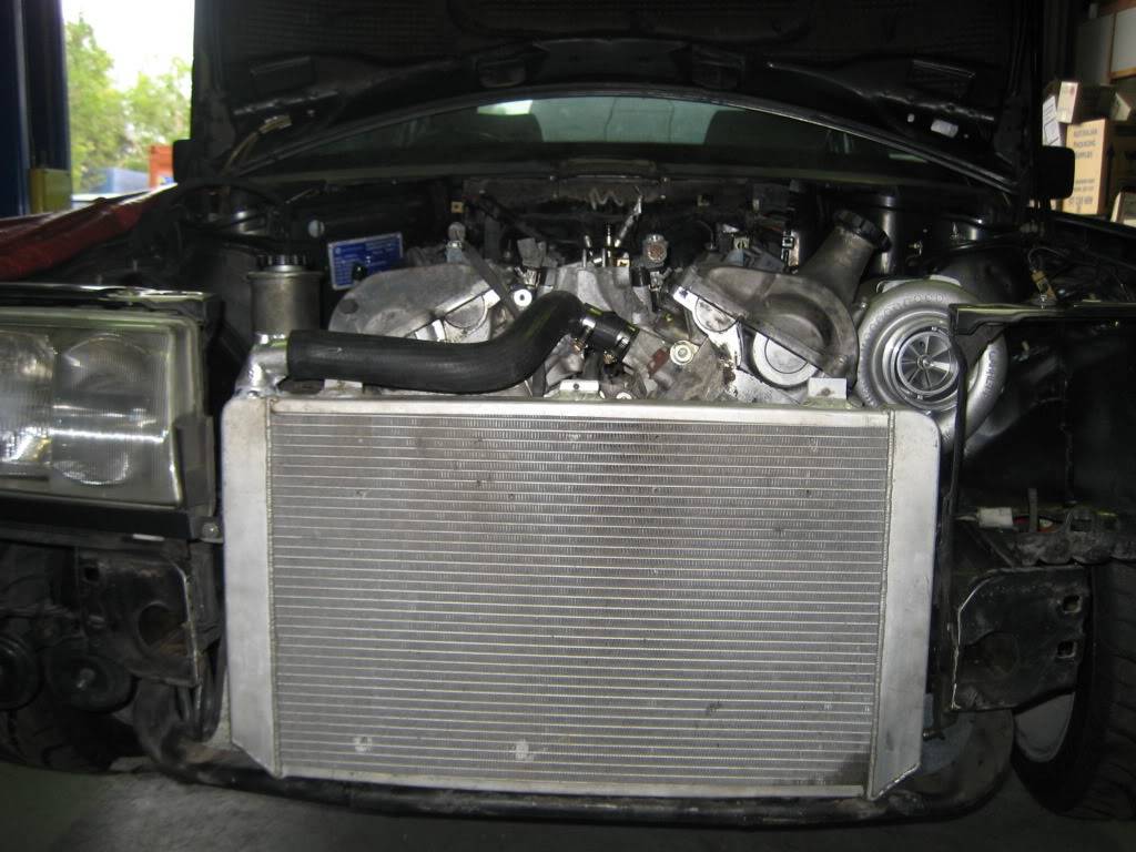

      600x300x73mm tube and fine vertical flow core with fabricated tanks. Clayto can get his own Krautwerks front bar to clear it.
      Today.
      Made Clayto a bong.

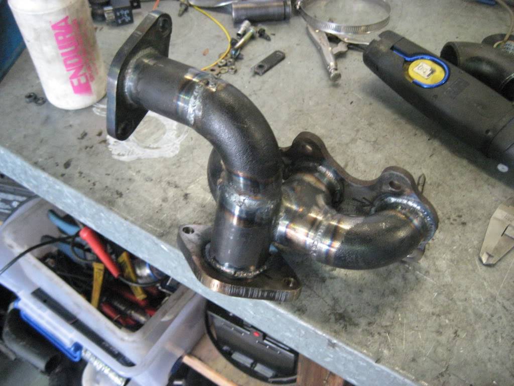

      Crossover pipe.

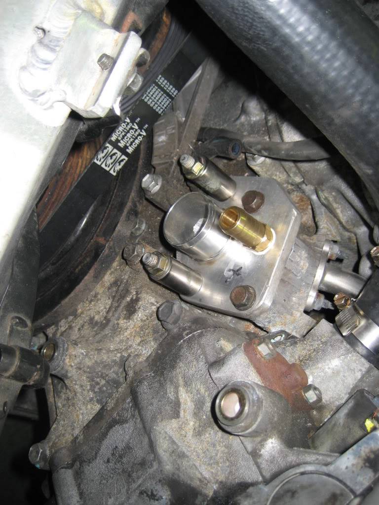

      Water pump outlet(replaces factory water pump housing).
      Bottom hose into DC EWP.
      Wastegate outlet on exhaust housing. Yes the housing will surely crack. Yes the leads and valve covers will surely melt. Yes the turbulence in the dump pipe where it reenters will cause armageddon.

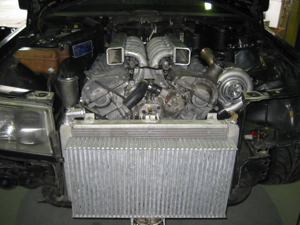

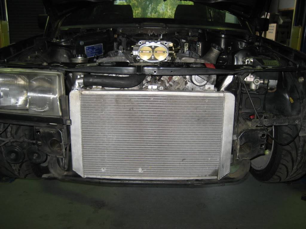

      Today's update
      More unfinished stuff
      Intercooler core. Need to space out the grille for this.
