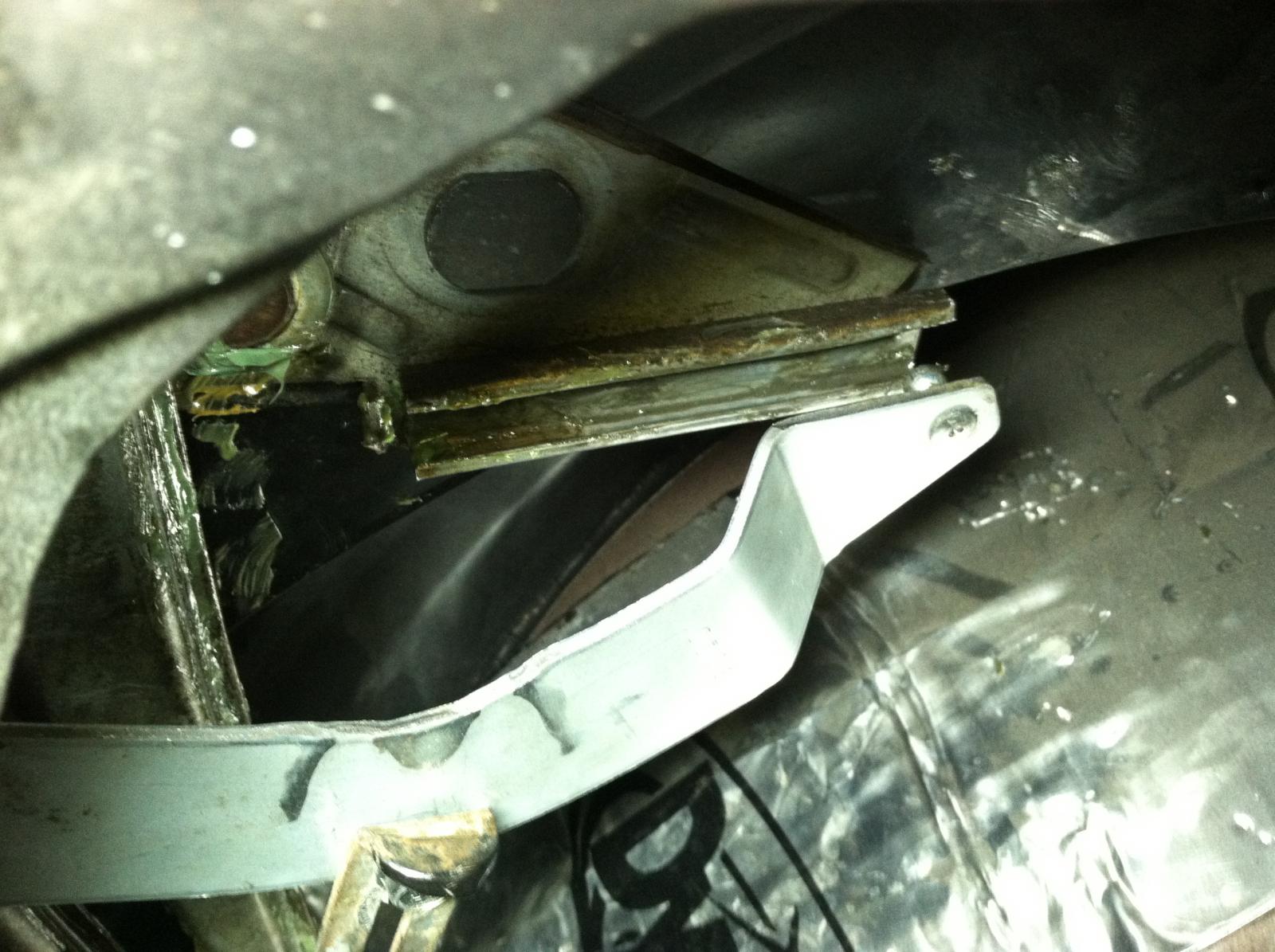

      Good grief with this thing. I've searched this forum to death. This is obviously a PITA. Can anyone give me some insight on this? I have put the window in place and adjust everything and no luck. Also, looks like I am missing the plastic channle guide. Biggest problem is I can get it set into place, but when I roll it up, it get snagged outside the window and doesn't go into the channel. The rear window is a bear. Please helpName:  photo (13).jpg

      what type of kit did you buy, windows have so many adjustments and you just have to be patient, looks like the bottom of the door adj to me. tilt the entire unit in,,,i am also looking to install power units on the front of my car, not te rear.

      You do not have the stop set correctly, it appears you are going too high. You also have to adjust it to tilt in more. Here are some good instructions:
      http://www.camaros.net/forums/showthread.php?t=140382

      I saw that thread. Looking for more guidance on the front window, although I got it really close after tinkering with it for hours. THanks,
