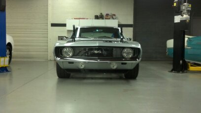

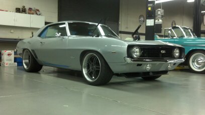

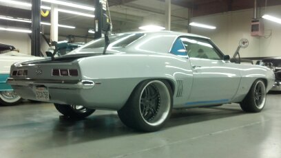

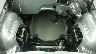

      Just wanted to introduce myself. I'm building a 69 Camaro PT. Bought the car last year at the Good Guy's event in Pleasanton, CA. As purchased the car was really quite nice - LS1, T56 and a Ford 9", but it's really hard to leave well enough alone...Since last summer we've added DSE mini tubs, installed the DSE 4-Link with QA-1's, upgraded the Ford 9" with a new Tru Track posi & 373 gears, installed the DSE subframe and all the goodies that come with it, DSE subframe connectors, Boze Lateral G rims 19x12/18x10 and Nitto NTO5 335/19&275/18 tires and Wilwood 6 piston calipers and 14" rotors. We are swapping out the stock Houndstooth buckets for a set of Recaro Specialty M's and a custom matching rear. We changed the T-56 out for a TKO-600 and we're building a supercharged LSX engine this month. Stay tuned....Thanks for looking!
