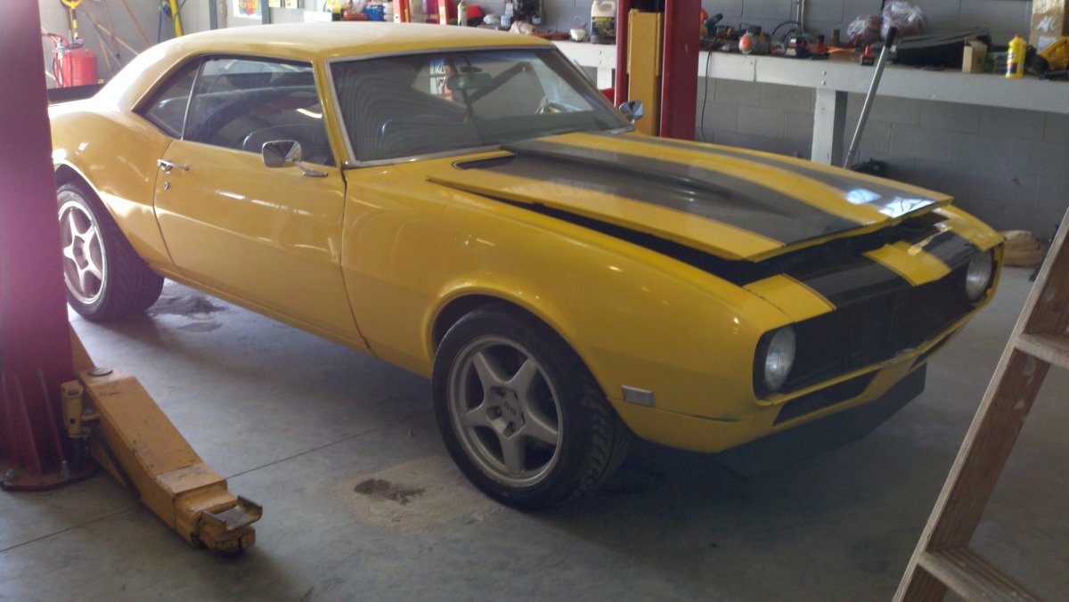

      Requires a lot of spacers. 1.8in in the front, 2in in the back. Mine are 9.5 wide all around though, the rears might not fit without a minitub or severe hammer work. I had issues in the front with the wheel rubbing the steering arms and lightly rubbing the upper A-arm, might have been unnecessary, but I get Speedtech High Clearance uppers to help clear the A-arms, now there's no chance of the wheel ever hitting it.
      The truturn you have in might might just be perfect for this and require a lot less spacer, but IDK as of yet, I'm too poor to pick one up.
