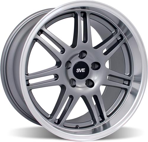

      Since your car uses the 5 on 4.5 bolt circle look at some of the replica Mustang wheels. This is the wheel I am going with. Not your typical overdone TT style wheel but to me it has kind of an 80's road race feel. 18x9 and 18x10 for under $600.00.

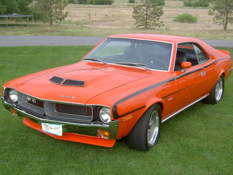

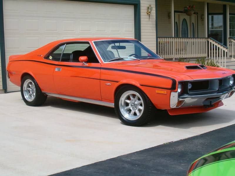

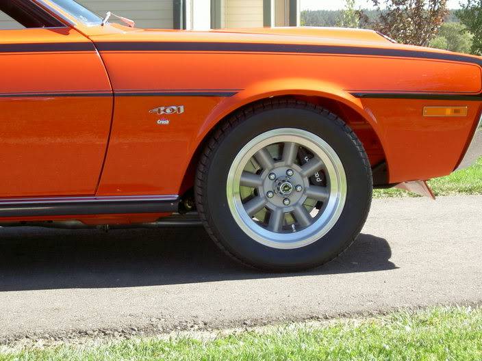

      Here's a couple pictures of one of my Javelins. It has Vintage Wheelworks V45s, wheel size 8 X 16 w/ 4.5" offset. Tires are 245.45.16. I can't remeber the cost, but the Vintage Wheelworks website has prices on it as I recall.

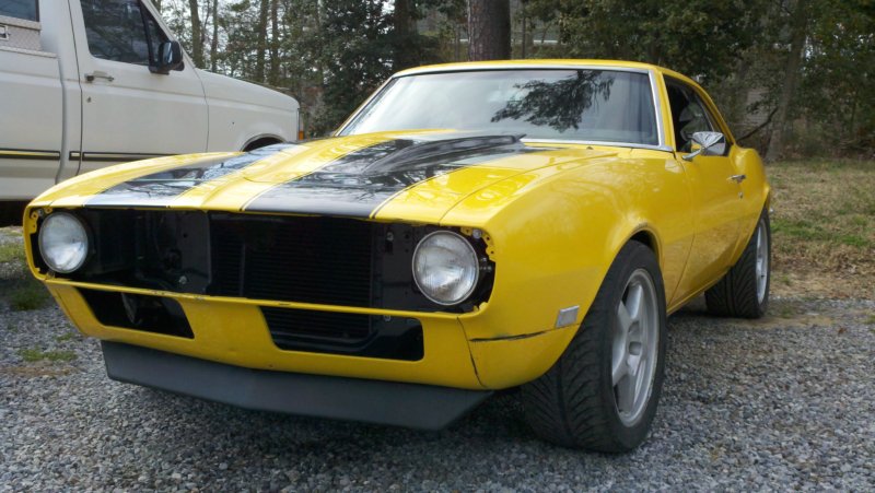

      ZR1's
      17"x9.5"
      Wheels used for $400 with tires
      275's

      Vicinity, did you need to use wheel spacers? If so, how thick?
      Jun 2009
      Central FL
      1,231
      Front - 1.5" + 8mm
      Rear - 2"

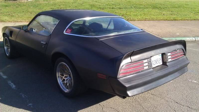

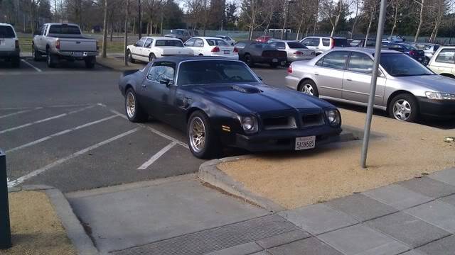

      Year one 17x9 Snowflakes with 0 Offset/4-7/8" BS with 275/40/17 Kumho Ecsta ASXs all around.
      Also, dig my rear window Infineon Raceway stickers, before they made their super cheap looking new ones.
      Rims were $749 before shipping and taxes.

      That's a great looking car !

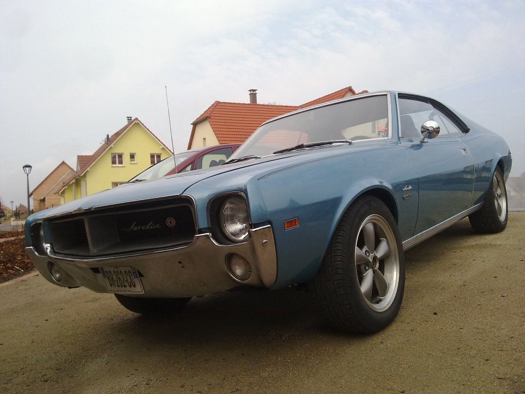

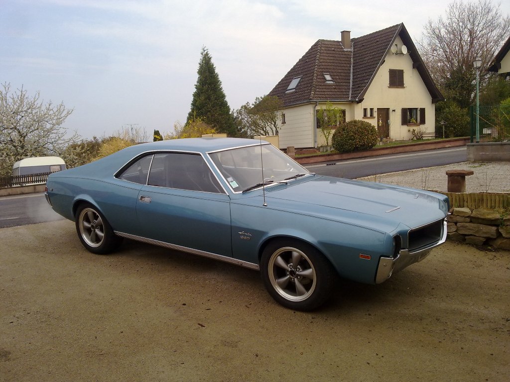

      Here are the pics I promised from my father's 68 Javelin. (Mustang wheels) We needed 1,5" spacers at the rear and 1"3/4 at the front. We will have to rebuild the trunnion I think because the driver wheel nearly touches the trunnion, when the passenger side has enough clearance.
      I find them nice on that car

      Wow, they look nice indeed!
      That's also 17"?
