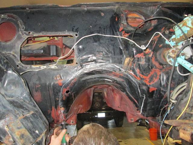

      updates way overdue.

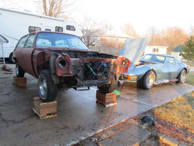

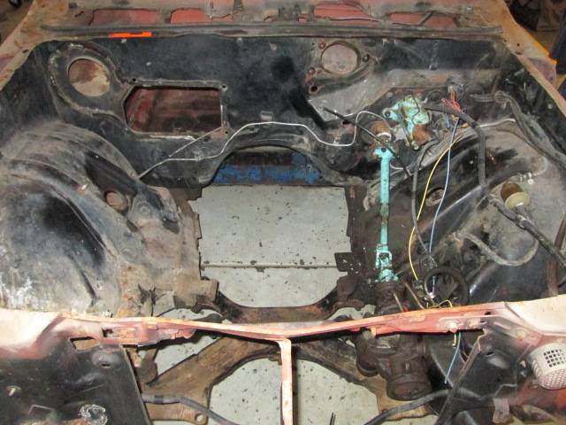

      engine out

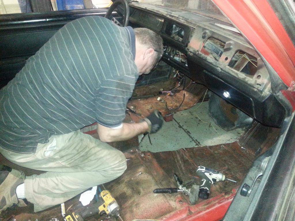

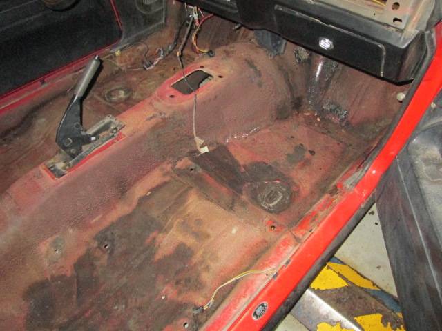

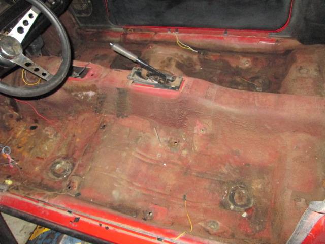

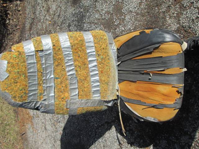

      Removed the seats and took off the seat covers...yikes

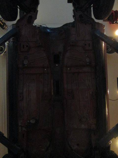

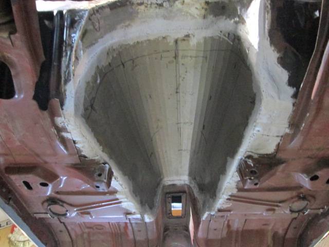

      removed the nose power washed the bottom
      put it back on the lift. kinda rust free.

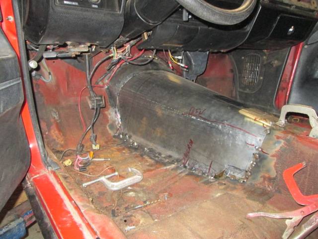

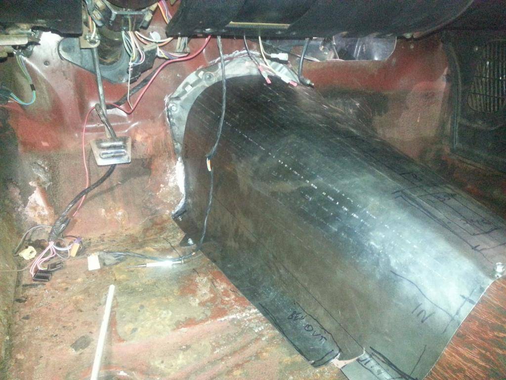

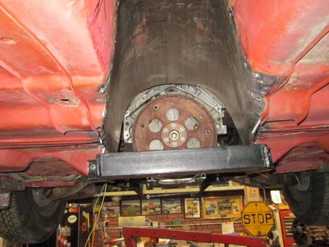

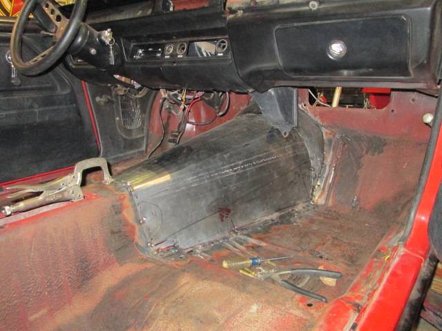

      Realized I wanted a T56 so the interior came out.

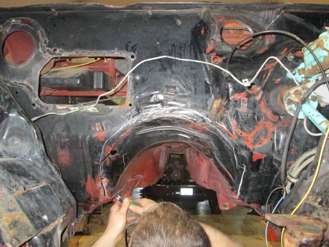

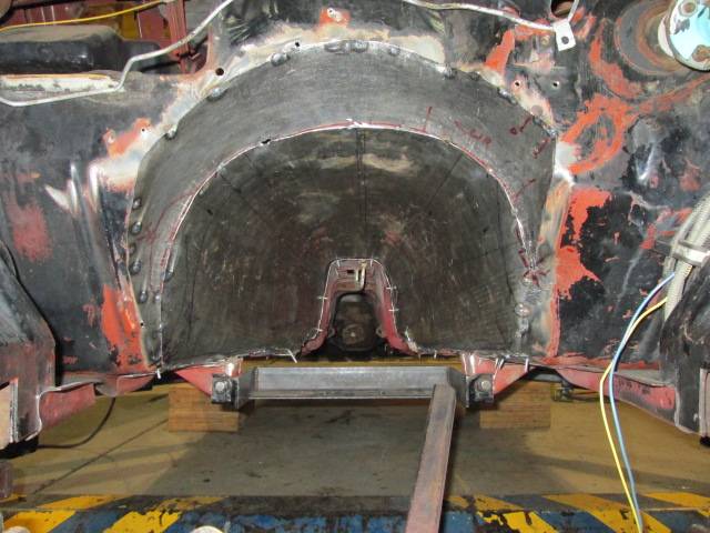

      Then the trans tunnel came out

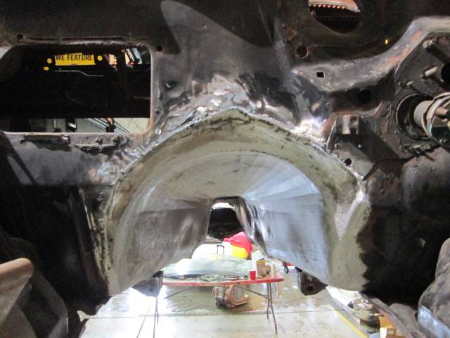

      I don't like vehicles that are impossible to repair, and or that strand you....so I wanted the trans tunnel big enough to get the trans out in a reasonable amount of time. ..so its pretty big. My buddy is a sheet metal guy so we made the trans tunnel on his brake.

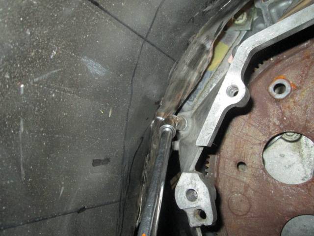

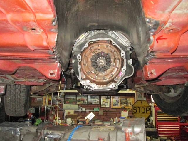

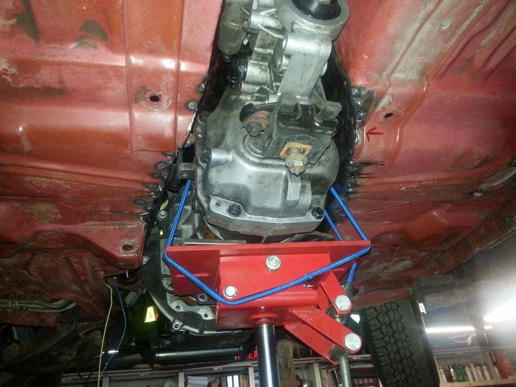

      checking clearance for bellhousing bolts
      dang that trans is big
