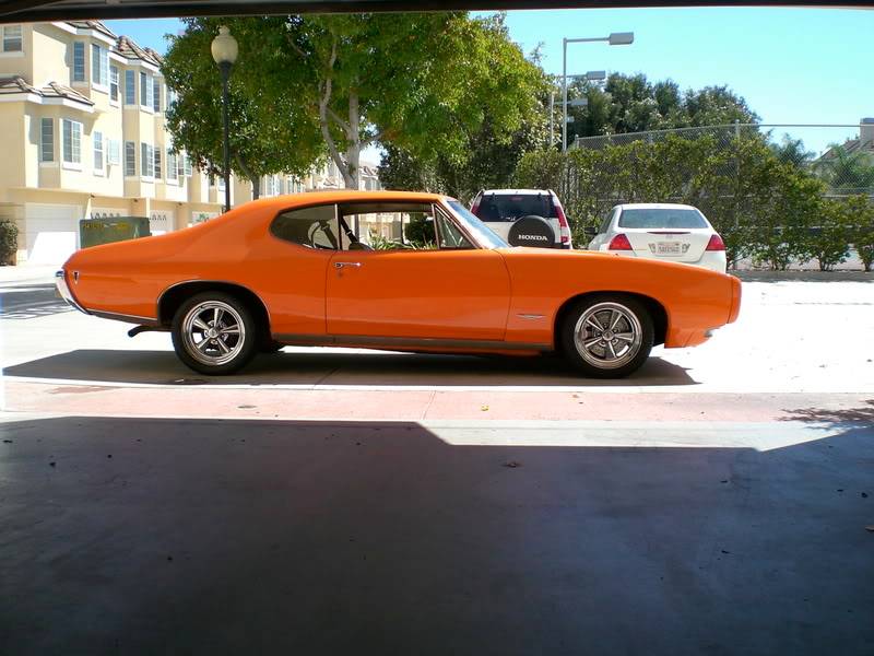

      I had those wheels on my 68 GTO in 17x7 and 17x8. They do not have a lot of spoke clearance. With a 1/4 inch spacer both fit a 13 inch bear GT plus kit using the PBR 2 piston calipers. Anything larger is not likely to fit.
      Here is an old picture of my car right after I installed the front suspension and brakes but before I adjusted it. It is set way too low to drive (like 1/2 inch from the ground) but I had to take a picture.
      Make sure you get the right lugs and/or studs (if you want spacers) for those wheels or you won't have enough threads engaged for it to be safe.

      That's a nice ride. How strong are them spacers? I've never used them before and not to sure about them.
