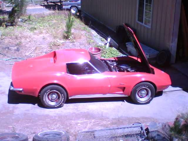

      Name:  73 vette top.jpg
Size:  46.0 KBAt my dad's garage

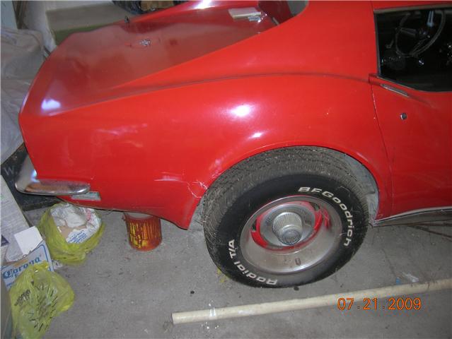

      Name:  mild carnage.jpg
Size:  36.7 KB the only damage i found

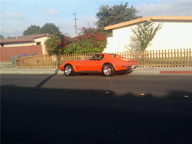

Size:  34.3 KBcell phone picture after washing it in San Diego

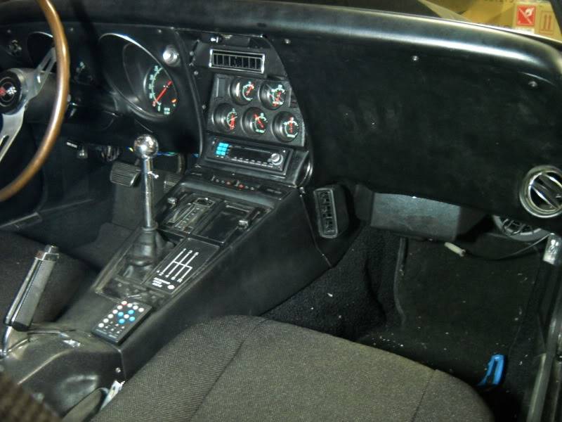

      I'll tell you what I did with my 68 convertible
      02 LQ9 6.0 with LS1 intake, Richmond 6 speed. You can go with any OD trans. I went with the Richmond because the gears worked well with my newly rebuilt 3.08 rear.
      Vintage Air so I can actually drive it in the summer.
      Lowered a couple inches. Unless you go with considerably wider wheels and tires, suspension mods dont get you much.
      I kept mine looking stock outside. IMHO, the early C3 vette lines are too cool as is, I wouldn't add flares, etc.
      And even inside, all original gauges work. 67 Hurst shifter handle makes the Richmond look like it belongs. Only the 6 speed shifter plate gives a hint.
      Starts every time, 26 mpg on the hiway, cool in the summer, and really fun to drive.

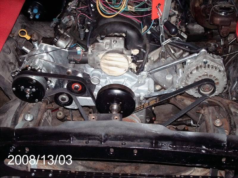

      I have a 1972 Corvette and I'm in the middle of doing a lot of what you're thinking of doing but taking it down to the frame at the same time.
      LS3, TK600, Tubular A-arms, Coilovers, flares and a 1969 front clip to name a few.
      Check out my build thread - unfortunately not much progress while I'm stuck in Europe.
