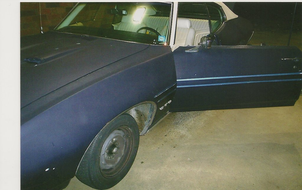

      After a couple of cans of black primer and some neat wheels she started to change her mind and see some of the potential.
Size:  88.8 KBName:  042.jpg

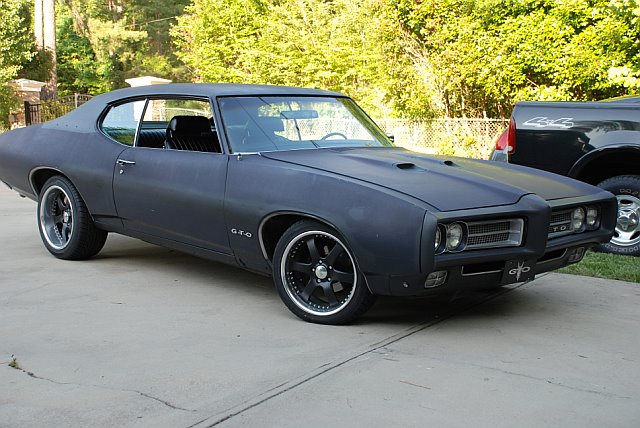

      Once I gathered enough supplies and some funds I hired some local buddies to help get her painted and looking good.

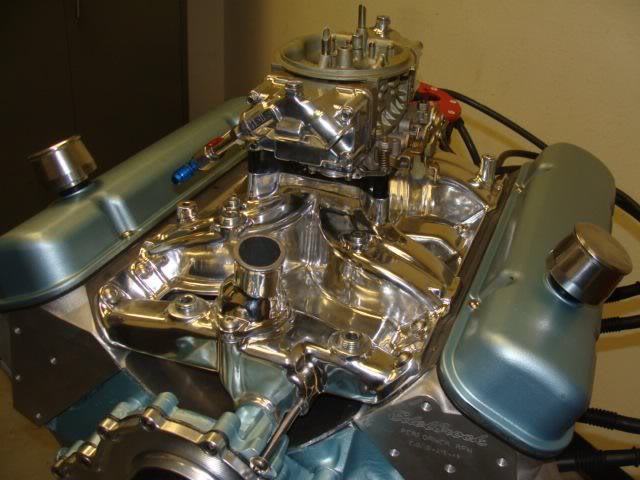

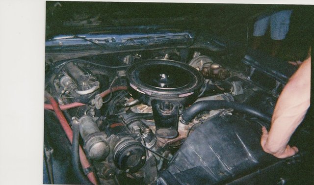

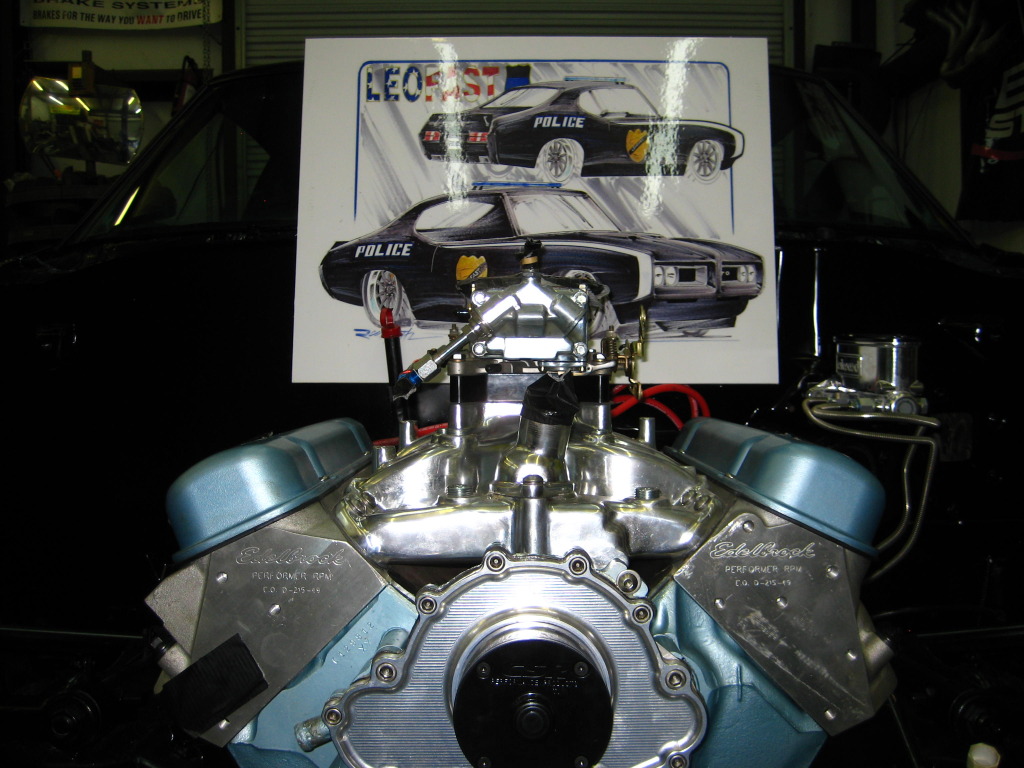

      After the paint job,the project sat idle for awhile as I continued to buy parts for the new motor. I decided to build a Pontiac motor 468cui N/A. (I didn't realize how easy and convenient a LS motor would be until it was too late. I had the engine built for 645hp and 650tq. The real numbers came out to 602hp and 605tq on the dyno. Name:  MOTOR2-1.jpg
Size:  49.4 KBName:  MOTOR-1.jpg

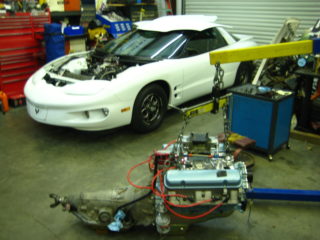

      The car at Pauls shop getting her new transplant.

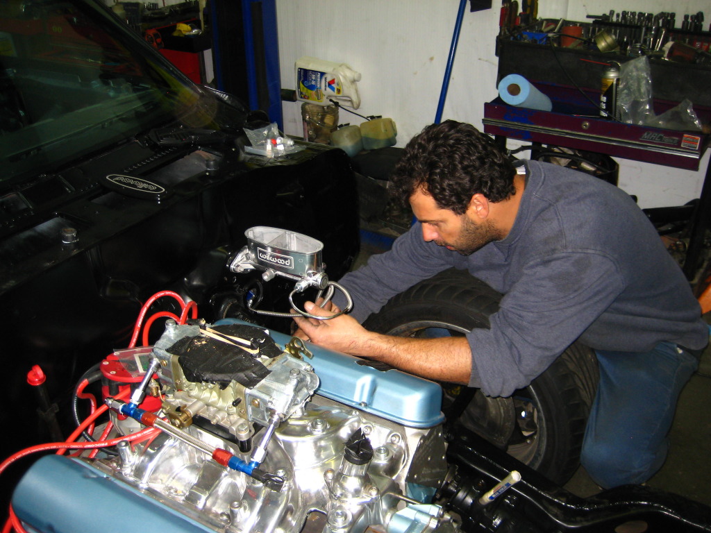

      Paul bending his donated stainless brake lines.

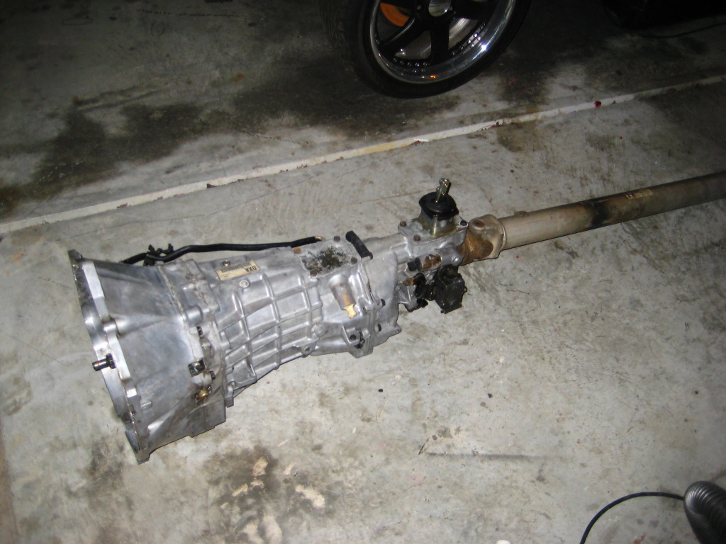

      Yes that's a 200R4 however since this picture was taken we have acquired a t56 6 speed. We still need a clutch, AFW and Tick performance adjustable master.Name:  IMG_0800.jpg

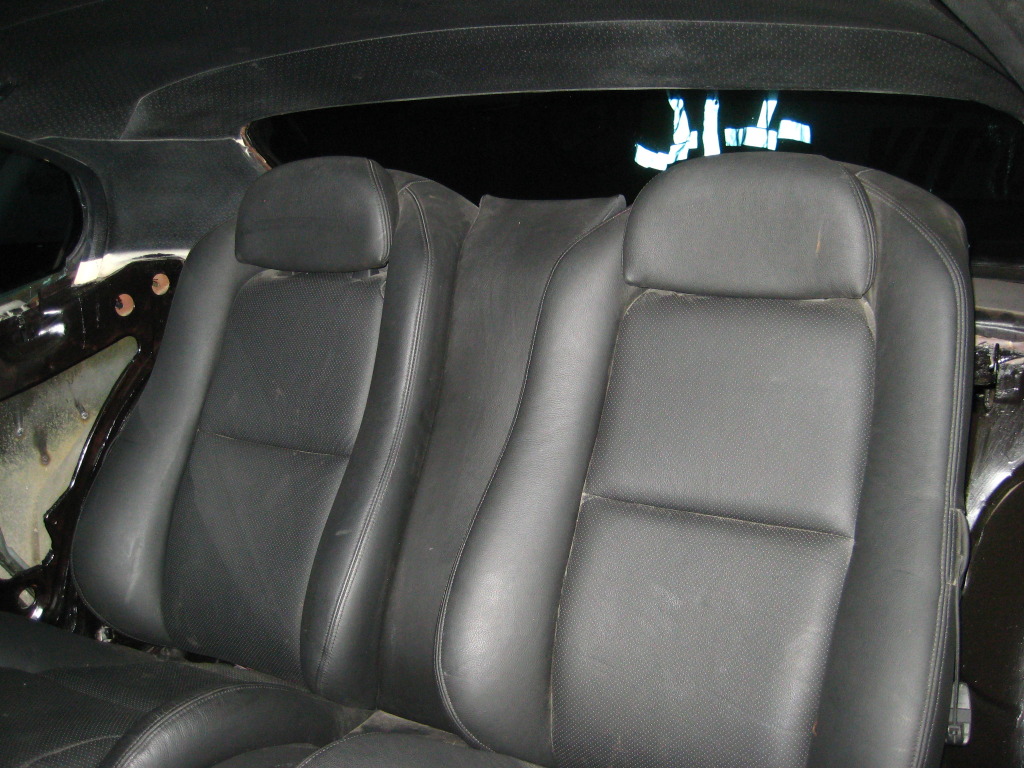

      Stay tuned for our install of black 04 GTO seats. I will try and take more pictures for the next few build updates. The seats do sit high if you just weld a bracket on the bottom. I'm cutting off as much as I can to weld a flat steel bar across the front and L brackets in the rear to keep the height down. Name:  IMG_0795.jpg
Size:  240.7 KBName:  IMG_0798.jpg
      The backs definitely need to be altered but since PT has so many people doing builds and providing information, I have figured out it's easy to customize them down.

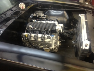

      I found a blown 2010 LS3 and decided to go ahead and pull the trigger knowing it was going to take me some time to finish it. I quickly rebuilt it with CP forged internals minus the crank and used the stock heads with Brian Tooley custom cam and springs.
      I bought twin 61mm turbos to help make some power, and because the intake looked so damn cool and ou don't see many I bought the high rise intake. I'm not sure if it will fit under the hood yet it is very close but If I have to cut a small hole then so be it.
