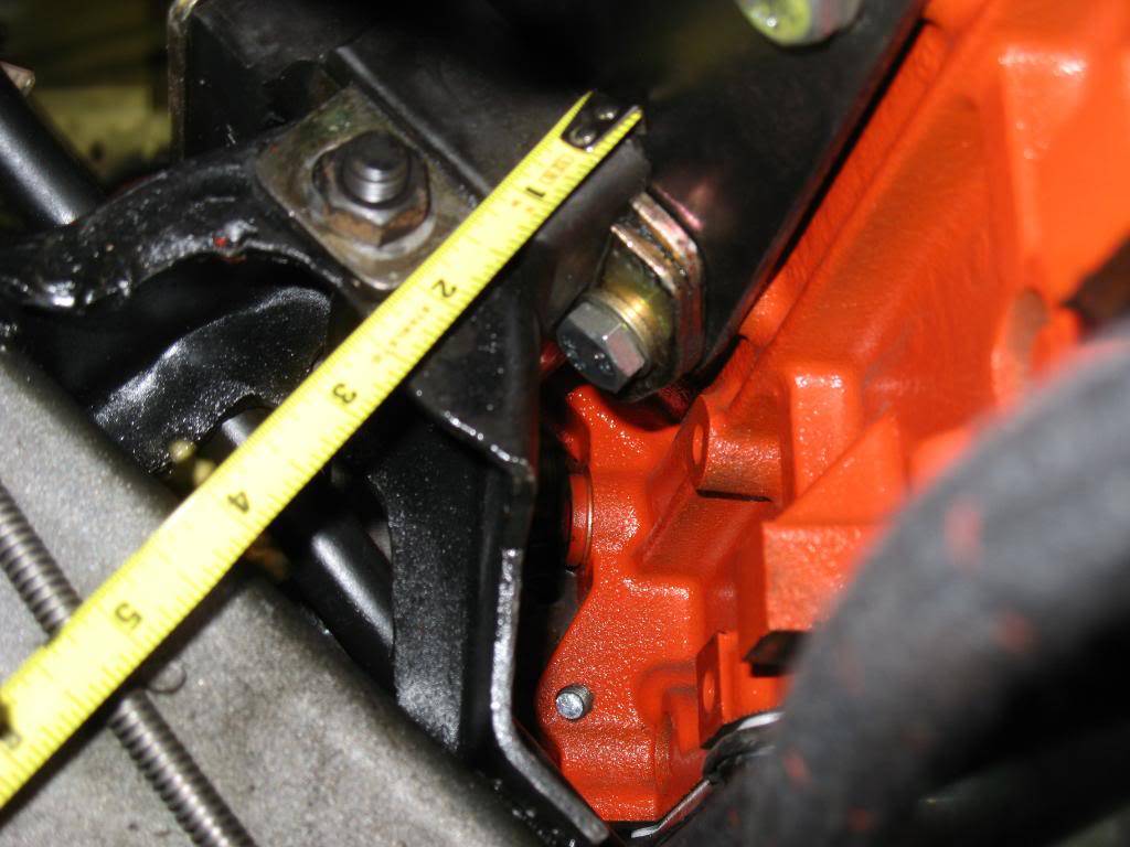

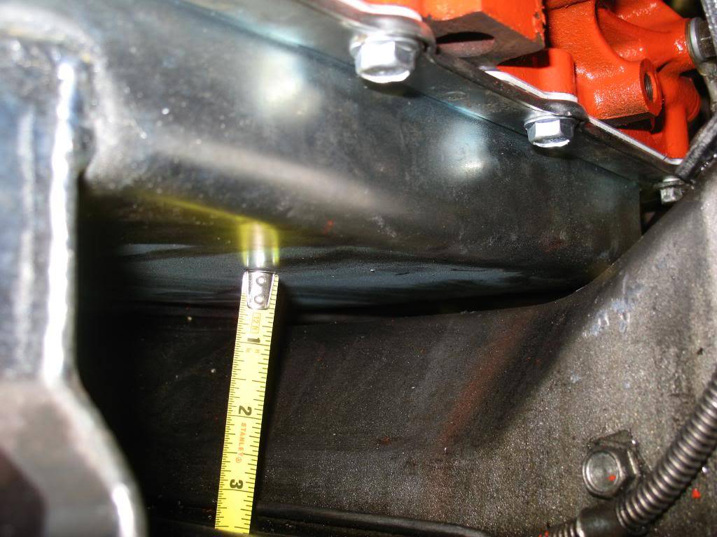

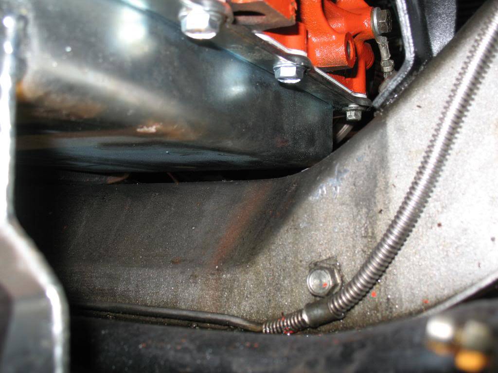

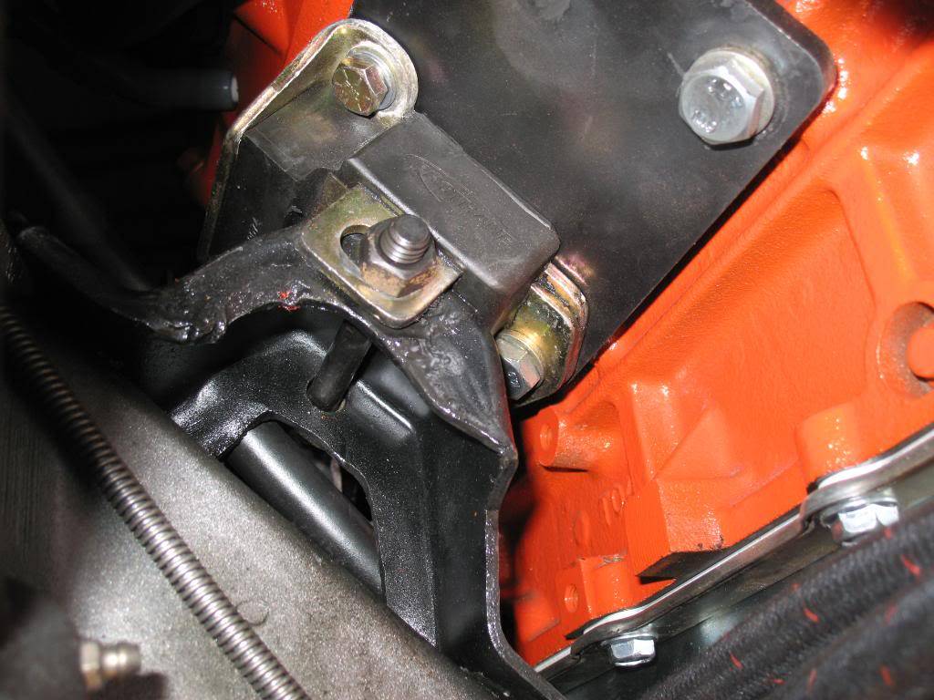

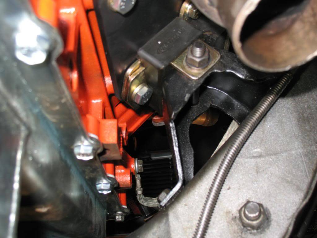

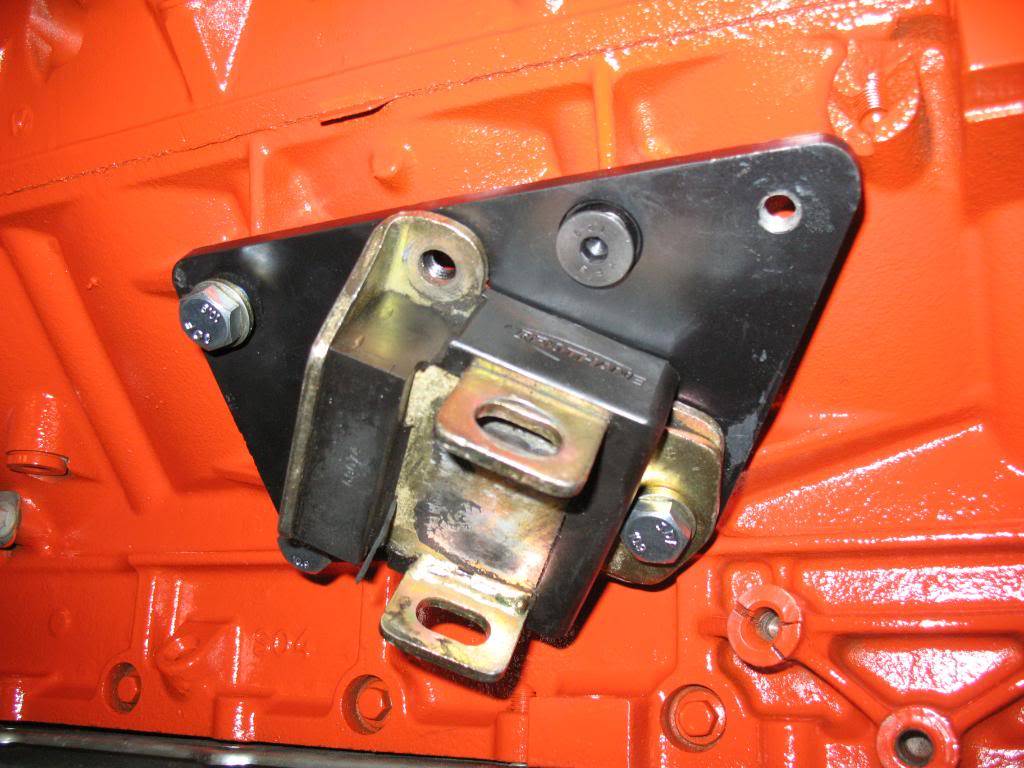

      here's a few pictures of the mounts and the motor installed

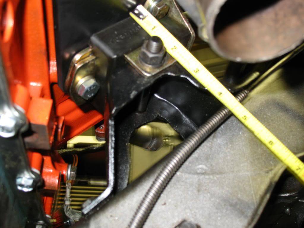

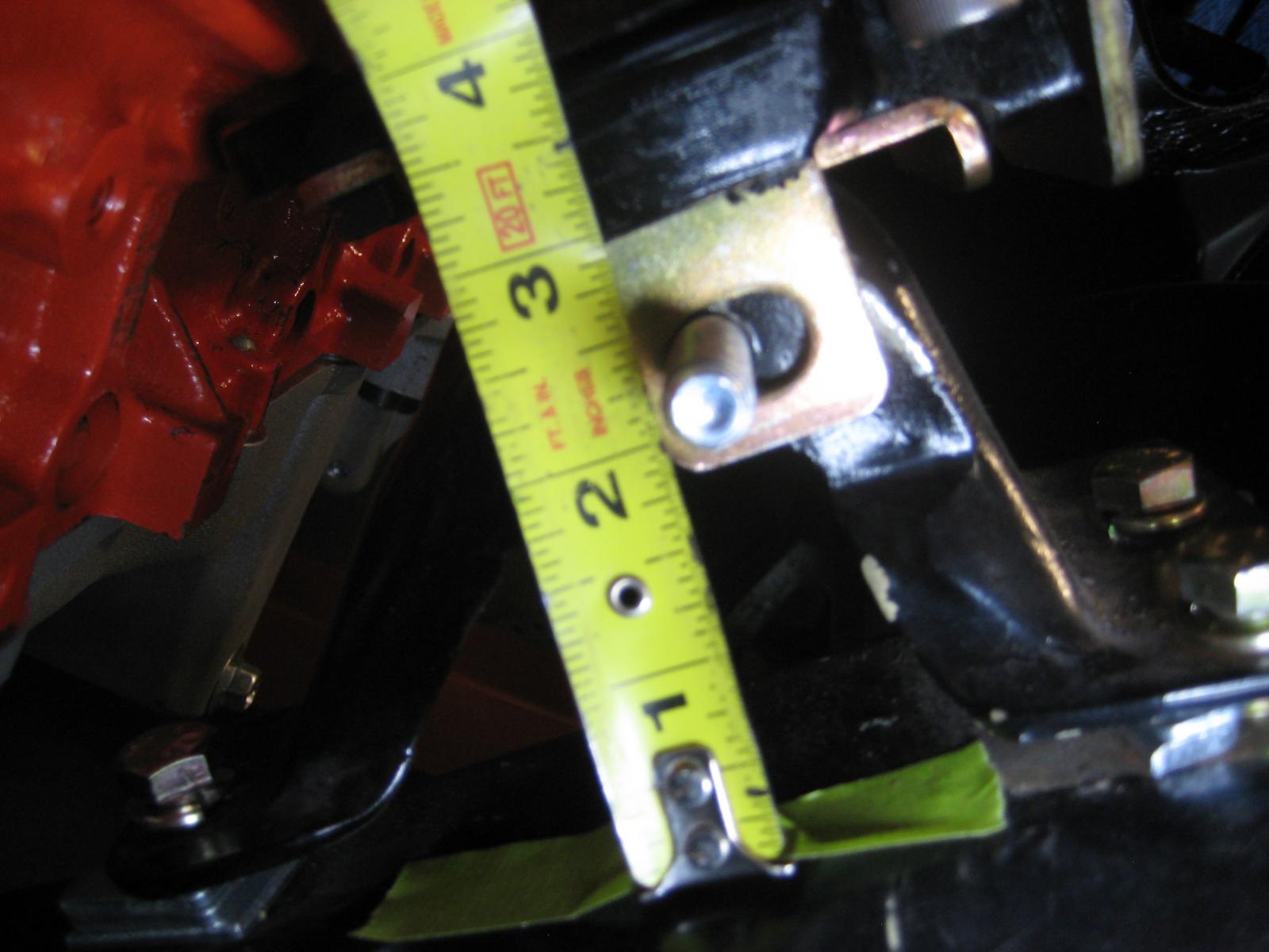

      Got some pics next to a tape, hope this helps a little

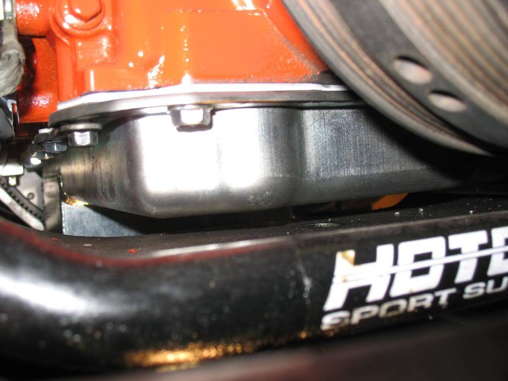

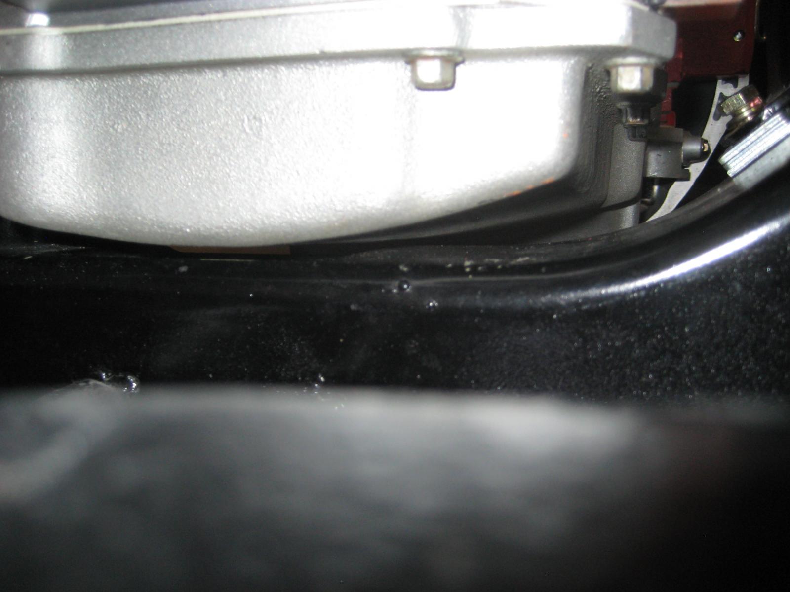

      ok so here are some pics. This weekend I bought some new frame mounts from NPD and confirmed they are exactly the same as what I have. also bought the 302 mounts and confirmed they are not what i need.
      Rod my measurements are the same as yours when measuring from the 3/8 adapter plate to the center of the bolt, however even with the 3/8" worth of shim on the bottom of the frame mount and 3/16" on the top I only get a total of 3-7/8" between the frame and the adapter plate. With the shims in place I have a bit less the 1/4" of clearance in the worst spot between the pan and frame.
      If I go the shim route i will make a shim up and weld it to the bottom of the frame mount but I wanted to post this out there to see if anyone else had some ideas on the best way to fix this issueName:  IMG_4000.jpg

      I would have welded my washers(spacers), but i can't weld. Not wanting to be held up, I just got some new, longer grade 8 bolts & bolted everything together. I'm sure some guys will look down on me for this, but I think it will be ok. Once the car is finished & running, I'll report back if any problems are encountered. Post up some pics when you are finished with yours. I have been meaning to call holley & see what stands are needed for this pan. I wasnt expecting to have this problem. Scott

      Rod - Do you know which stands you have ? Am I reading your pic correct ? it looks like you have about 4.5 inches between the adapter plate and the frame. looks like we are the same ~1.5" from the plate to the main bolt.

      Hey Vince....are your adapter plates the same as Rodneys? and if so are your motor mounts/plates installed the same as Rodneys? If so, you should be able gain aprox. 1/4" " by swapping the adapter plates from side to side....which will force you to rotate them 180* Then the motor mounts will also automatically rotate 180* (1 hole up and 2 holes down ) Should raise the motor up about 1/4"
      Also... it doesnt look like you have the extra steel shim that comes with the motor mounts installed? This would raise your motor some as well.

      I looked at the pictures and the difference I see is the urethane motor mount (mine is 1 1/8" tall) yours is 3/4" tall only, you should end up with
      4-1/2" tall setup, yours is just 3-3/4 inches tall

      Travis, I know I don't have the same mounts as Rodney He has Prothane's and I have Energy. Not sure what plates he has but the look like 3/8 thick and I assume they are neutral position as far as height goes, and no I didn't use the shim in the Energy suspension kit. I was thinking I could get away without using it since it's purpose is a "pre-load plate" which is essentially what the adapter plate is doing. Plus the shim has a small hump which would need to be ground down (which I'm fine with). Thanks for the idea of switching the plate around I will give that a shot tomorrow after work.
      Rodney, I see what you you talking about an I didn't' notice that at first. I'm not sure if that is the ultimate issue since the distance between adapter plate and mount bolts appear to be 1.5"-1.75". It looks like the metal portion of my mount is longer then yours , making up for the shorter urethane portion. Do you happen to know which frame mounts you have (Brand and or Part #)
