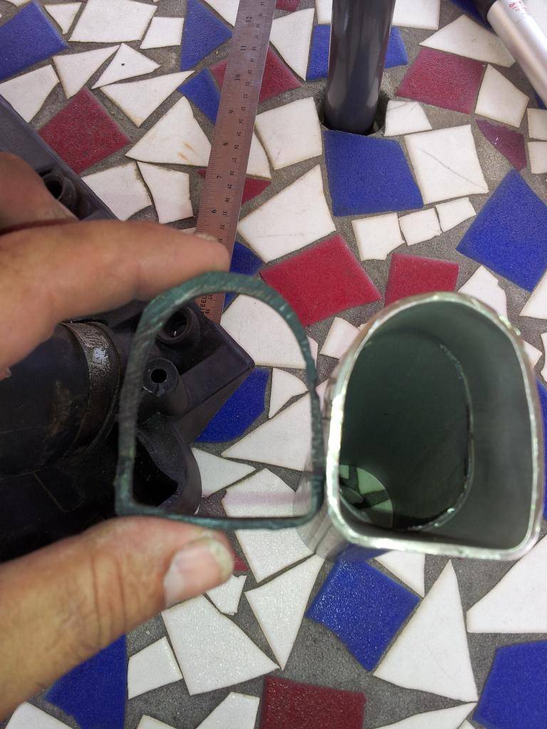

      Took the project back out of the box recently & starting playing with some stainless pipe I had after seeing some actual stainless intakes online. Still in VERY ROUGH mockup, but this sure could look cool to say the least. Black abs pipe is for visual mock up only, real plenums will likely be hand bent thin stainless sheet. LONG way to go here, but I got a small start back on it in what little time I can spare right now. Nevermind the plumbing connectors, I will be looking into nicer 2 3/8" rubber & clamps.

      Put a little more shape into the runners & got them fitting better.
      Working on design, considering a dual plenum on each side for better air distribution. If I do this , may use round tube up top as in mock up & tapered tubes underneath, which will connect back for single throttle body. See link for what dual plenum per side would look like.https://www.google.com/search?hl=en&...ml%3B700%3B525

      Working up a new design to use my stainless bellmouths with an aluminum plenum. Making flanges to connect runners to plenum. Will then weld up bellmouths to runners & eliminate the upper rubber connectors. Will look cleaner, similar to an Ozmo intake.
