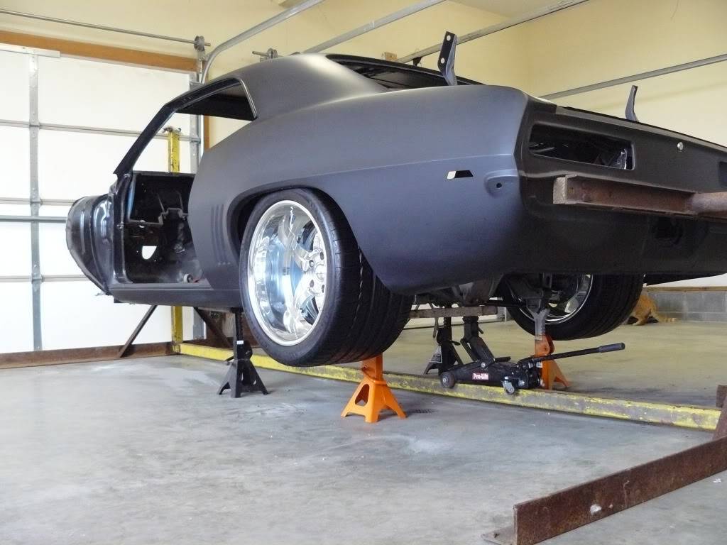

      Wow... that looks mean as hell from the rear.

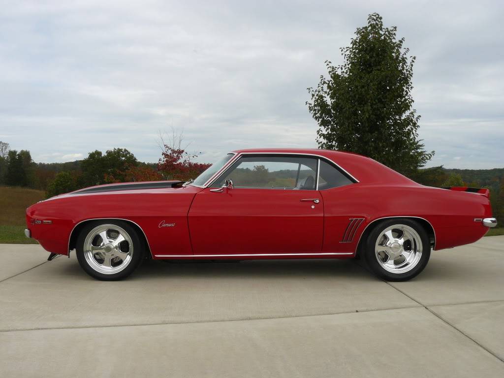

      thanks,really like the minitubs,heres the last car and a coule more pics

      what size are those rear tires?
      May 2010
      WV
      202
      red car has 335/35/17 and new car has 335/30/18

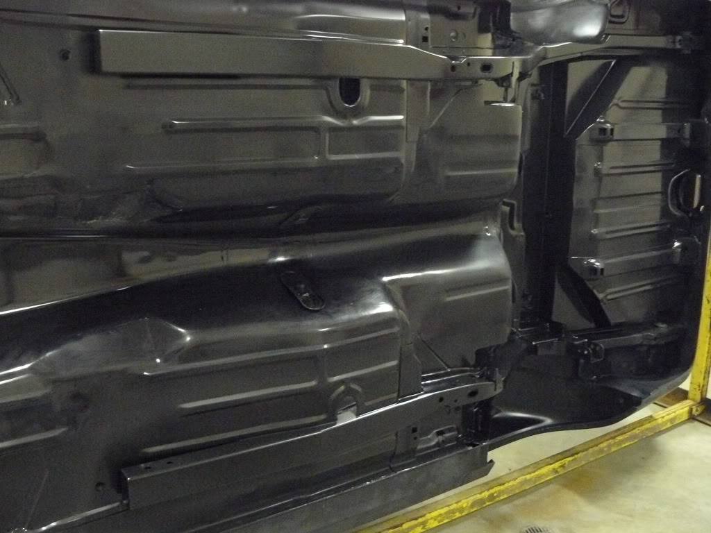

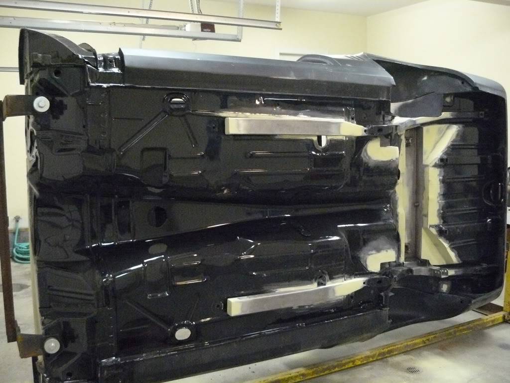

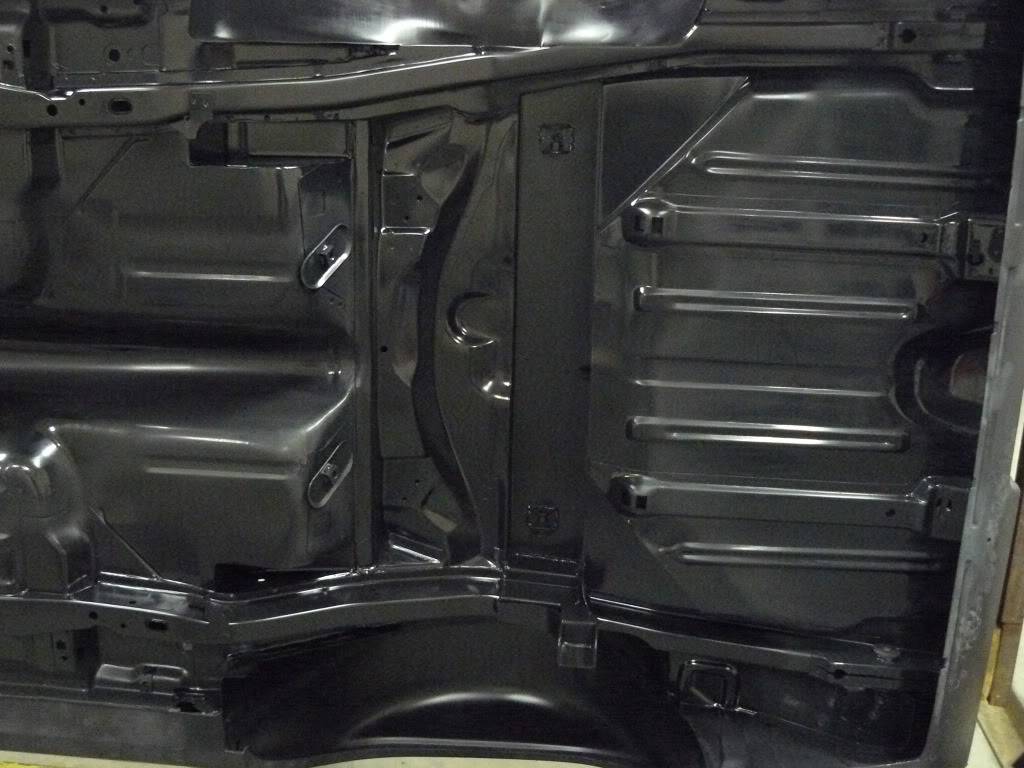

      Got a few more pics,finished working floors,trunk and frame and got them primed for now,will be finished with a base/clear underneath,gonna put car together one more time for final fit and hopefully get RS headlights to fit good.
