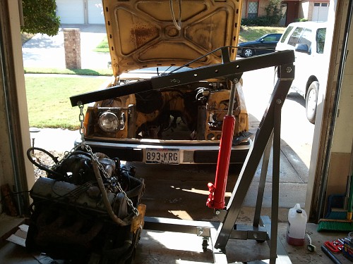

      Even with all this little stuff I had been avoiding the real reason it was off the road, the oil leak. I think if it idled enough than you would have to pour oil in it. The seller had told me this but I was optimistic that I could throw a rear main in and drive it. Unfortunately the clutch was wasted and I didn’t want to put any money in the original engine and transmission so out it came for the engine swap a little early and ahead of schedule.
      Out with the old four cylinder.

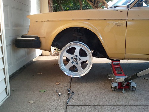

      And shopping Mustang parts on the net picked these new 17x9 SC replicas up for cheap. With the mock up I decided on a redrill for the rear axles and adapters for the front and for tires I went with Falken 235/45 for the front and 255/45 for the rear.

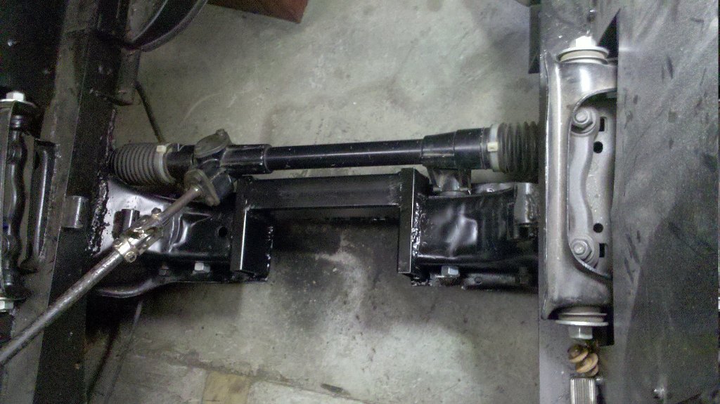

      Totally different car but I had a similar cross member in the way problem... I also initially notched it. I then had to go to a bit of a more severe clearance strategy. It worked well and all fits nicely now without having to customize the oil pan/pick-up.

      Originally I wanted a DTM style/touring car build but the body is just too nice to cut up. Here is a pic of ET-3 in the back, again, too much cutting just to keep it from rubbing, these have small wheel openings and the body rolls under dramatically.
