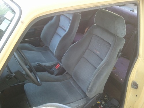

      Picked up a pair of Recaro seats from a Volkswagen GTI to replace the ultra-worn original seats along with front strut bags and rear convoluted bags.
