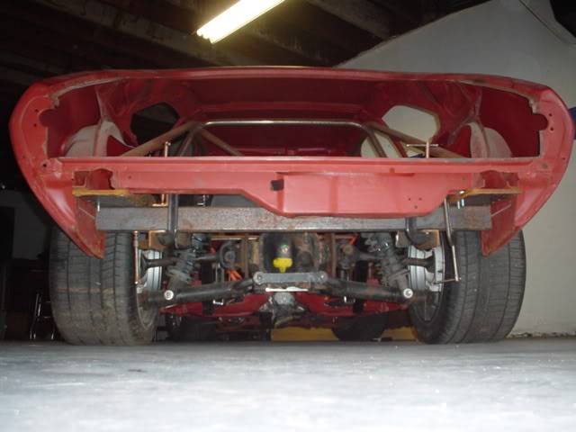

      Is the 350Z rear strong enough as is? Makes me question why this guy went to so much trouble (unless just for the quick gear change capability).
      THAT is just weird... The quick change is FAR from the best choice for shock load. Maybe it was the only "big" housing that would fit...or he's going to Bonneville.

      ya, no reason he would need to swap the center. judging by the cage though, it's definately going to have a "special" purpose. the rear links i can see are stock. rear floor pan and rear panel all cut out also.
      i ran mine constantly at 550rwhp and 305 rears and it never had probs. look up vids on youtube. guys were running 8's on them with just upgraded axles and drag coilovers. never heard of anything break other than an axle. but those were guys who side stepped the clutch, and stock axles.
