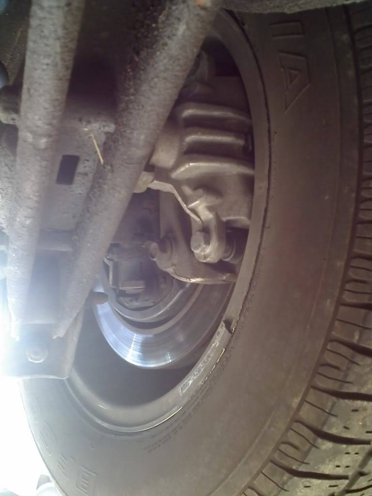

      I installed the LS1 rear brakes on my 84 and they cleared the frame but just barely. Once installed we removed the rear springs and jacked up the rear until it bottomed out just to see what hits. The suspension hits the bumpstops about an inch before the caliper would hit the frame so I would imagine that if the car had soft rear springs then the calipers would hit the frame during hard cornering. I chose to install new stock cargo springs in the rear and have not hit yet but I can see where the bumpstops have contacted the frame so I know I am close. With that in mind any of the "lowered" guys I spoke to have had to notch the frame to install rear disks and make clearance for the calipers. You can see in the pic below just how far in-board the caliper comes ( regardless of the setup used ). There really just isnt much room there. Clocking the caliper to the rear of the car ( instead of the front like mine ) helps a little but then you run interference with the shock mount

      Clock the calipers to the rear and then relocate the shocks seems to be what many guys do, others choose to notch the frame or some combination thereof. As stated above, there really isn't much room on those applications, so short of running a wider axle (flange to flange) and more backspacing on your wheels, there isn't any other way to push the brakes out any.

      Pull up my Project Grocery Getter build thread; I used LS1 brakes on it, and mounted the calipers at the rear. All I had to do was re-drill the shock mount slightly inboard, and there was enough clearance. That was with an 8.5 10 bolt.
